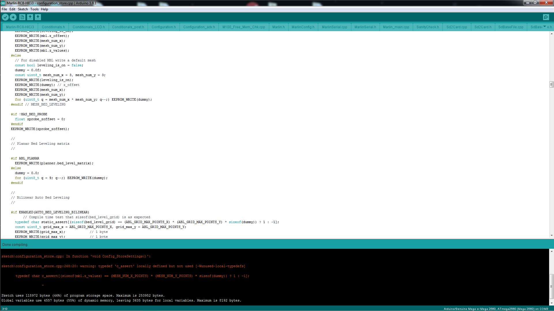

I have successfully compiled shockofmighty version of Hic firmware Marlin-RC8BF-HICi3.
Question to see if I understand the firmware.
Line 268 and 310 of configuration_store.cpp, if I understand Microsoft's description c_assert is a test for assertions at compile time.
So the errors during compiling in these lines I can either ignore or delete the lines. I chose to delete the lines is this a correct assumption on my part.

Roberts_Clif wrote:I have successfully compiled shockofmighty version of Hic firmware Marlin-RC8BF-HICi3.
Never ran into these issues. I've been compiling with arduino-1.8.0.
Posts: 1493
Re: HIC i3 - current firmware development information
Attached is a Print screen, Compiled with arduino-1.8.1.
If locally defined but not used can I delete line

Roberts_Clif wrote:Attached is a Print screen, Compiled with arduino-1.8.1.
Just tried with 1.8.2 and did not see this error. Must by OS specific (I'm using linux).
Today I decided to completely Install Ubuntu 16.04 LTS, added Arduino-1.8.1.
Copied my Marlin files unto Ubuntu and began to test could not duplicate problem.
Loaded a unmodified Marlin reconfigured with my settings could not duplicate problem.
Went back to original files with errors could not duplicate problem ??????????????????????
Thank you for the help shocksofmighty
