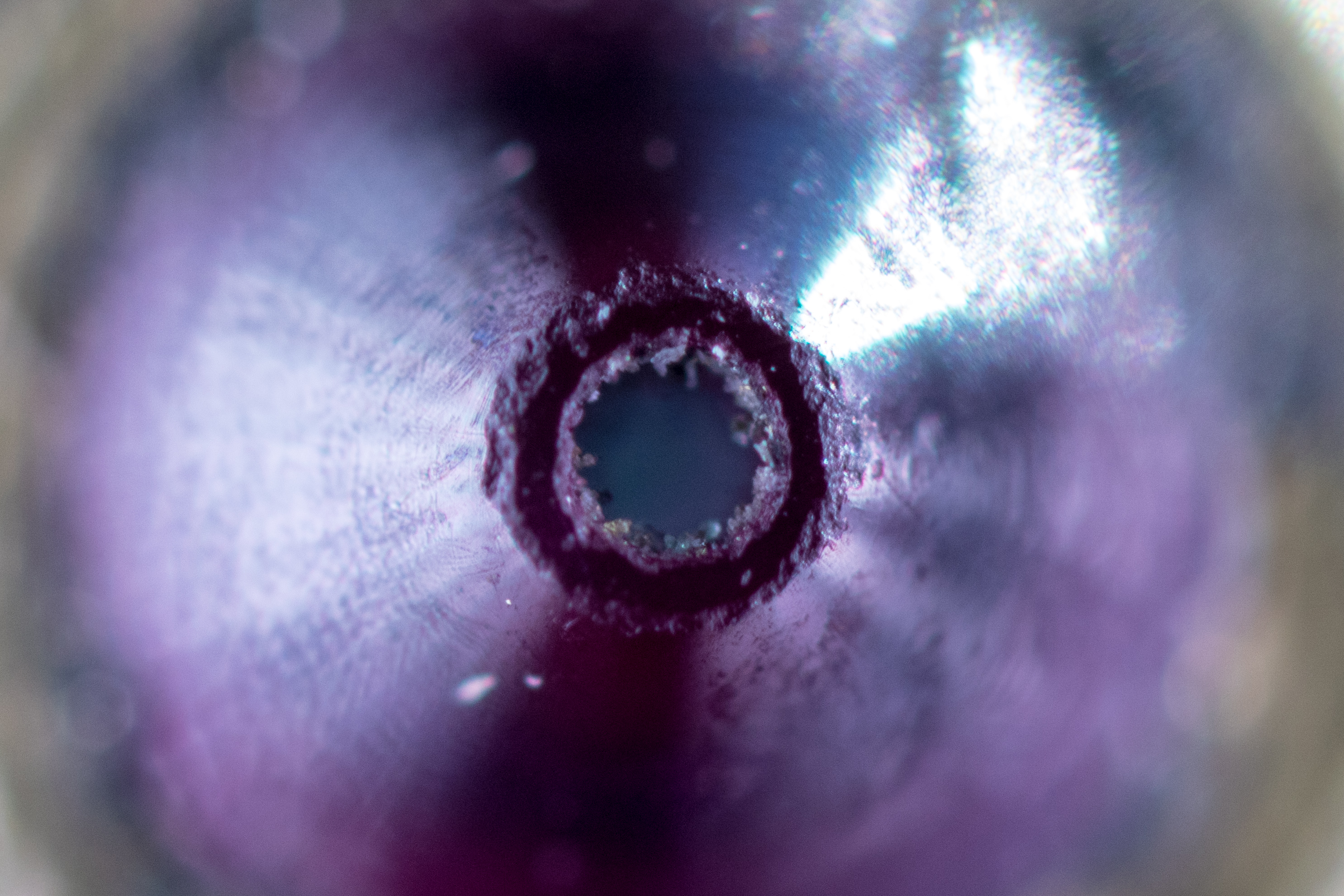

Sorry I'm a bit late, lots of stuffs that need taking care of.
Managed to make a picture of the nozzle. This is after about 7 hours CF and 3 hours PLA:
