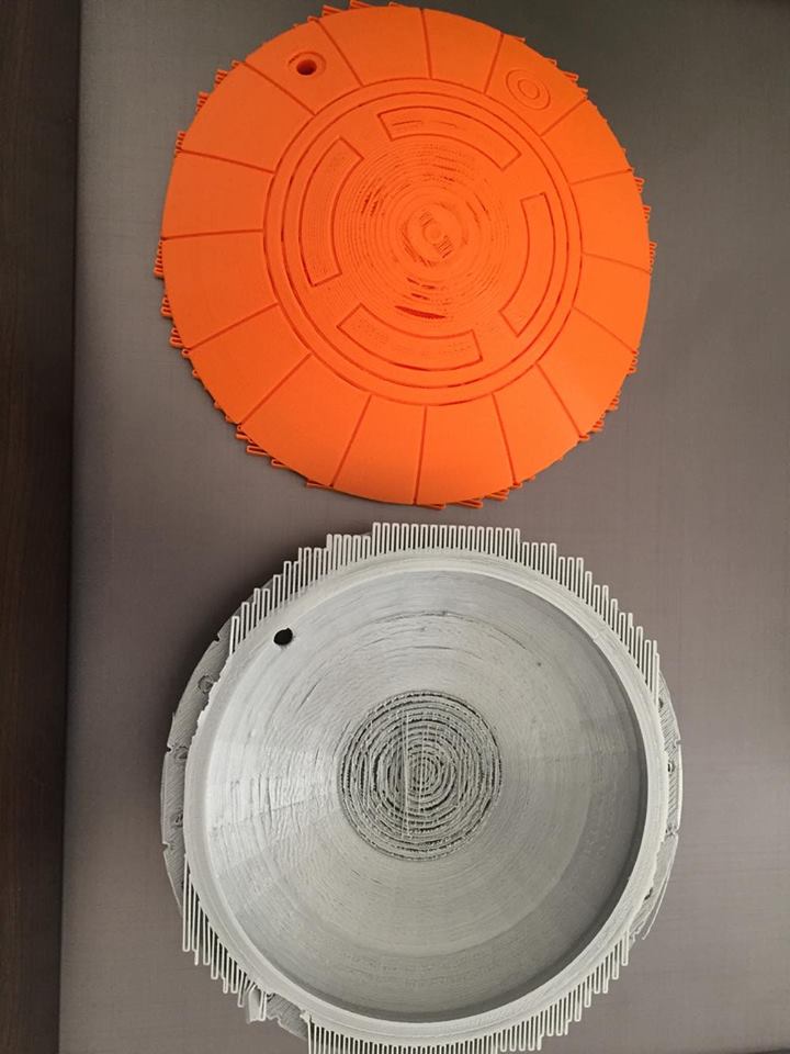

I did a piece that the supports were pretty hard to reach after
I was looking at this...
https://www.simplify3d.com/support/arti ... tructures/
And I see the Horizontal Offset From Part
Default is 0.5
In previewing, I didn't see much change from that to 4.0 mm.
In this print, where I already removed the support under the dome (it fell out! Love!)...those edges are a bear to clean up
(Yes, supposed to look this way since it only has 2 shells)

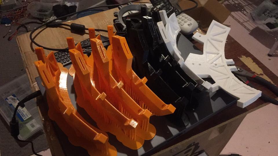

With some settings tune up, is quite easy...
Ofc, it takes time and material to learn.
https://twitter.com/neotko/status/849298464018227200
