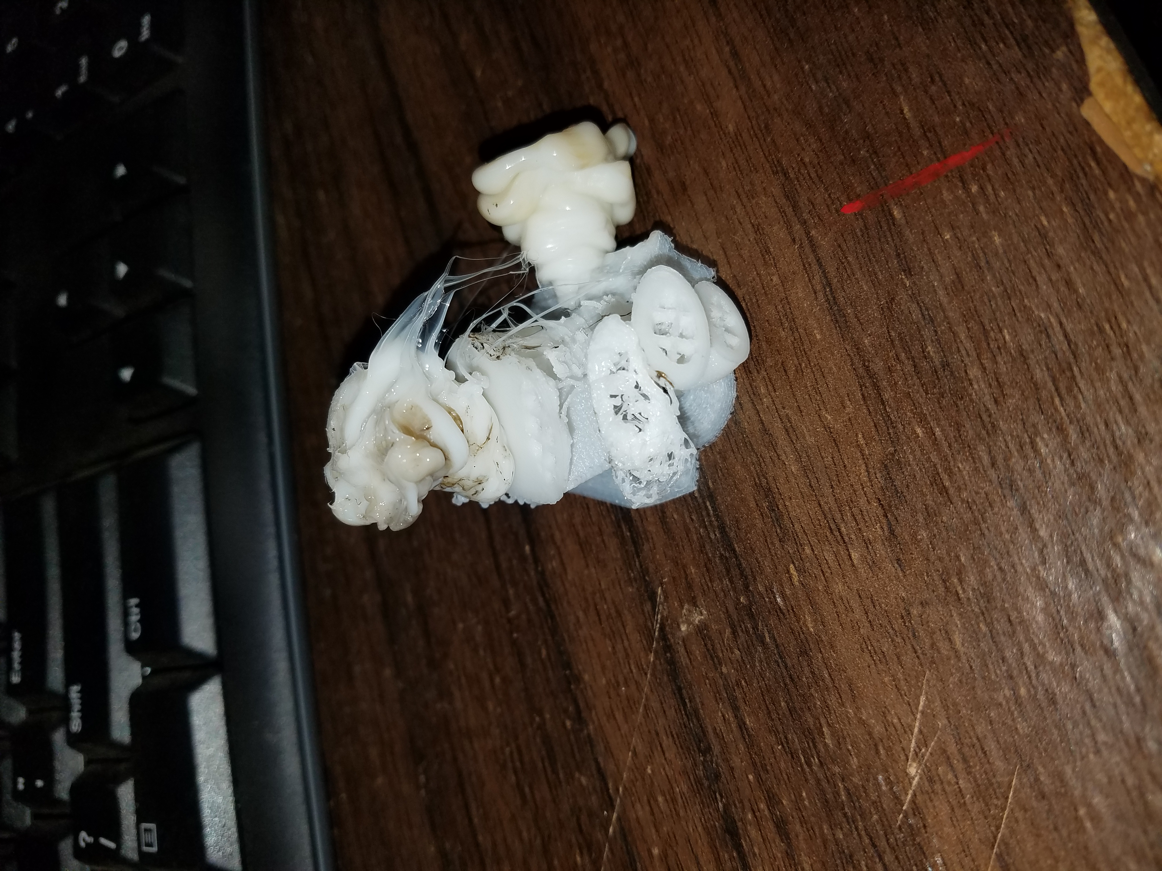

Started a print Wed night (~3cm^3 tooth), woke up Thursday to a white PLA blob below the print head and the head completely encased in PLA (see photo). Quickly disassembled the print head assembly from the main carriage and put it in a mason jar with enough acetone to cover it (was able to remove the thermistor and heating element first), then headed off to work.

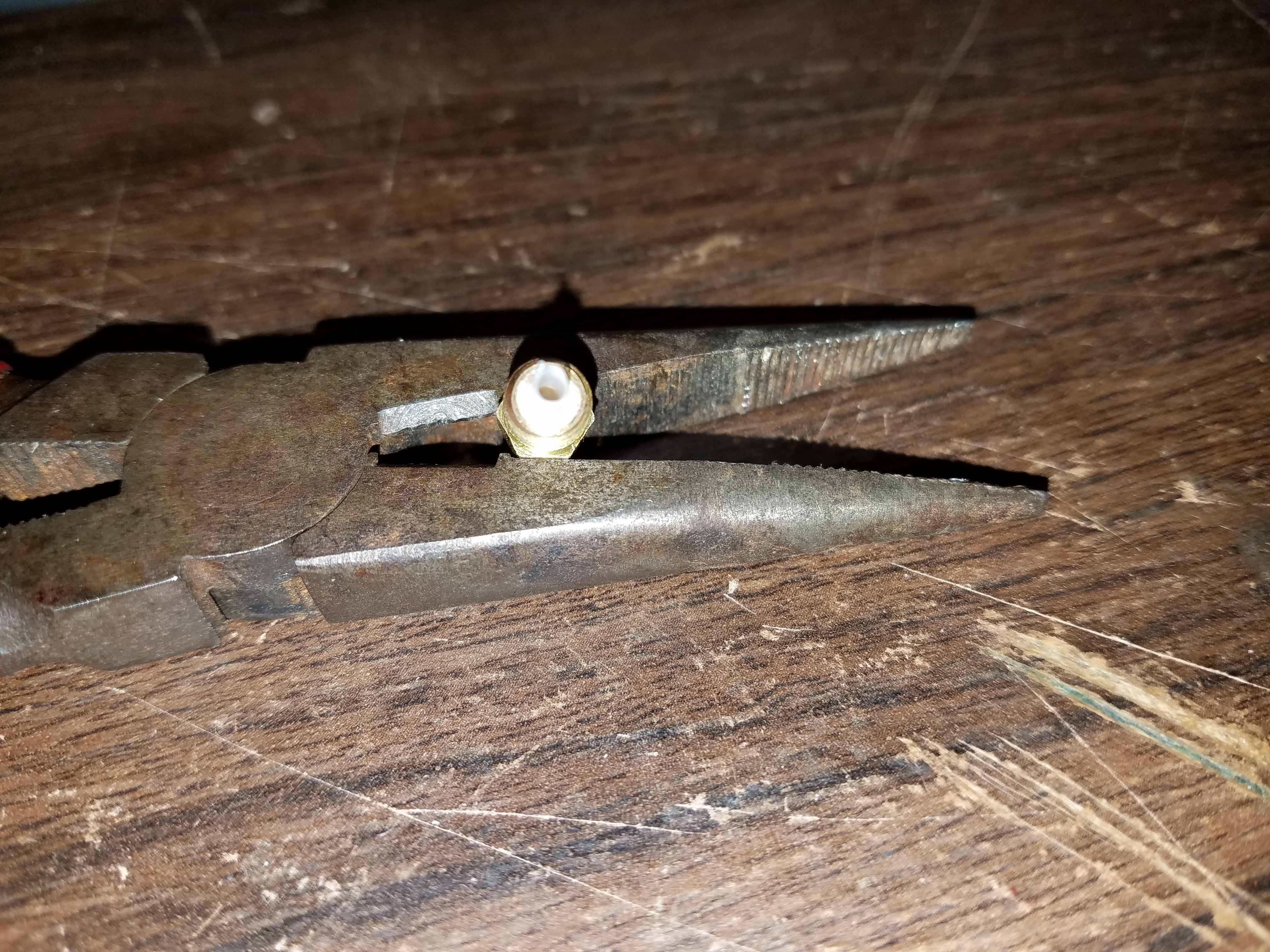

Came home after a very long day, started cleaning the mess off the extruder. Discovered that the extruder tip was still very clogged and the throat was charred. Good thing I ordered a 5 pack of each. Reassembled the extruder and throat to the heater block, went to assemble the heater and thermistor, shattered the thermistor with the set screw.

Haven't had this happen on my Hictop, but it has happened plenty of times on my FFCP. Instead of removing the print head, just heat it up manually and slowly pry away the excess PLA. Because it heats locally around the hotend first you can usually pull it off in a single piece. Also, acetone will soften PLA but won't dissolve it. If you want to dissolve PLA use chloroform.

If only it was that simple. By encased, I mean it looked like I was looking at a block of ice. I know about acetone vs chloroform, I just don't know where to get chloroform where I live. Amazon, I guess.

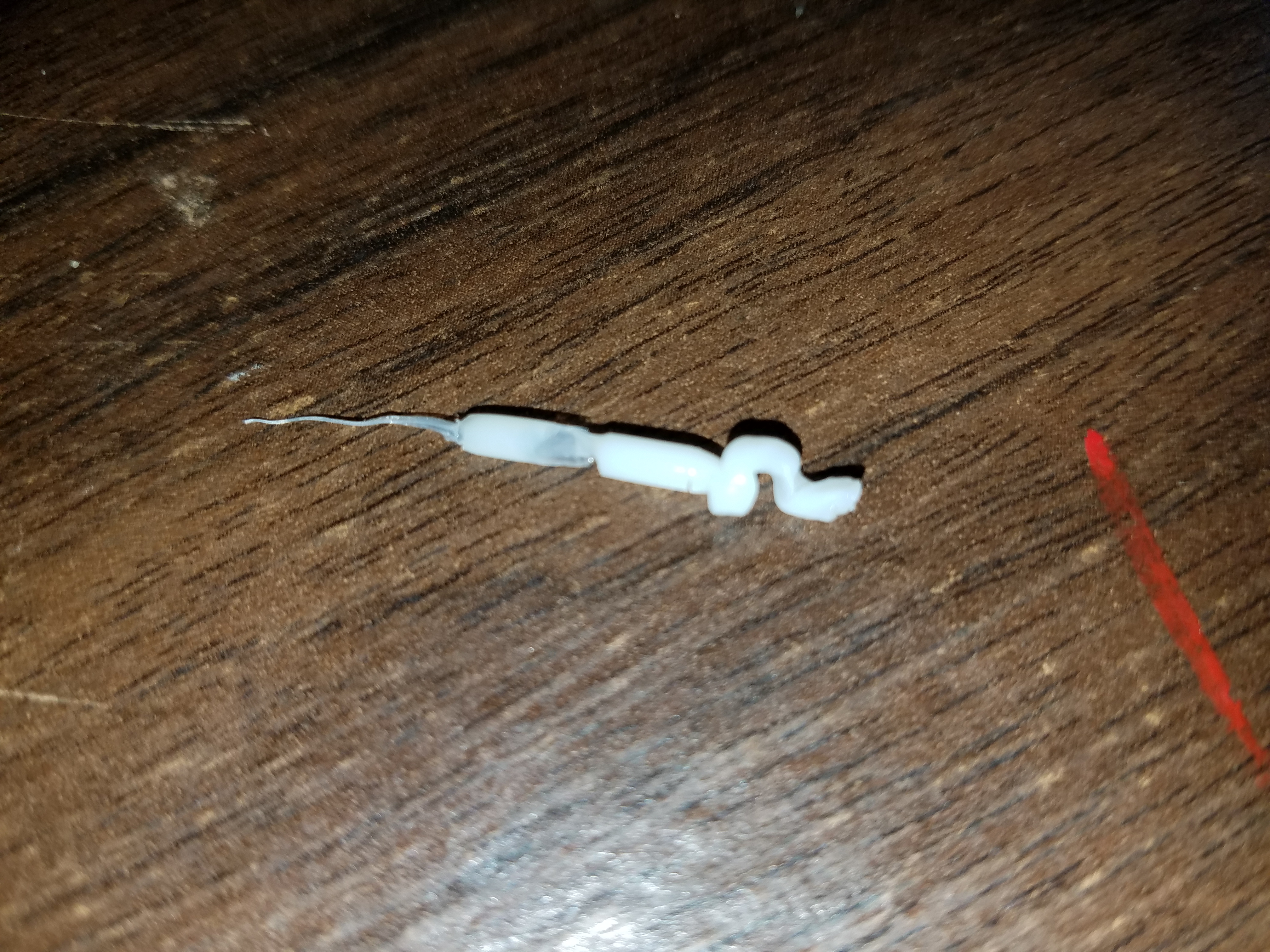

Update: Here is what the filament looks like after disassembling the throat. This was pushed hard against the Teflon sleeve.

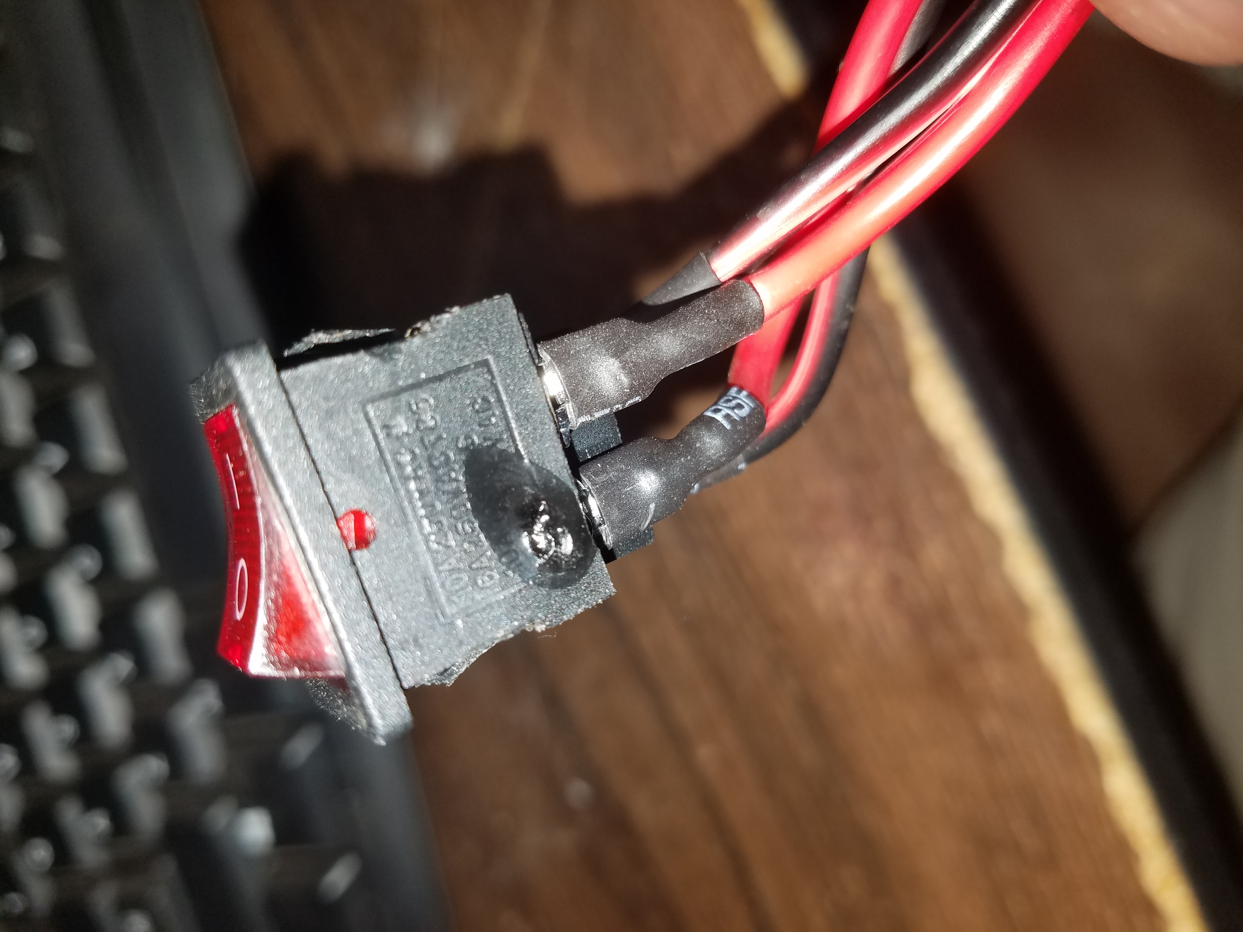

Well, ~12 decent prints later, and now my system is dead. I smelled hot electronics ~3 hours into a 14 hour print, ran into the room the printer is in, and it went lifeless except for the LCD a few seconds later. The hot end reported a temp of 216C (I had it set for 205C for PLA). Cura was showing an error from he printer, and the power supply had gone into standby. I quickly unplugged everything, then did a smell check to pin point the area. Control board chassis.
I spun the printer 180 and removed the cover to find the power switch had gone slightly molten. Being the hacker/tinkerer type (and since it was Easter Sunday), I went to an autoparts store, bought some 14 guage wire, found a replacement switch, along with an inline fuse holder, and did some rewiring. I tested the power supply output to make sure it was good and the wiring was sound (all connections soldered with heatshrink tubing), and connected to the controller. Nothing. Board wouldn't power up, just flickered an LED and the LCD flashed. Tested the power, 3.5V coming in. I powered down, removed the power leads and checked the PS again, still 24V. When connected to the controller, low power. I'm thinking the VRM went out as well. So now I am down again. Sent an email to Hictop, time to test the one part no one wants to test; warranty service.
Sigh.
Sigh.

Added Heat-sinks and insulators to anything I felt was getting hot.GrueMaster wrote:Well, ~12 decent prints later, and now my system is dead. I smelled hot electronics ~3 hours into a 14 hour print, ran into the room the printer is in, and it went lifeless except for the LCD a few seconds later. The hot end reported a temp of 216C (I had it set for 205C for PLA). Cura was showing an error from he printer, and the power supply had gone into standby. I quickly unplugged everything, then did a smell check to pin point the area. Control board chassis.
I spun the printer 180 and removed the cover to find the power switch had gone slightly molten. printer switch.jpg
Sigh.
No guarantee this will stop a meltdown, It gave me more assurance not having a meltdown.
Like the old saying where there is smoke there is fire.

That switch should be installed on the input to the power supply(120VAC). It will see way less than 10 amps at full power supply output.

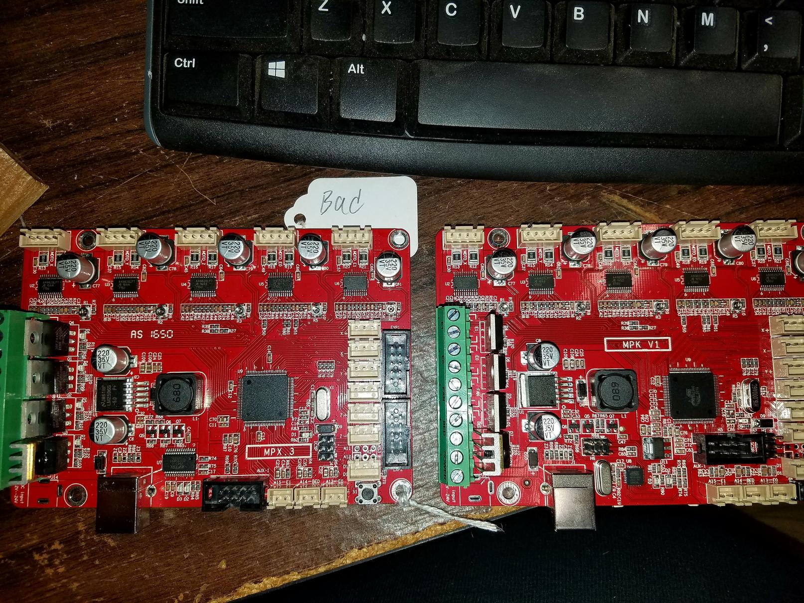

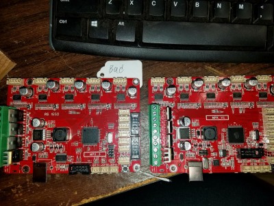

Well, this week has been fun (not). Backup board (from Amazon) came Wednesday. I removed the original board and just applied power to the new board. Nothing. Thought the PS had blown. Tested the PS, 24v at the PS when the switch was off. Switch on, 5v at the board. So, I ordered a new PS. It arrived today. Wired it up, same issue. Did a few more checks, then went to eat (and sulk). Just came back to it and checked my wiring. I have the power to the switch going to one of the two outer connectors, and the center going to the board. Switch is lit by an LED.
For those of you that are familiar with DC electronics, you can understand and appreciate my facepalm moment here.
Essentially, the LED (Light Emitting Diode) is polarity sensitive. Wires backward, low power.
I clipped the PS from the switch and (still through the fuse holder) went directly to the board (using the switch on my power strip to control everything). Works! Swapped power supplies and (yea, you know)...
This is why I do mostly software.

When you realize that Reprap electronics are made by people with no understanding of electronics whatsoever...rcabor wrote:That switch should be installed on the input to the power supply(120VAC). It will see way less than 10 amps at full power supply output.
/edit:
Just to clarify:
That switch has a 10A AC rating (no need to see exact model, they all have an AC rating because these are AC power switches...). That is nowhere near a 10A DC rating, especially not at 24 V DC. Every time you flip that switch, there is a nice spark that burns the contacts and increases their electrical resistance a bit. And every time you flip it, it will get a little hotter because of that growing resistance...
/edit2:
Just solder the wires together with no switch. If you need one, you can put it into the AC power cable. If you're not comfortable messing with AC mains stuff, just get some cable / extension that already has a switch.

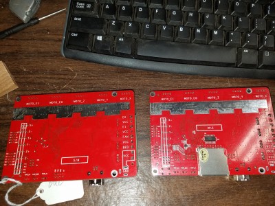

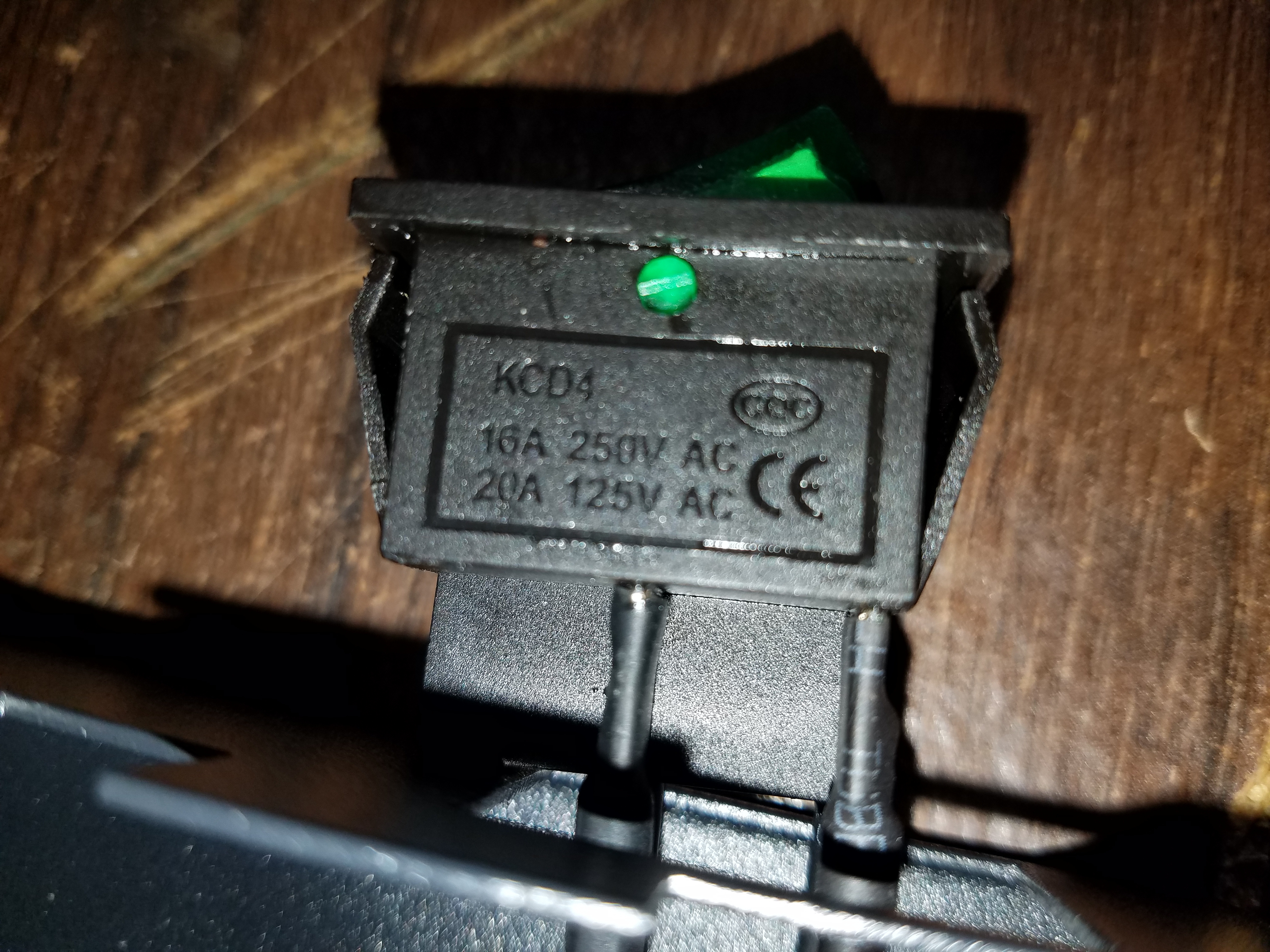

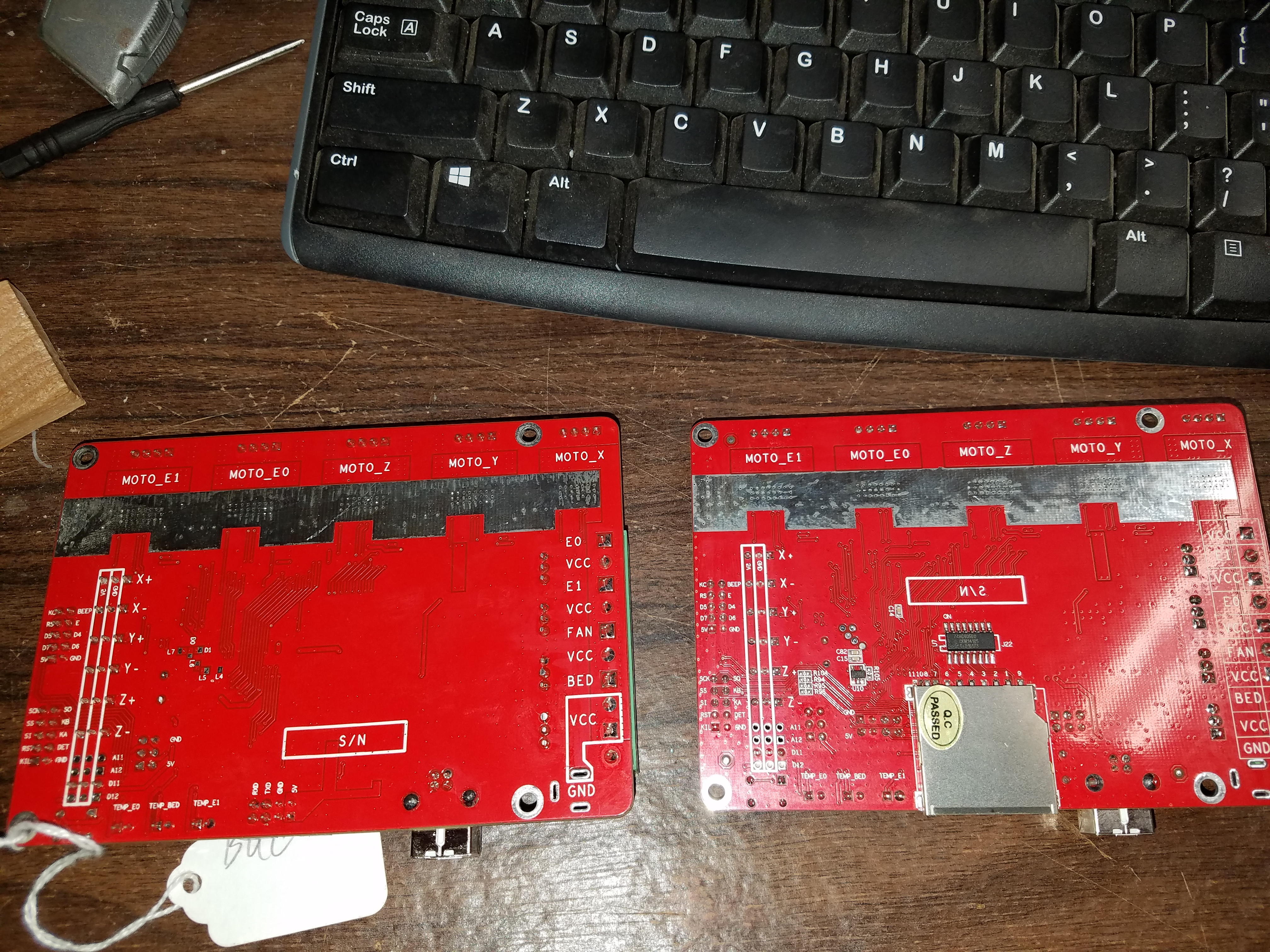

So, replacement board and switch finally arrived. The board is identical to the board I bought last week off Amazon, but different than the original. Either I was given a replacement from old stock, or this is a new rev. The key difference is the SD card slot on the bottom of the control board next to the USB port. It is marked MPK V1. The original is MPX .3. People with systems over a year old may know the difference. I'm guessing that it is from old stock.
The replacement switch is much bigger and beefier. Still an AC switch, but now rated 16A 250v or 20A 125V. Will look up the specs online shortly. I am concerned that they are using an AC switch for DC application. My Principle Engineer said that isn't good (at least on the original switch).
