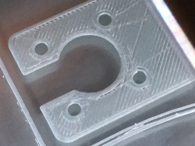

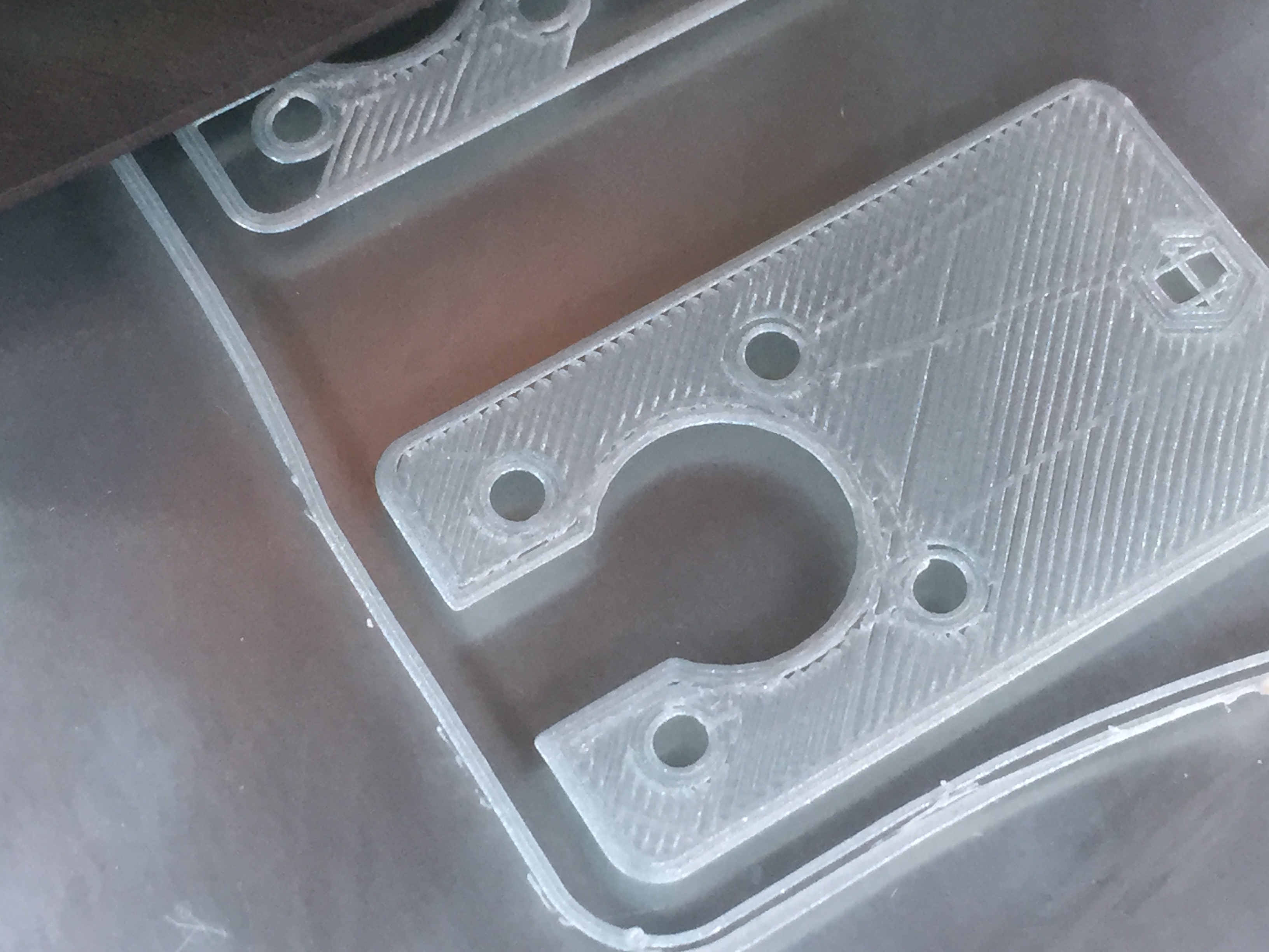

Was running Cura 2.3.1
Ruby nozzle
Ultimaker PLA

Re: First layer infill
Post by Neotko » March 9th, 2017, 4:04 pm
What's the issue?
Post by Neotko » March 9th, 2017, 4:05 pm
Oh I see, that bed needs leveling.
Post by Neotko » March 9th, 2017, 5:17 pm
Then bowden angle + filament pressure making the extrusion harder in that area. Anyhow I think is a level issue. Or, many other things XD. Welcome to 3D printing where 1 think can be many.

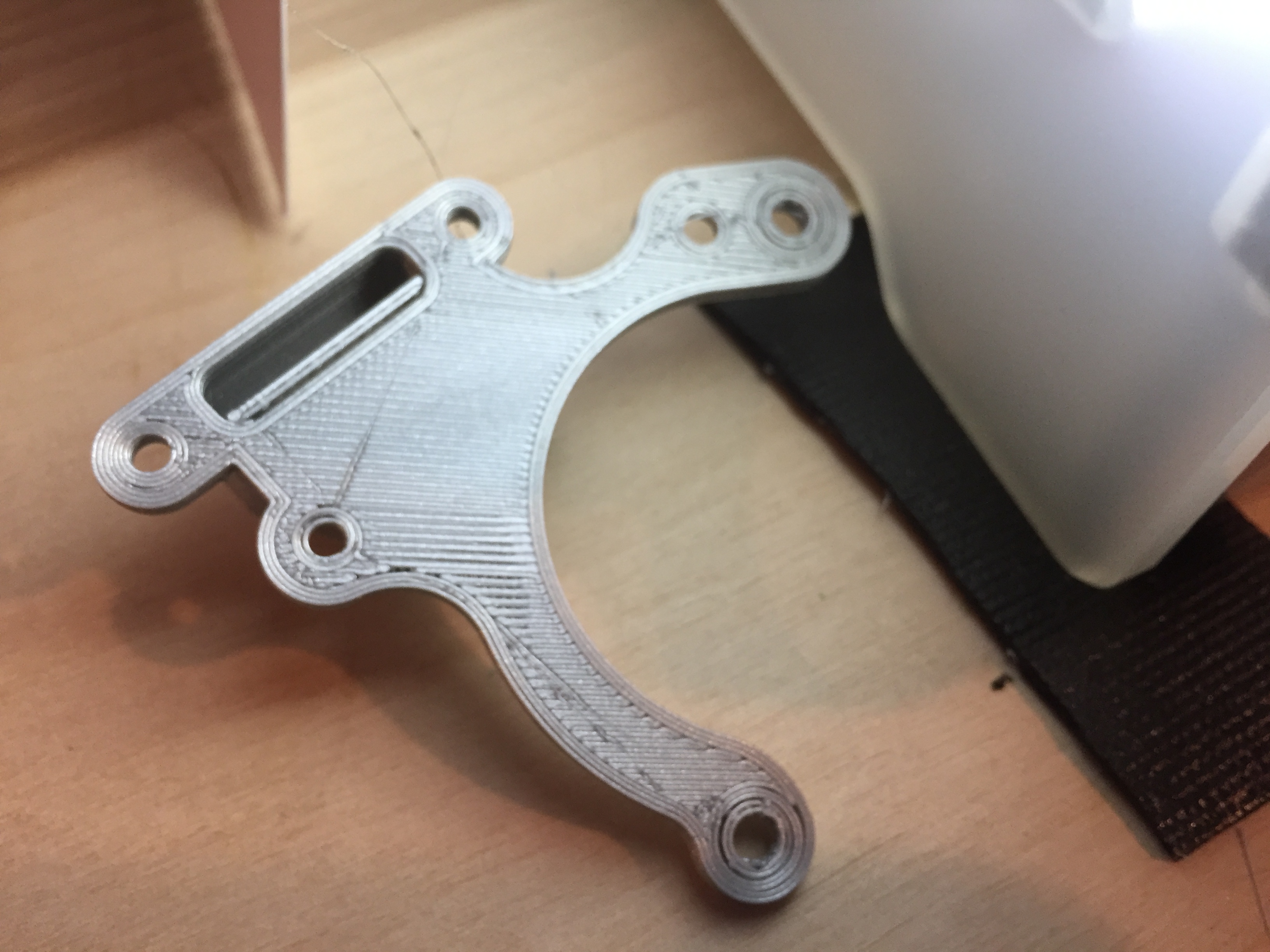

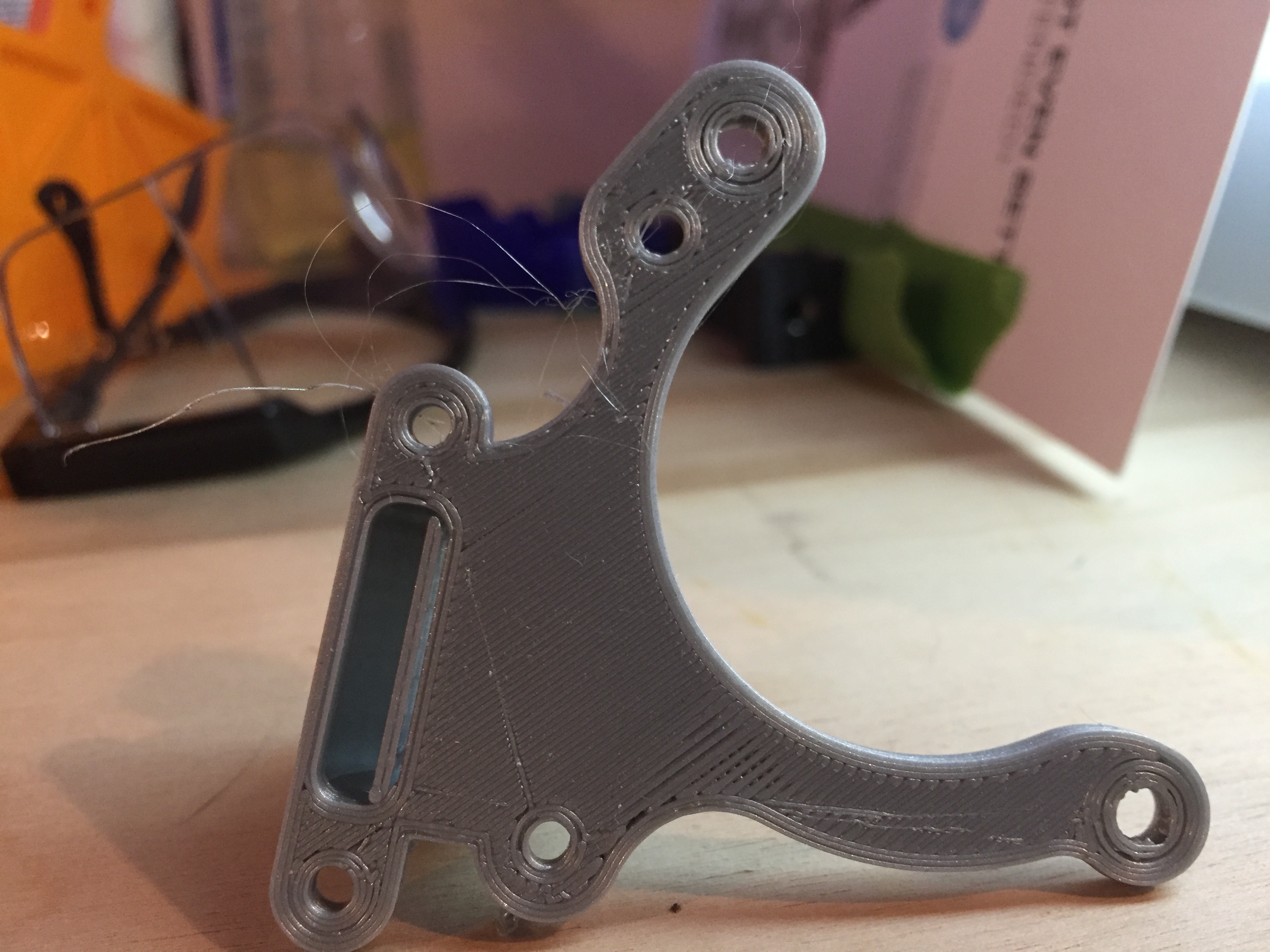

Posts: 3329
Post by LePaul » March 9th, 2017, 8:18 pm
Well it did this print very nicely
But now on the first layer of a bracket piece you can see the gap
Post by Neotko » March 10th, 2017, 2:14 am
Well, the circles don't look good. Maybe the short belts. Also next time start with 'this is on the old umo with mxl belt/pulleys that suck legendarily' :D!
Post by Neotko » March 10th, 2017, 5:21 pm
Well, sorry if that's wasn't the kind of help you where looking for. But, as much as I would love to, there's nothing we can do to fix UM crappy pulley quality. And UMO is well know (on the forums at least) for having really really bad pulleys.
Since you passed the 200h print, (a year ago or so when you finally changed your coupler for the first time) now you are looking more and more into the print, and to get quality the machine must work with precision, and every single detail affects that. Even a 0.3mm off square affects the print, and short belts are one of the most important thing to have perfect, any backlash there affects big time the quality, but I think here and on the other forum I have talk way too much about what a horrible quality the mxl offers, so it surprised me that you didn't saw that.
