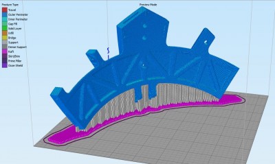

Default Ultimaker 2+ settings in S3D
Raft layer is so sloooooooow

Raft is a fixed thing on s3d. It creates a series of layers with very high Z extrusion to create an almost 1mm base to compensate for bed errors. Click on 'disable something first layers' and the speed and settings are more easy to adjust. But the way raft is made doesn't allow toom for much adjustments.
Also, why raft? Raft is only good for um3 nylon+pva

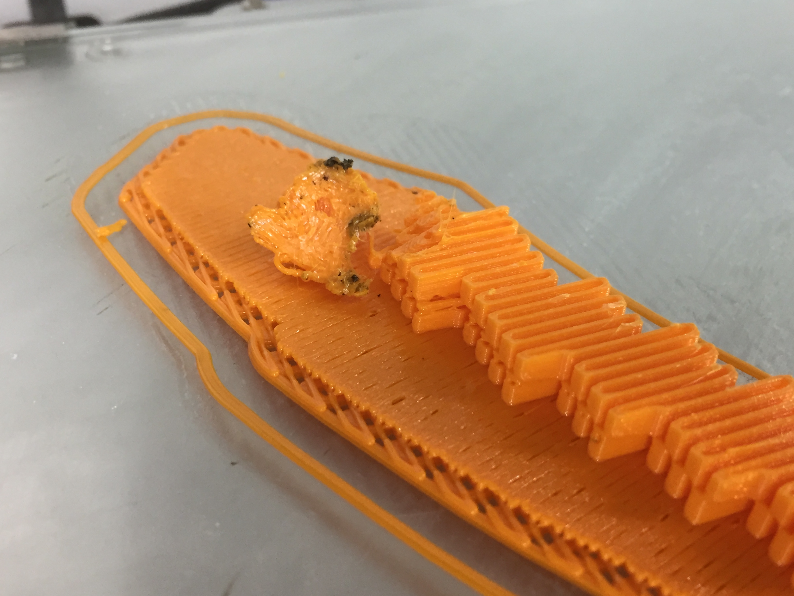

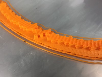

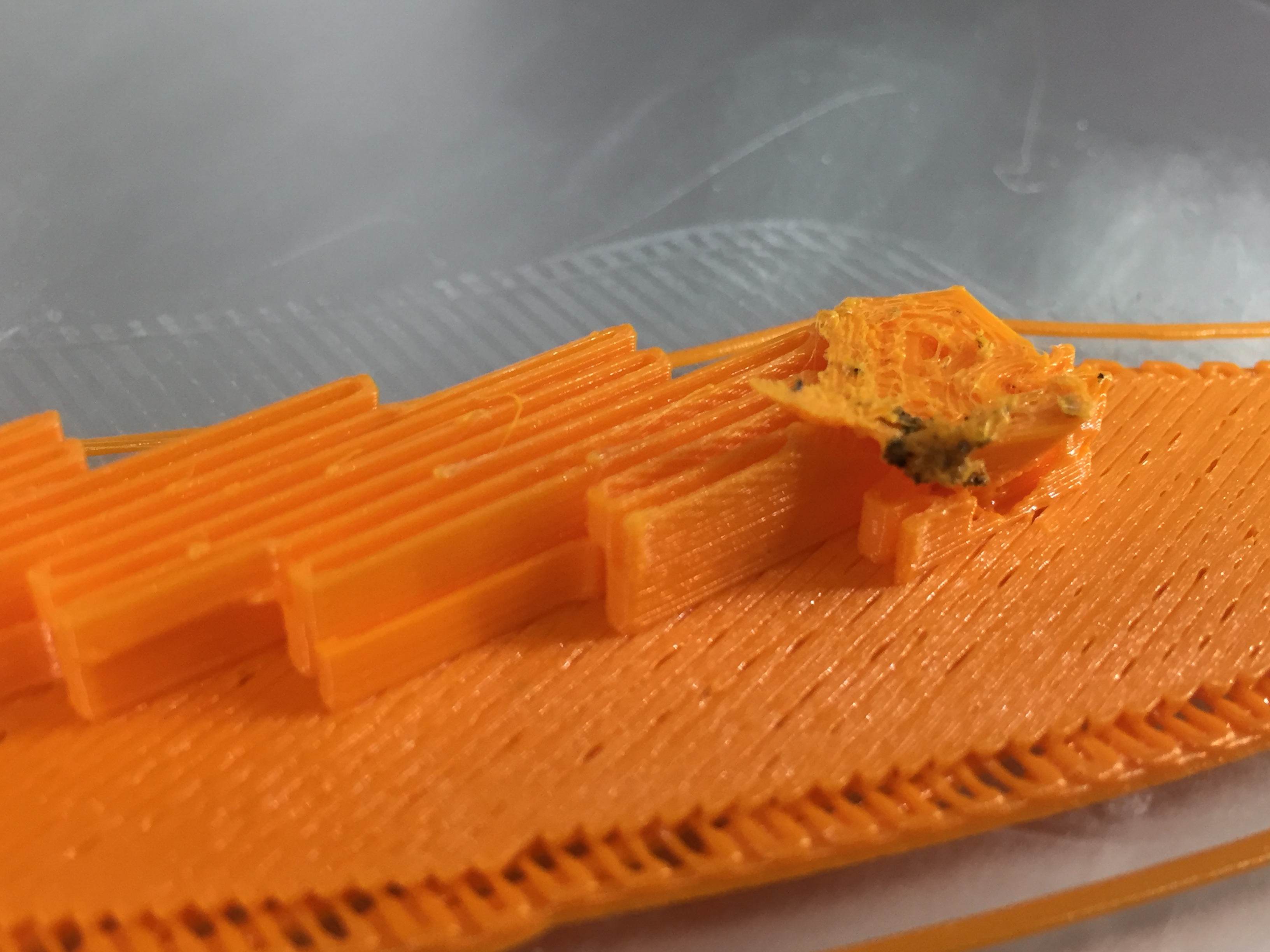

Failed badly

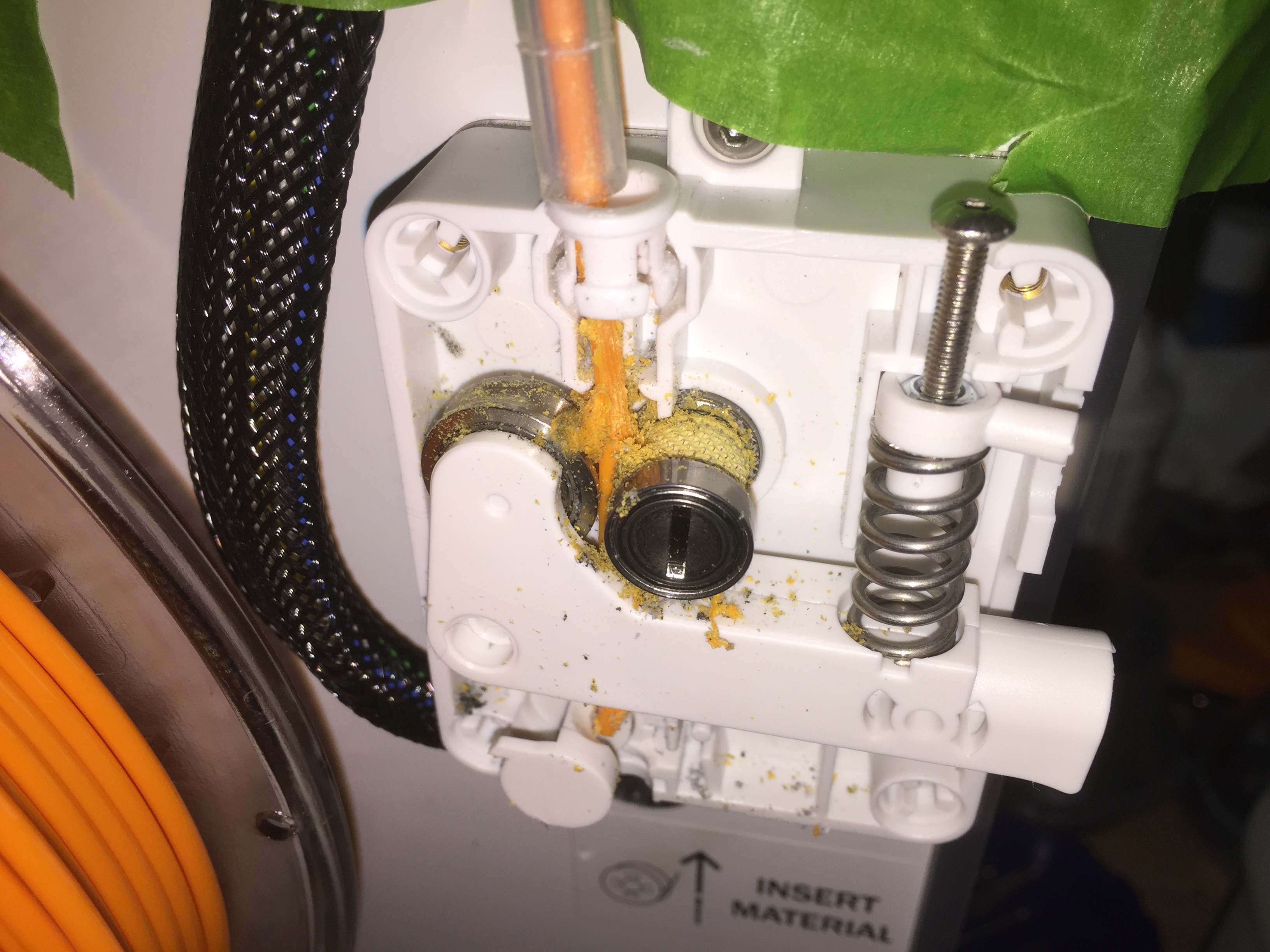

And Simplify clobbered my feeder

Opening up that feeder though...wow. Watch out for an explosion of small parts

I opened it slowly and heard things about to pop out...I knew the spring would leap out at me. The round white filament guide at the bottom took me a few moment to figure out how to put back in place
