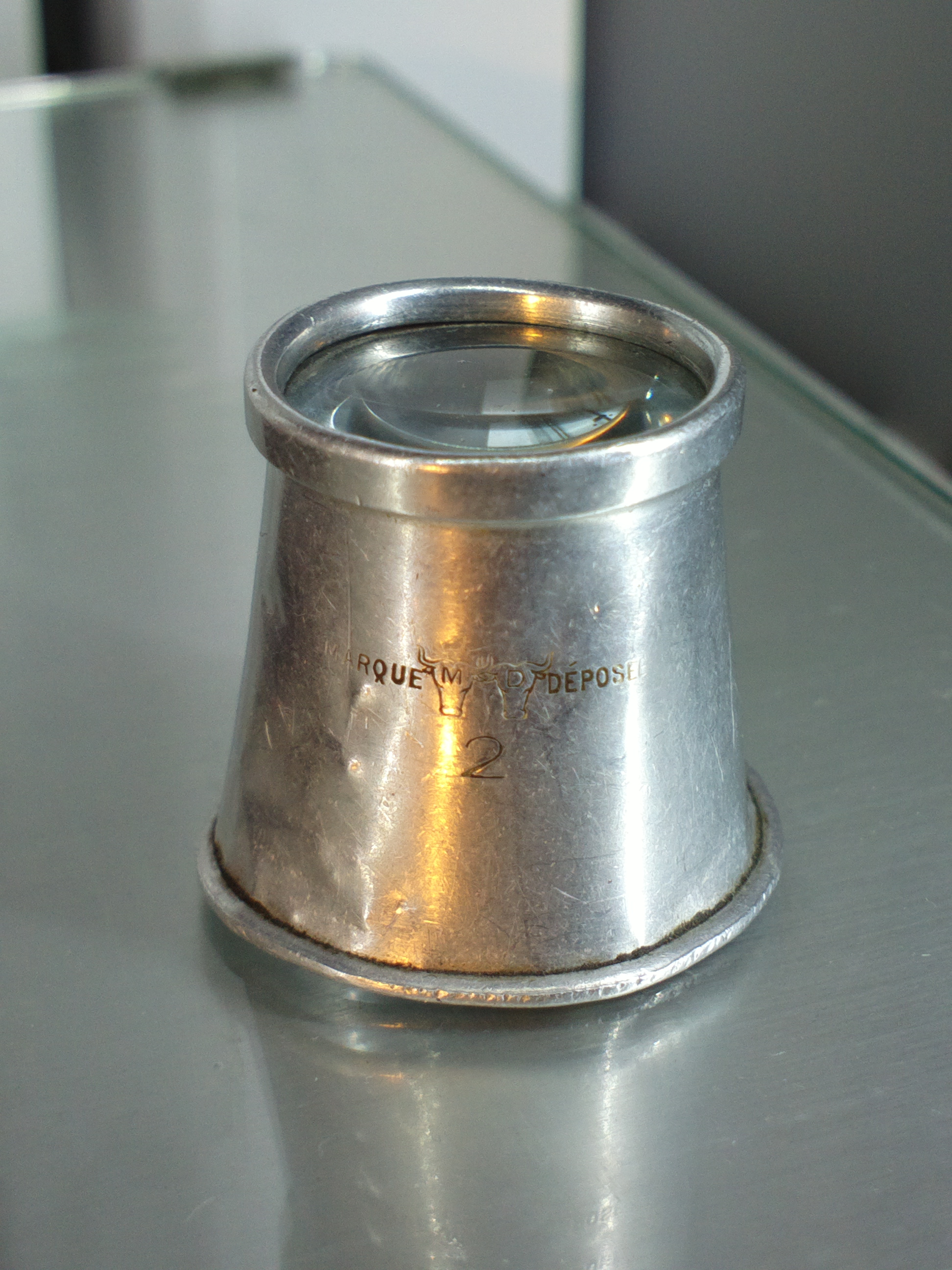

I normally use an old loupe (which I think belonged to my grandfather :-) ) in front of the mobile phone:
With that one I get reasonable magnification but is not a very good combination with the phone.
I had in mind for a long time now to print a lens-holder which snaps on to the phone so that one can use a more suitable lens, but that did not happen yet.
