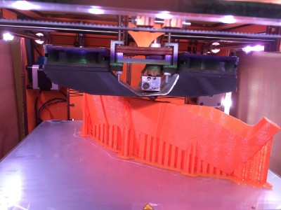

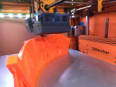

Well I heard from Colorfabb Support about my "styrofoam" like prints and they suggested printing with no fan. A result like that indicates the material is cooling too fast affecting adhesion. I also have the side and front of the printer covered up in cardboard while printing, just to prevent drafts and keep some heat in. The UMO is printing a BB-8 frame piece now and with no fan it looks to be doing really well. I still have few burn-looking spots in the print, perhaps where a blob forms and drops into the print? I'm using Orange nGen so its noticeable! It has a few hours left until done. I'm using the standard nozzle, not the ruby.
Meanwhile, my UM2+ was printing with 50% fan on it's pieces and after doing some testing on those pieces, they are sturdy but less fan will be a good improvement. I've set the fan to off now and had a piece printing overnight but this new spool had an awful tangle inside the spool itself! It must have been quite the show, the force on the filament cut the filament guide in half!
So...the UMO is 70% done and a new one is under way on the UM2+....I think I have that spool untangled some!

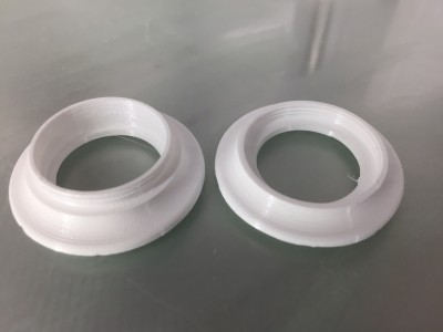

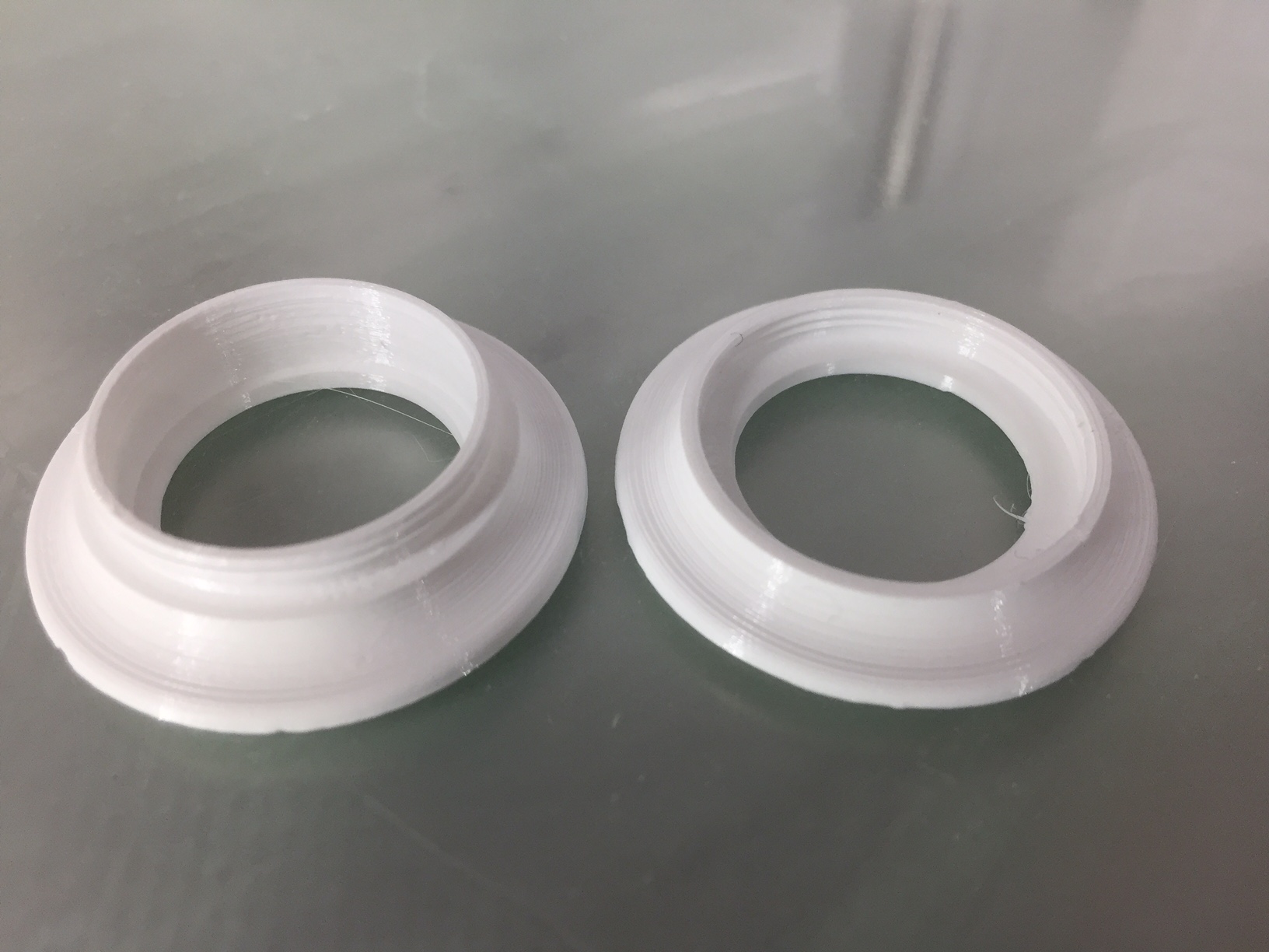

A few weeks ago I printed this nice filament guide wheel in PLA.
Since the wheel halves are threaded, when I had a severe tangle, the force of the filament being pulled split the first one apart! The filament literally sawed them apart.
I printed a new one in nGen and scaled them up to 101% to account for shrinkage to fit the bearing.
Since this was a small part, I had to enable the cooling fan. I had it set to 30% and 235C. The first layer looked a bit wavy but subsequent layers covered it up and the bottom layer wound up very smooth.
nGen does require a bit more thought to get good results. Larger parts want more heat and no fan. Smaller to mid-sized, you may have to experiment a little.
I'm not a big fan of white filaments but this nGen, once you dial in the correct settings, looks really nice!
I initially had another filament guide on the back left side of the machine (viewing from behind). That fell apart and so far, I have just run this one guide by itself. It's done a good job on one spool of nGen!
