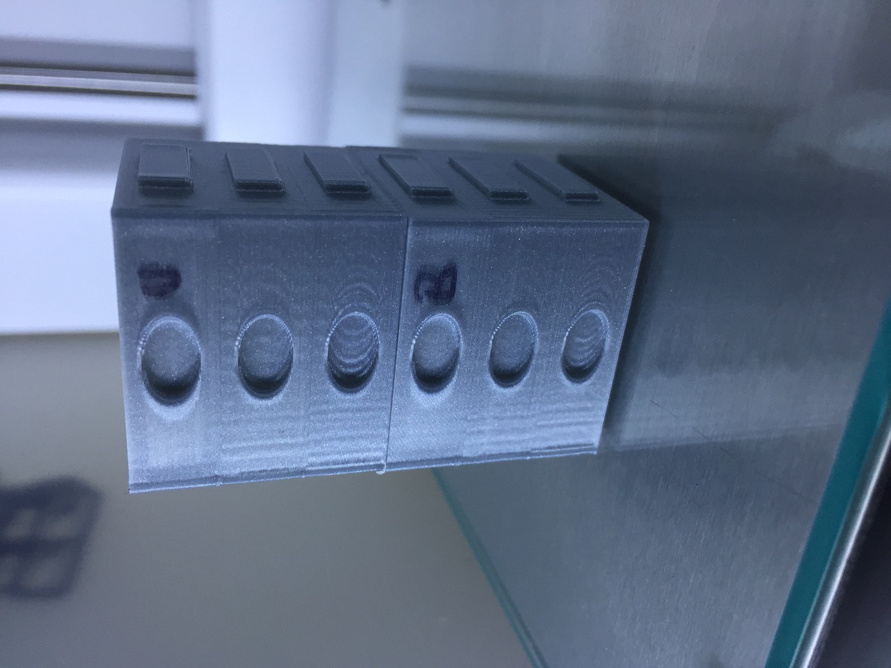

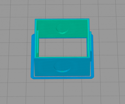

This is how it should be printed, to make the circles and squares make suden changes on the toolhead movement to make ringing
Use 0 Infill and 2-3 o 4 perimeters, no top or bottom layers.
Example of a print using 3 process and different accel/yerk on each block as it changes process

Might be just lubrication, running a lot of stuff currently with the UMO, will have to look into this toogudo wrote:Hi antiklesys !
Seeing the photos, it seems you have also a Z problem !?
