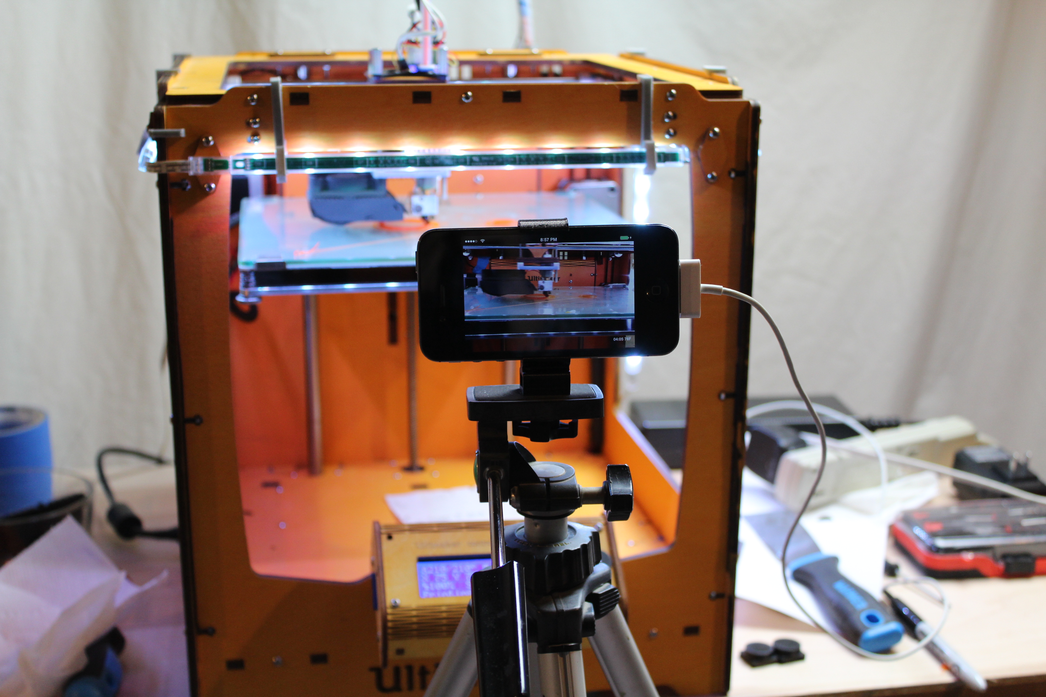

I know a lot of people use GoPro Cameras or a variety of webcams.
I re-use an old iPhone 4!
For $1.99 , Lapse It Pro works great! I suggest plugging the iPhone into the charger for longer prints since it can quickly eat a battery. (https://itunes.apple.com/us/app/lapse-i ... 95161?mt=8)
I printed out an iPhone tripod adapter to complete the setup. (http://www.thingiverse.com/thing:251813)
Here it is in action!
How do you time lapse your prints?

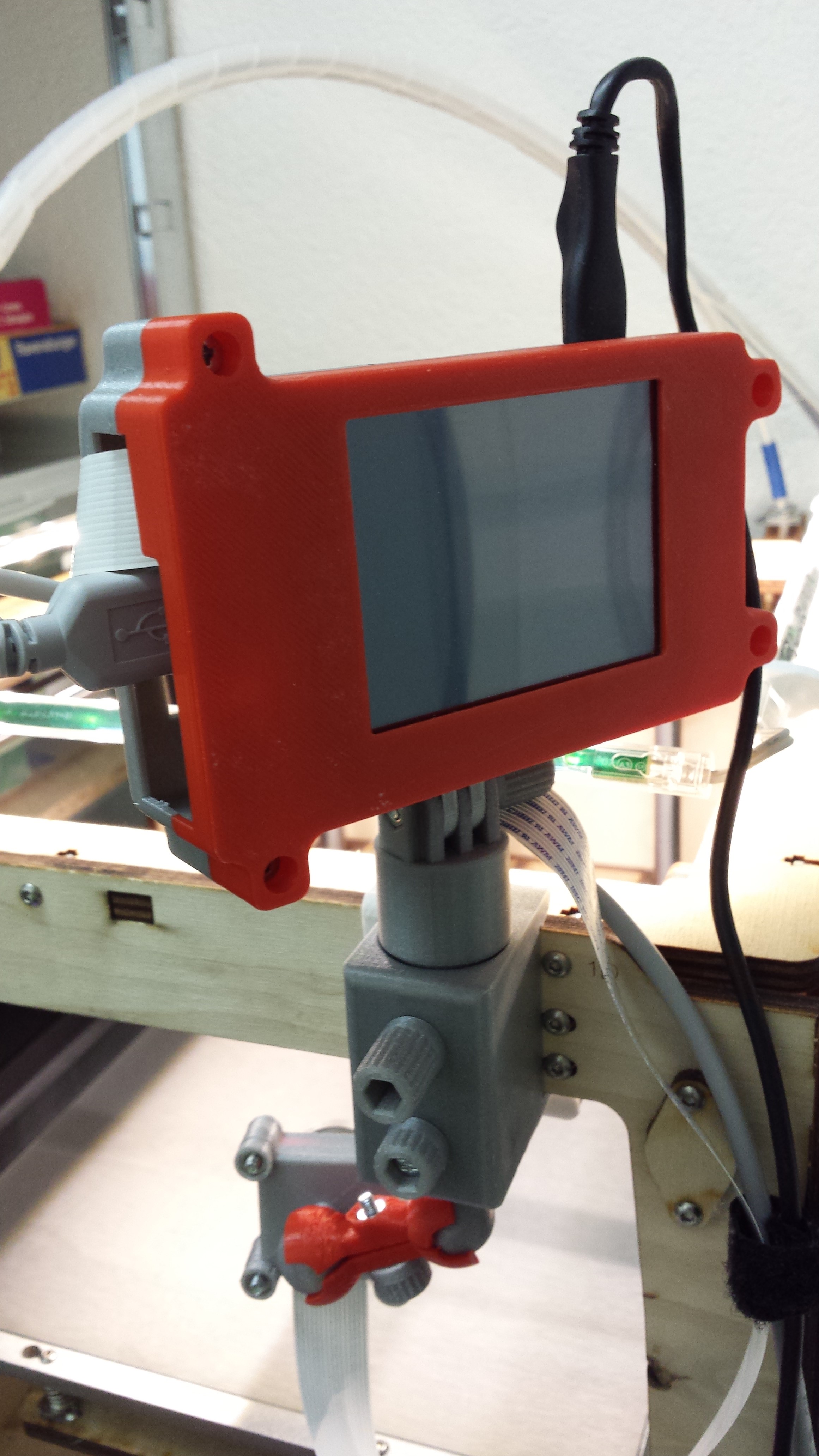

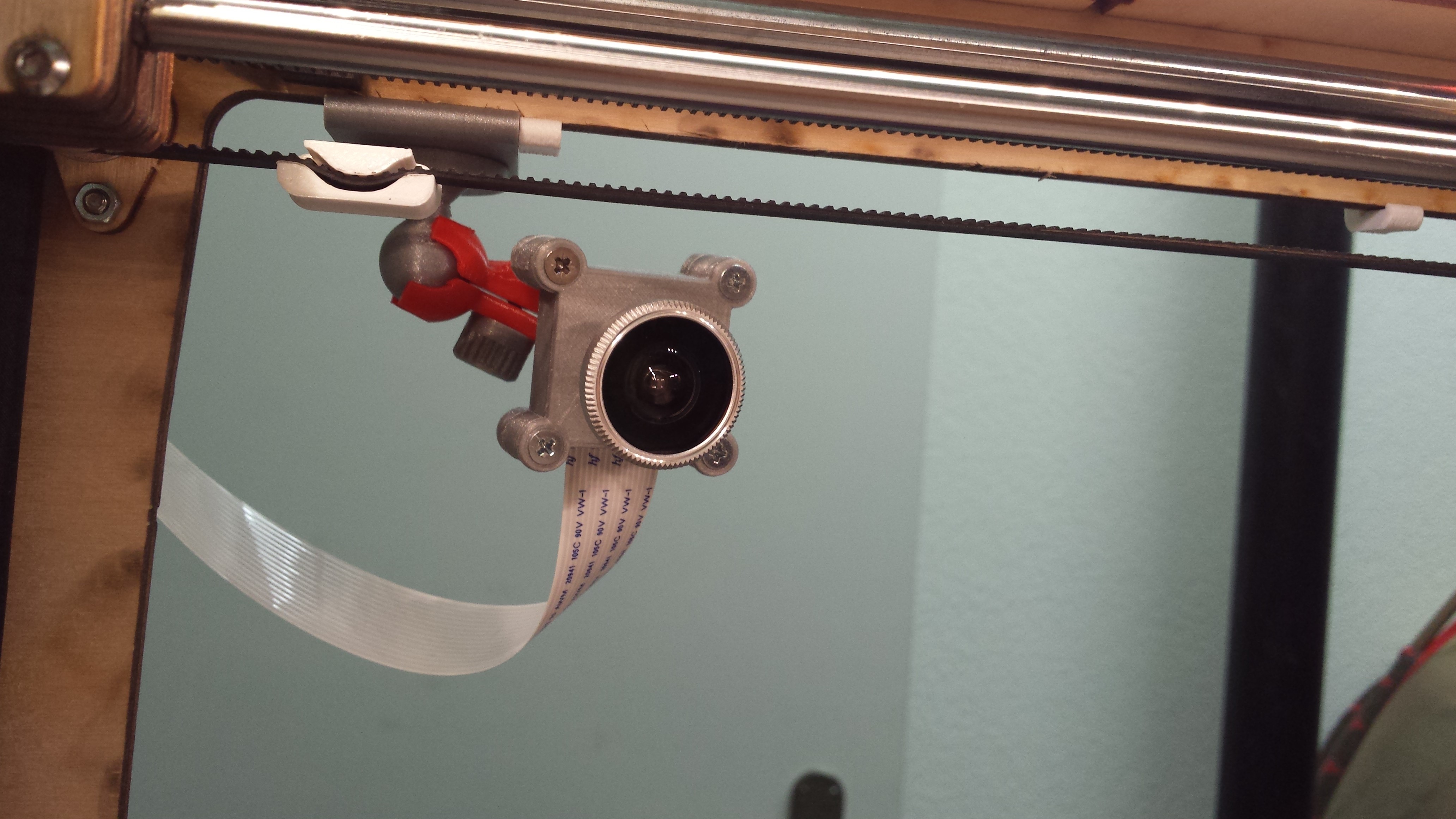

I use a Raspberry Pi with the RaspiCam mounted to the front of my UMO. To the cam case I have connected a "fish eye" lens. You can check some of the tl's on my youtube channel (I use it for 3D-Hubs prints to show my buyers the process).
https://www.youtube.com/user/mbienz/vid ... =0&sort=dd
My Case (designed in 123D Design quite some time ago
) attached. There are still some things I don't like about it, that's why I have not published it on youmagine (or thingiverse or else). I don't use octoprint but something I have written in Python / pygame and uses mjpeg-streamer as a camera interface... also this is not really ready to share but works okay. It basically just takes a picture every n seconds. After the process I create a video from the picture sequence (not on the pi, manually).
That's it... if someone wants more info, I am willing to share, no problemo.
