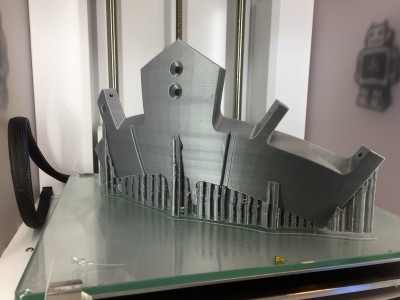

14.5 hour print, first one on the Ultimaker 2+
Used glue stick and bed temp of 65 (first print flew apart 1 hour in)
Cura 2.3.0
I think I should try the 0.8 nozzle and cut the print time in half!

Looks nice! How much more prints do you need before it's finished?

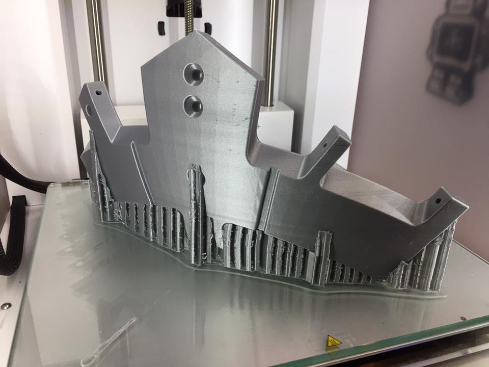

This one was done with the ruby nozzle

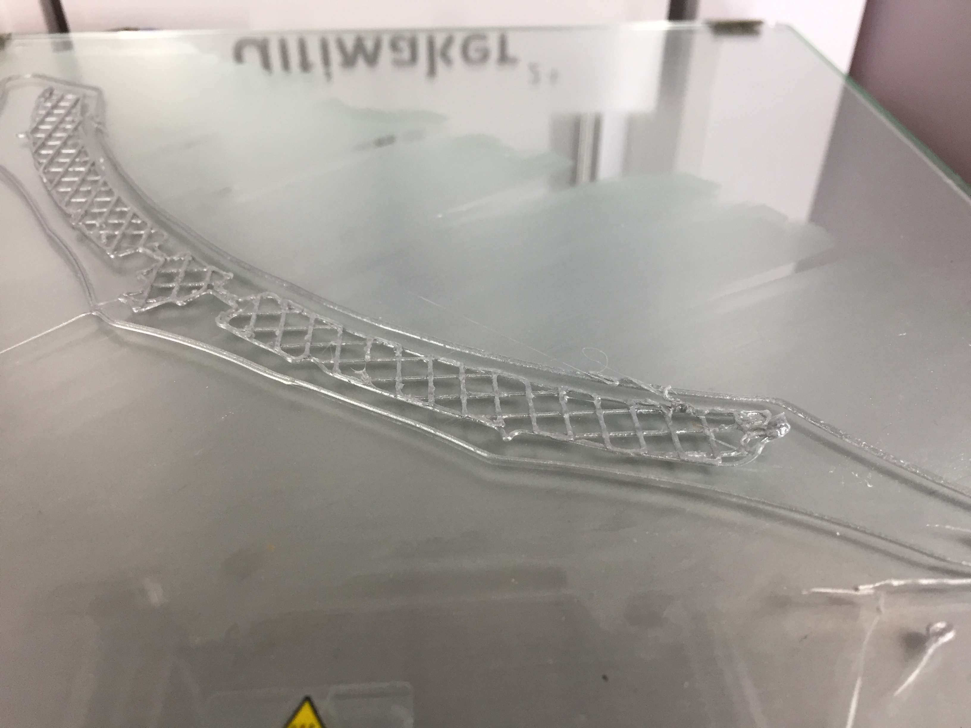

We'll 0.8 is a fail. It seems to keep clogging itself up

Maybe you need to increase the temperature a bit. If you print at the same speed and layer height, your flow is now twice as high.

Well it must be a matter of tweaking settings for 0.8
I did a small calibration print...that came out fine. It seemed to take longer to prime the print head but eventually flowed well
Now we're a few hours into another 14 hour print.

I find that with a 0.8mm nozzle I have to drop the temperature by 20 degrees in ABS, something close to that in PLA.

Yeah, when I go to .8mm I increase the temperature by quite a lot too. Like 20-25 degrees.
