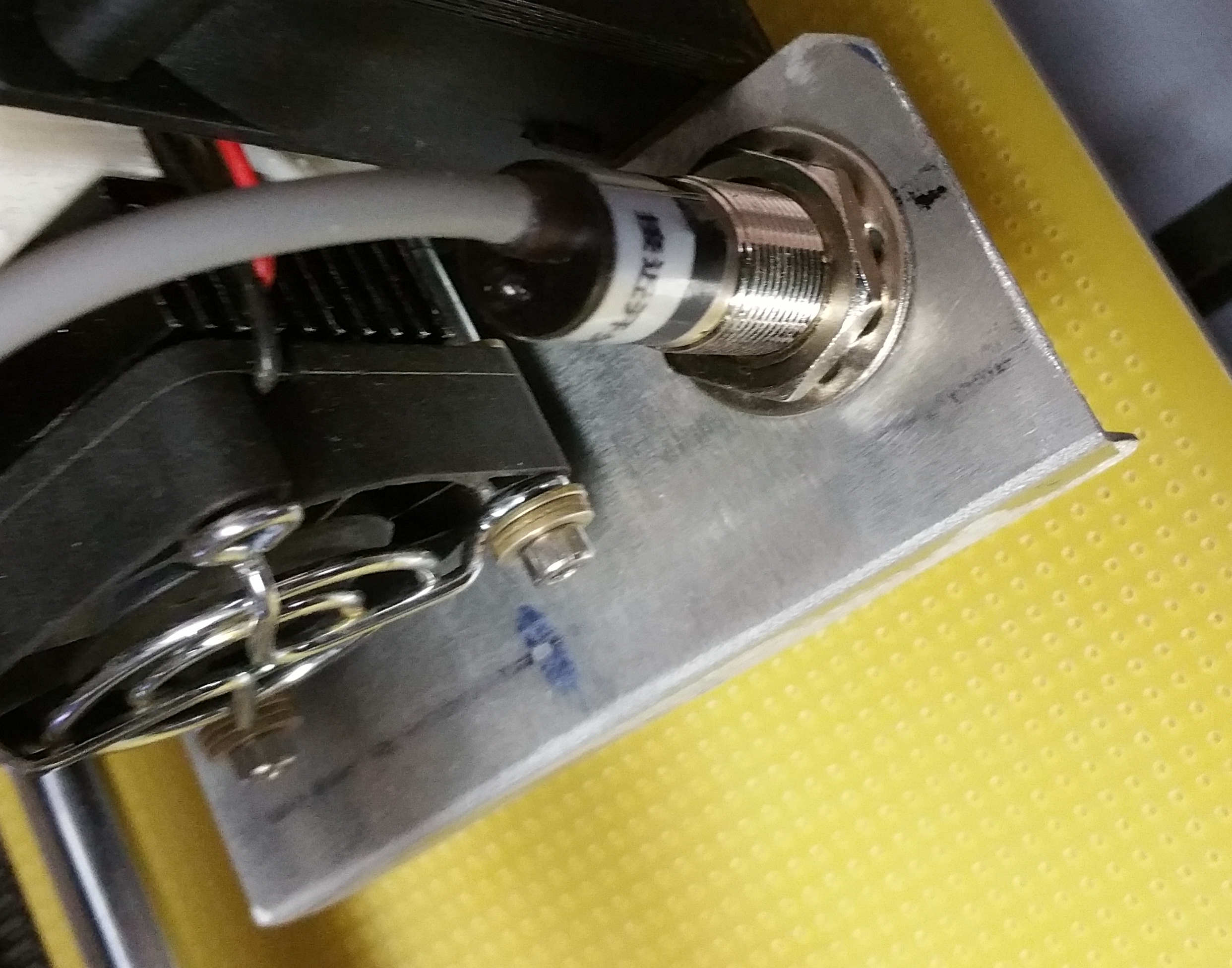

I've been working on my 3DP11 for awhile waiting on replacement parts; Limit Switch bad, Z axis screws bent, extruder with wrong parts. This is how I'm mounting mine (see pictures) but no matter where you mount it, it goes off the work area. I have been trying to get them to send the configuration.h file but they seem to think Open Source means something I don't understand. I have a MKS Base 1.3 controller which again, I have been trying to get the pin outs and what they set the stepper drivers to for step size, they just flat out told me they are not open source.
I spent some time tweaking the screws that came with this machine as I wait on the lead screw setup I paid them for as an upgrade just to find out they shipped 4 step lead screws. The machine works but makes bad sounds when moving around manually with the control panel. In the pictures I haven't ran the sensor wire into the cable run yet.
A few hours later: I adjusted the X axis to be equal then adjusted the the bed and then lowered the inductive probe until it triggered. The result is a new probe NO+NC LJ18A3-8-Z/CY Inductive Proximity Sensor - My existing probes: LJ12A3-4-Z/BX and LJ12A3-4-Z/BY just became pet rocks.
1. The black SIGNAL wire shows 0 volts until triggered and then it is 5 volt. The 3DP11 is pulled up to 5 volts until the limit switch closes then it is 0 volts.
2. That 4mm sensor is from China is really 1.4mm which is the thickness of the material over my bed before I add masking tape!
