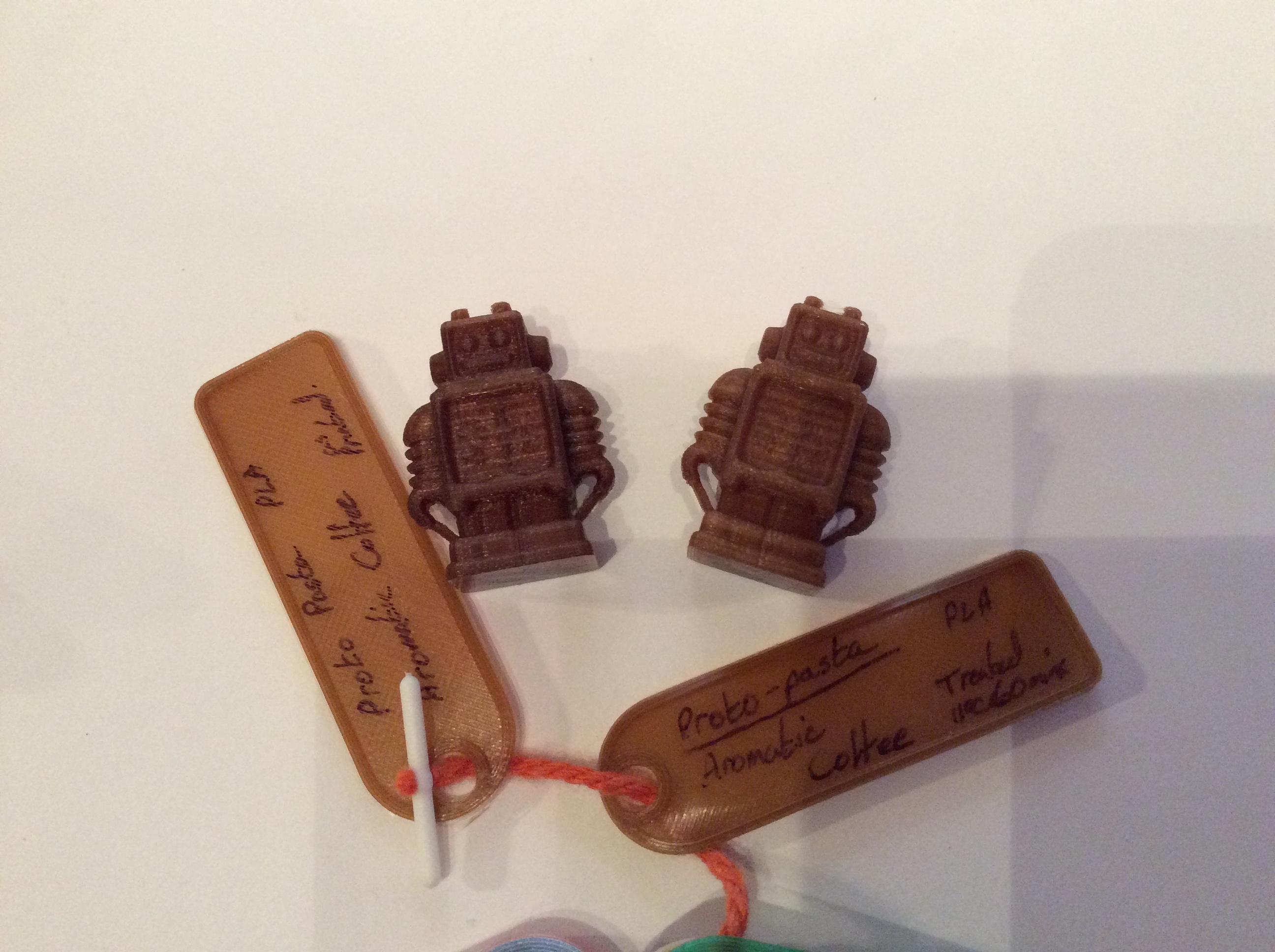

I've grabbed some of my test robots,
1) Rigid.ink ABS
2) ColorFabb PLA/PHA Red
3) Faberdashery PLA Jade Green
4) Aromatic Coffee HTPLA
5) Aromatic Coffee HTPLA heat treated.
All dimensions in mm-----(1)-----(2)-----(3)-----(4)-----(5)
Height to top of head:- 31.52. 31.88. 32.00. 31.70. 33.00
Head depth:--------------13.40. 13.43. 13.43. 13.45. 12.95
Head width:--------------15.20. 15.30. 15.25. 15.27. 14.70
Chest depth:-------------14.75. 14.73. 14.77. 14.79. 14.04
Shoulder width:----------24.70. 24.66. 24.50. 24.80. 23.70
All of these have been built from the same Cura file over the last 18 months, the two Aromatic coffee parts were built one after the other on the same day and one was then heat treated to there recomendations.
There is a slight difference between the materials which could be to individual material shrinkage characteristics, but the difference between the two aromatic coffee samples can only be due to the post printing heat treatment process.
Hope that is of help or interest to you.
