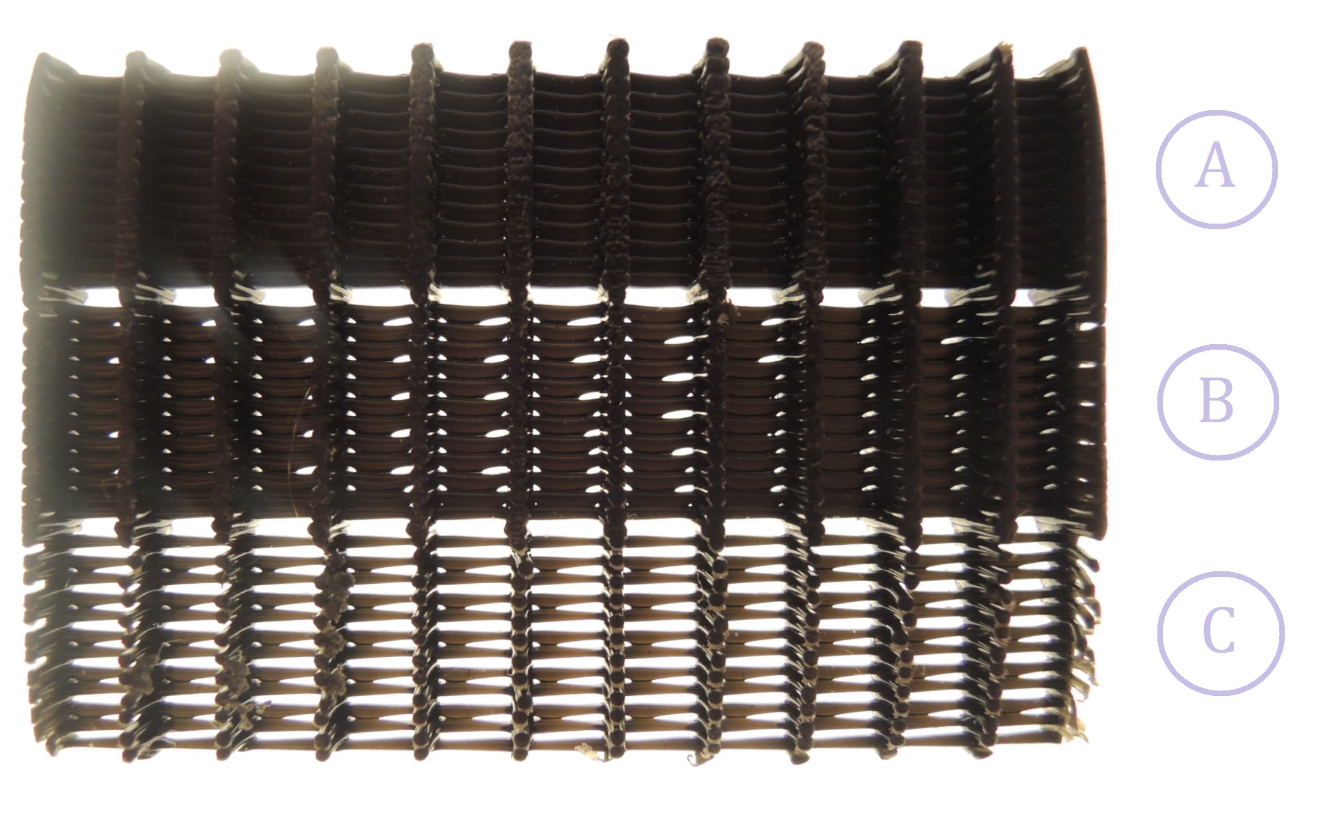

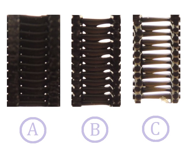

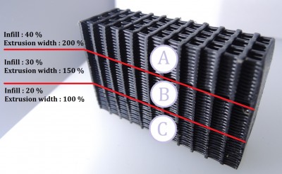

I lov this trick but I never actually used it (saw it you post it months ago on the french um area) I always forgot to ask....
How much more heat you put on the print to compensate the mm2 and did you saw any loss on print quality because the extra heat vs speed?
Re: Infill extrusion width
While we are at questions, I have a dumb one -- I don't have S3D and it is not clear from your post:
Is the extrusion width only changed for the infill or for the whole part?
