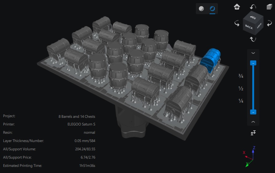

I'm new to resin printing and would like to print minis in bulk for ttrpgs. I'm using an Saturn S. I tried printing these flat with no luck so I added supports. Do you all think this will print or am I way off? There are so many variables I'm unfamiliar with any help would be appreciated. Thank you!
Will this even work?

I have a Saturn 2 & 4 and I do prints flat to the bed from time to time.
What was the problem with printing them Like that?
I can't see any reason why the print would fail.
If you do add supports you need to tilt the parts at an angle, so it isn't trying to print a large area all of a sudden.
