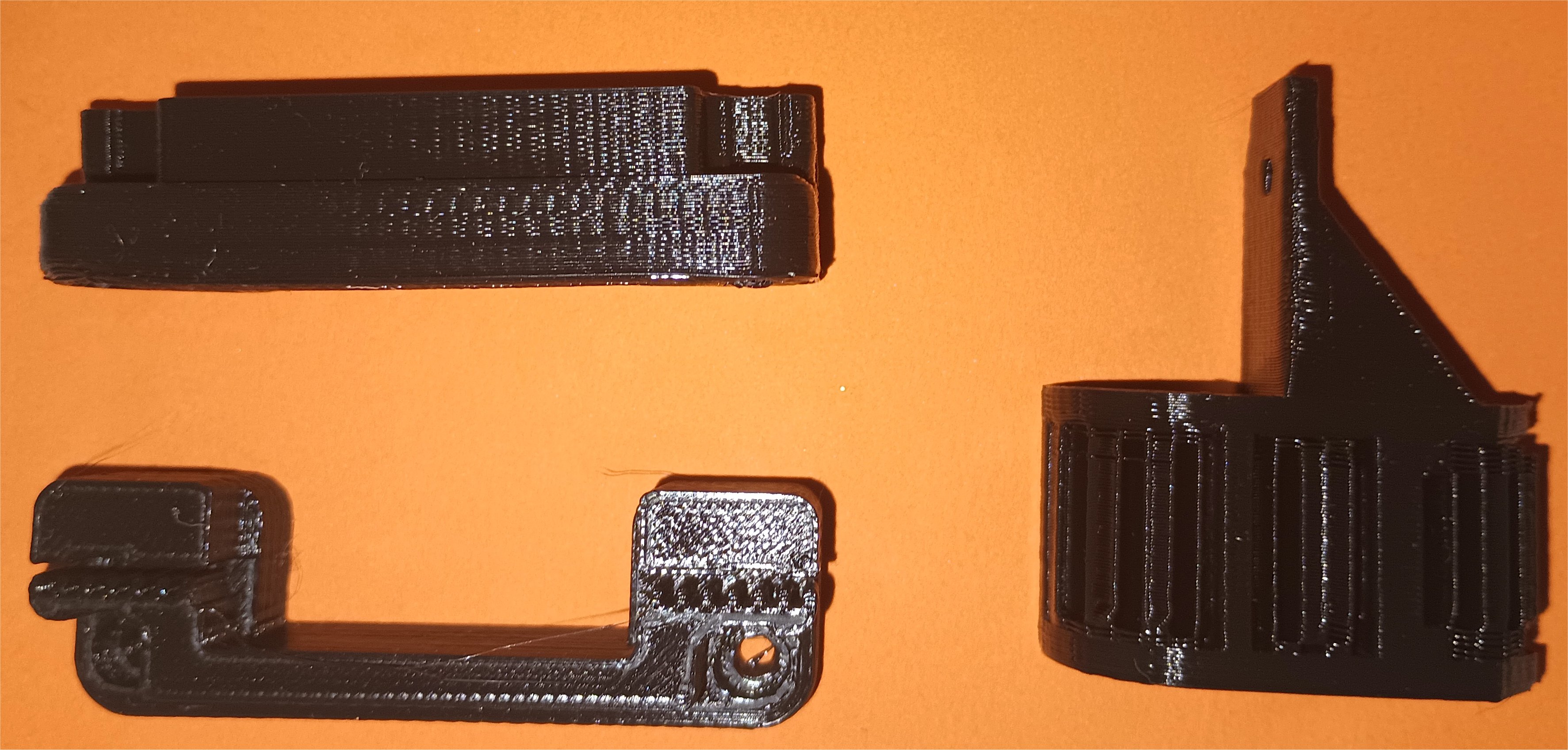

I 3D Printed a few repair parts for my Hictop 3DP11/12 Printers photos shown below
Not bad for years old filament that was left in a plastic box in a non heated / cooled garage for almost 2 years.
I swear by this moisture eliminator I purchased at the local dollar store.

Glad to see you were able to make the parts, now you can start making more pieces parts:})
