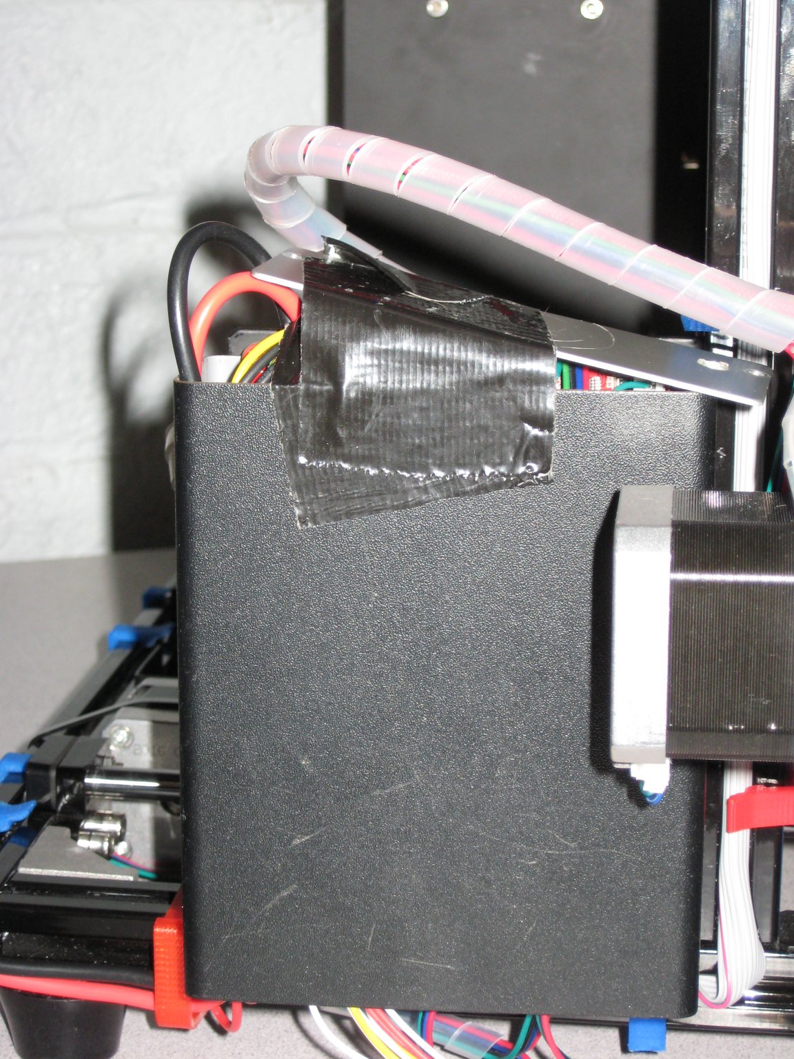

I had this problem on my Hictop, as i believe that the display cables were too long.
Solved the problem by shielding the cables leading to the Display and created a 3D Printed shielded controller cover.
I used Aluminum Foil Tape to line the 3D Printed case and connected a ground wire to the foil at the Fan vent site.
Almost forgot I also printed a cover for the display and shielded in the save fashion.
After I have never had another runaway nozzle.
In fact all my 3D Printed models became somewhat smoother after the shielding mods.
Started with a test Shied below Then designed and 3D Printed permanent cases and shielded.
