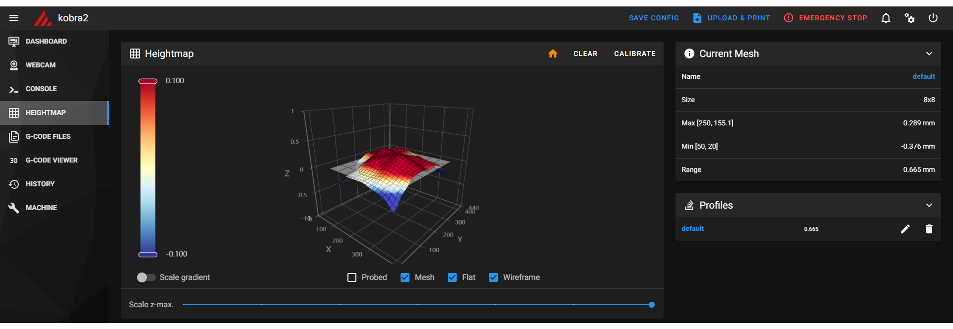

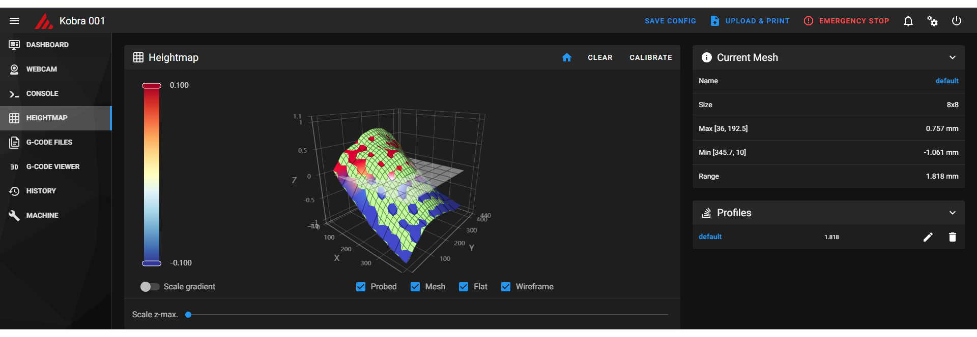

I have 2 heavily customized Anycubic Kobra Maxs running klipper off of a NUC, both have an octopus pro board, Mosquito magnum, BTT smart filament sensor and BL Touch. I had a catastrophic failure on one that broke my hotend off and since then I have not been able to get a Bed mesh to operate correctly. The BLTouch has been replaced as well as the wires back to the board. The Bed Mesh on Kobra001 is my issue, this mesh should appear to be more like that of the image of Kobra 2. The problem here is the printer operates off that god awful mesh and Prints extremely close on the back of the bed, perfect in the center and so high in the front it wont stick. Before my failure this worked excellent and the heightmap was not like this. I have done multiple meshes and get consistent results.
Do any of you have any ideas?
