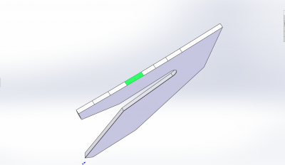

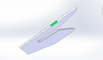

OK, I've had a look at the files, as I'm no expert on Freecad I can only make my observations.
One of the faces has more details in it the the other, see the face with one if the facets highlighted in green:
LH-file
LH-file
RH-file
RH-file

Lez0 wrote: November 28th, 2022, 2:34 am OK, I've had a look at the files, as I'm no expert on Freecad I can only make my observations.
I think the difference in level of detail is the small file has flat-sided hexagonal nut shapes, and the other has domed shapes. Presumably the domes require many more meshes to model.

Post by Lez0 »
STL files can't do curves, they are a series of flats. I don't know about Freecad but Solidworks let you set the precision of the exported .stl file.
