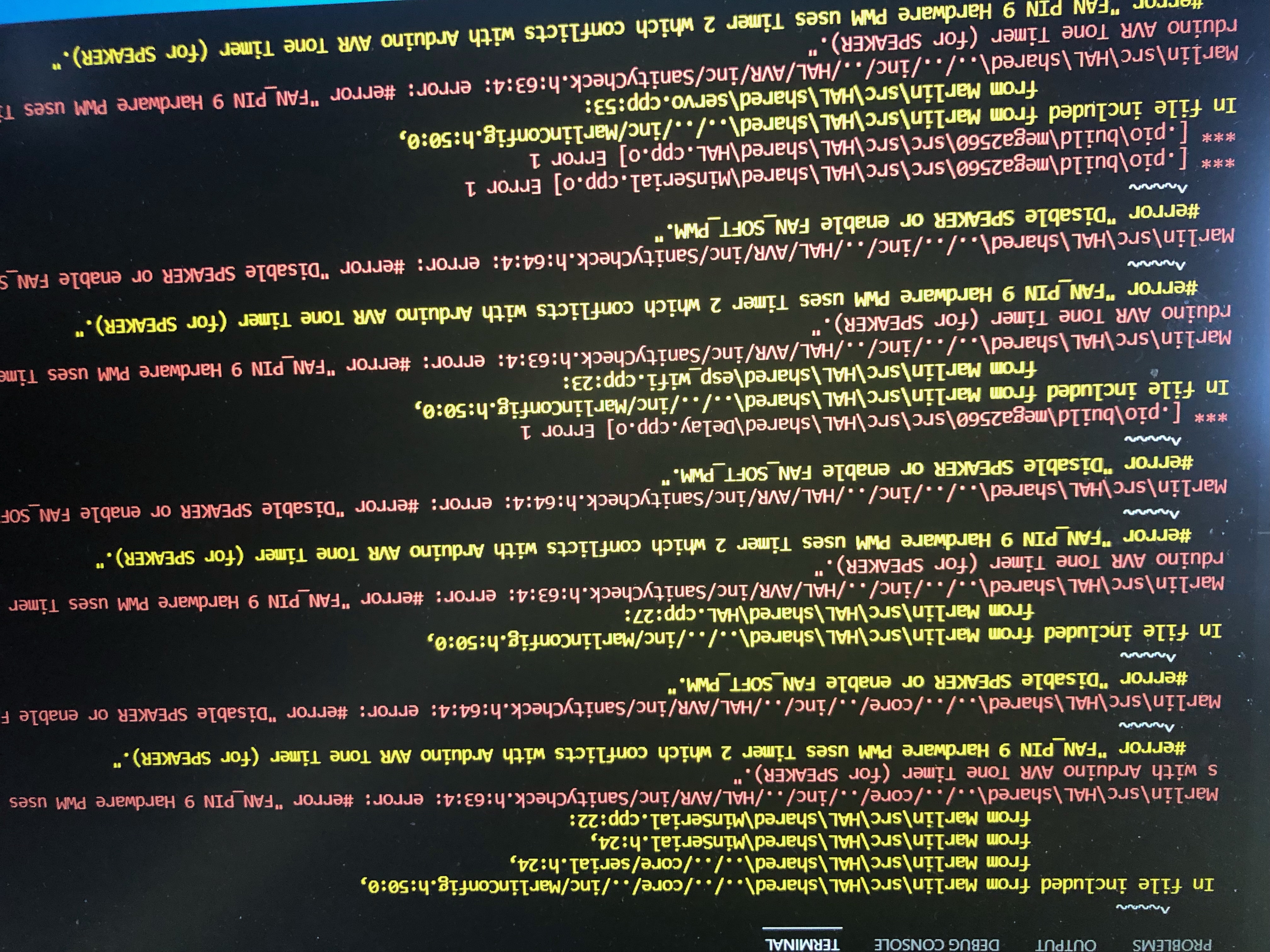

I downloaded the new marlin software (more than one actually) took the files form the geeetech config files off of github for my printer. downloaded vscode and the suggested plugin from the video. tried to compile and it failed. tried with 2 other versions all failed so i downloaded the marlin plugin and it also failed to compile. any suggestions i can take pics if you want to see what it says on the screen

Post the errors that were displayed when you complied the firmware.

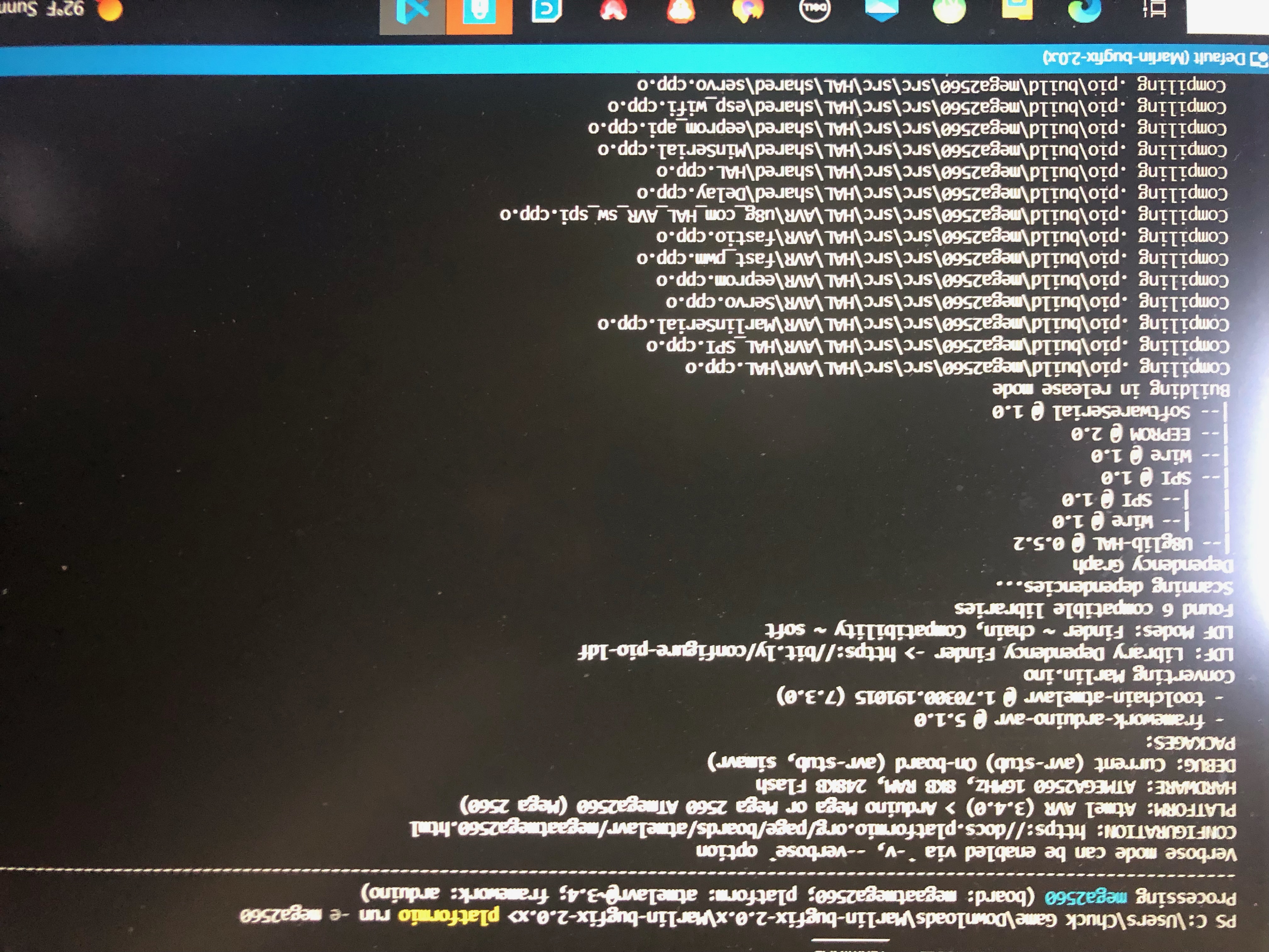

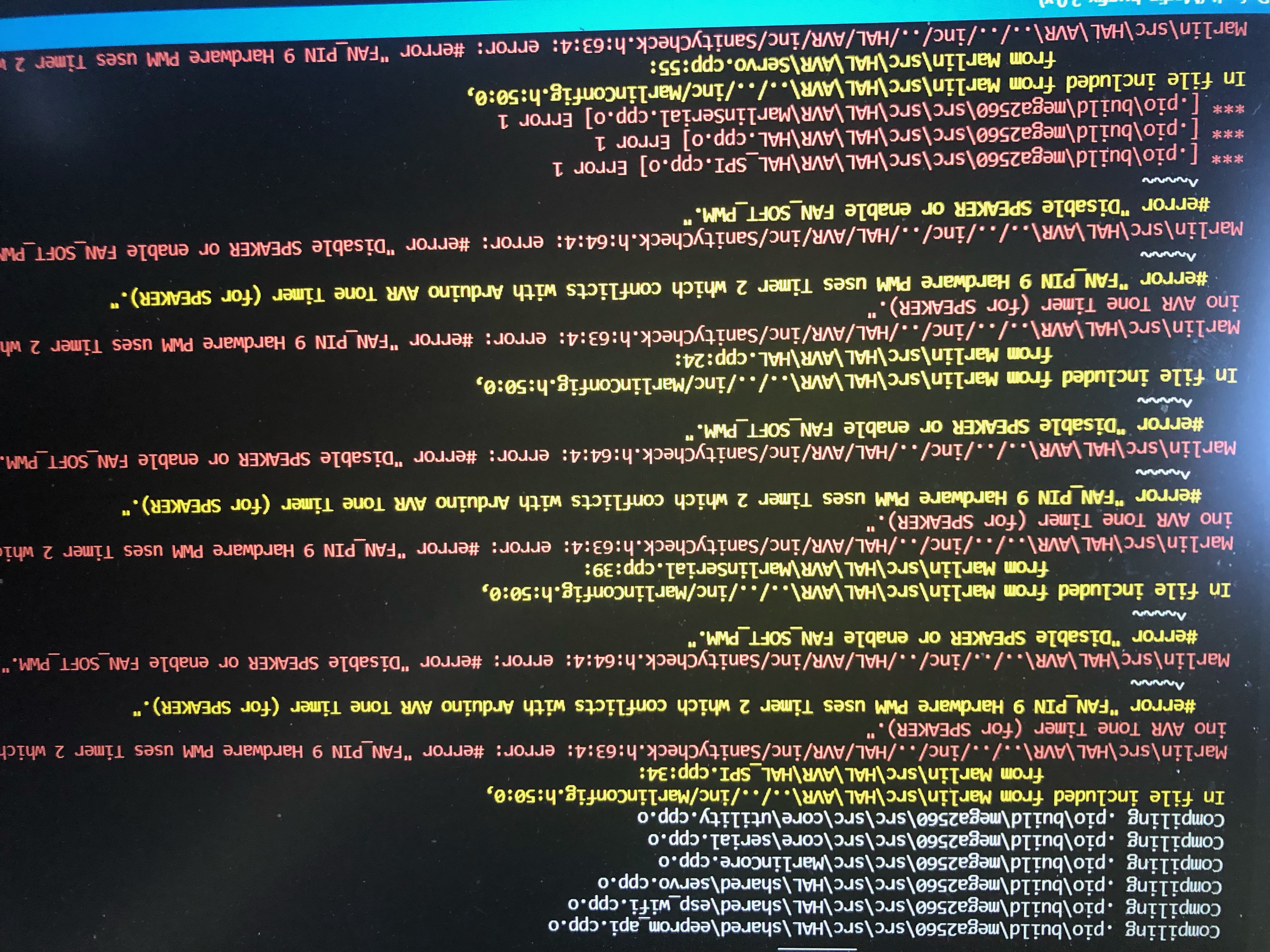

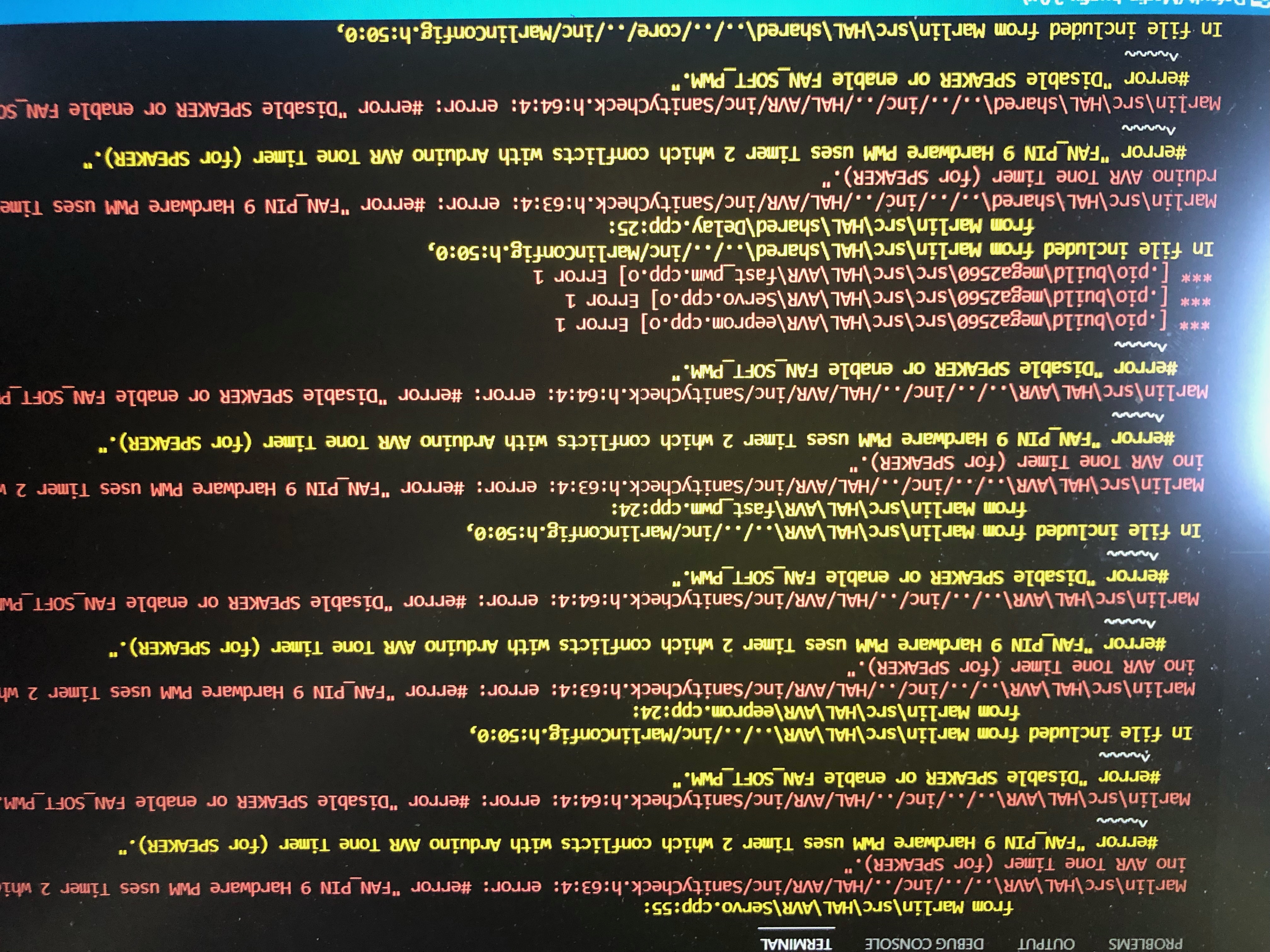

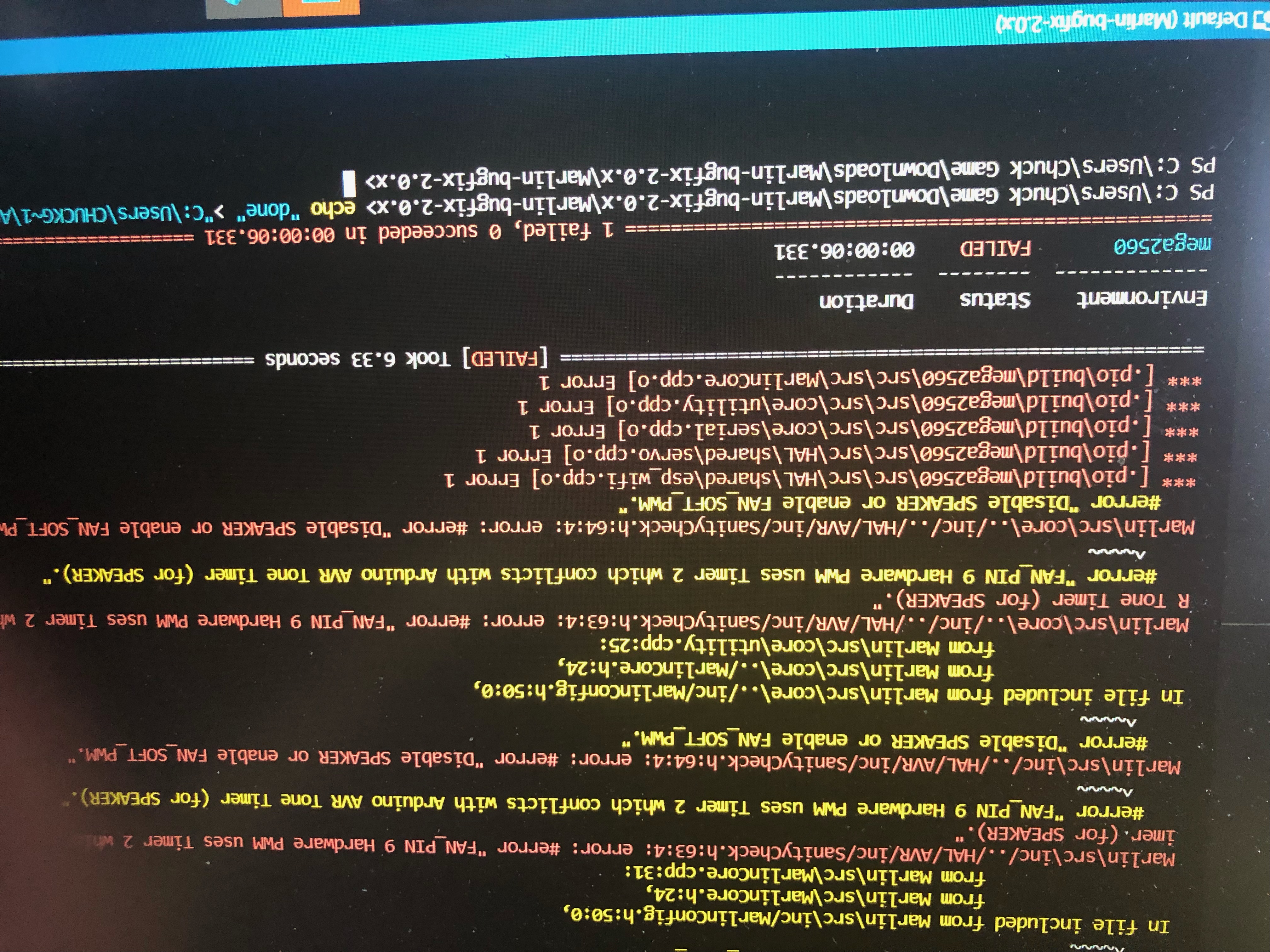

these errors or pretty much the same except for the version of firmware (yes i did use the correct geeetech files from the examples folder per version)

sorry the pics are in reverse order
