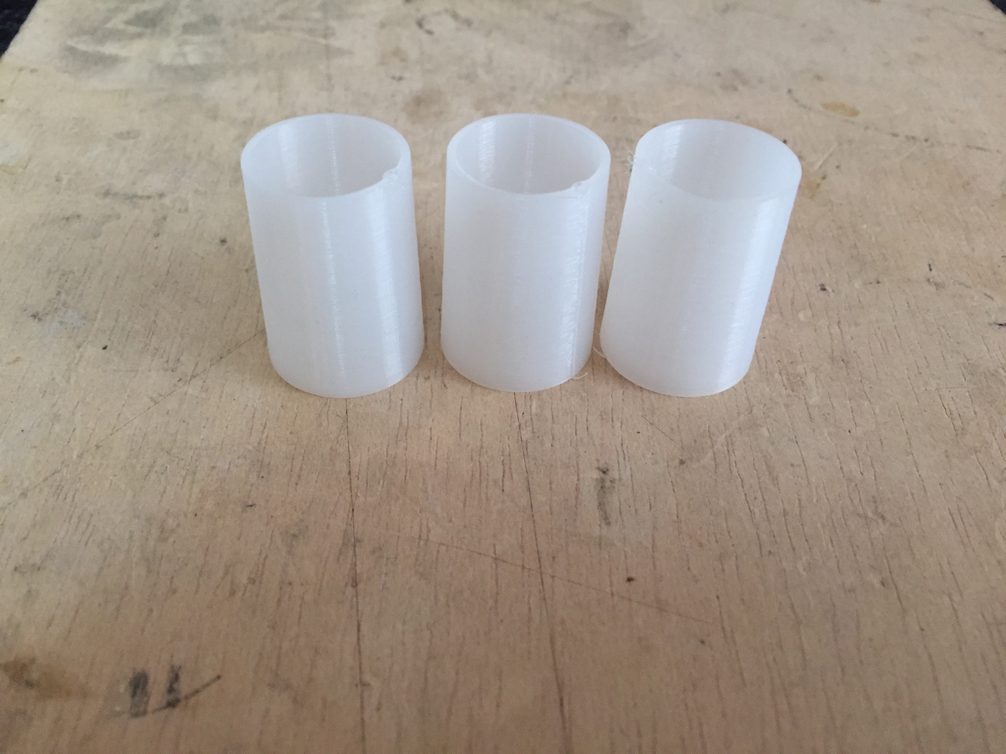

I bought a 500g SUNLU TPU 1.75mm.
These are the first samples 1.2mm thick cones. They came out very well.
Settings in Cura:
0.1mm layer 0.8mm wall thickness (no infill)
Temp 220C
Build plate 40C
Speed 20.0
Retraction-off
Retract at layer change-off
Cooling: fan speed 20%
No supports
Skirt.
Thanks to Paul for his video.

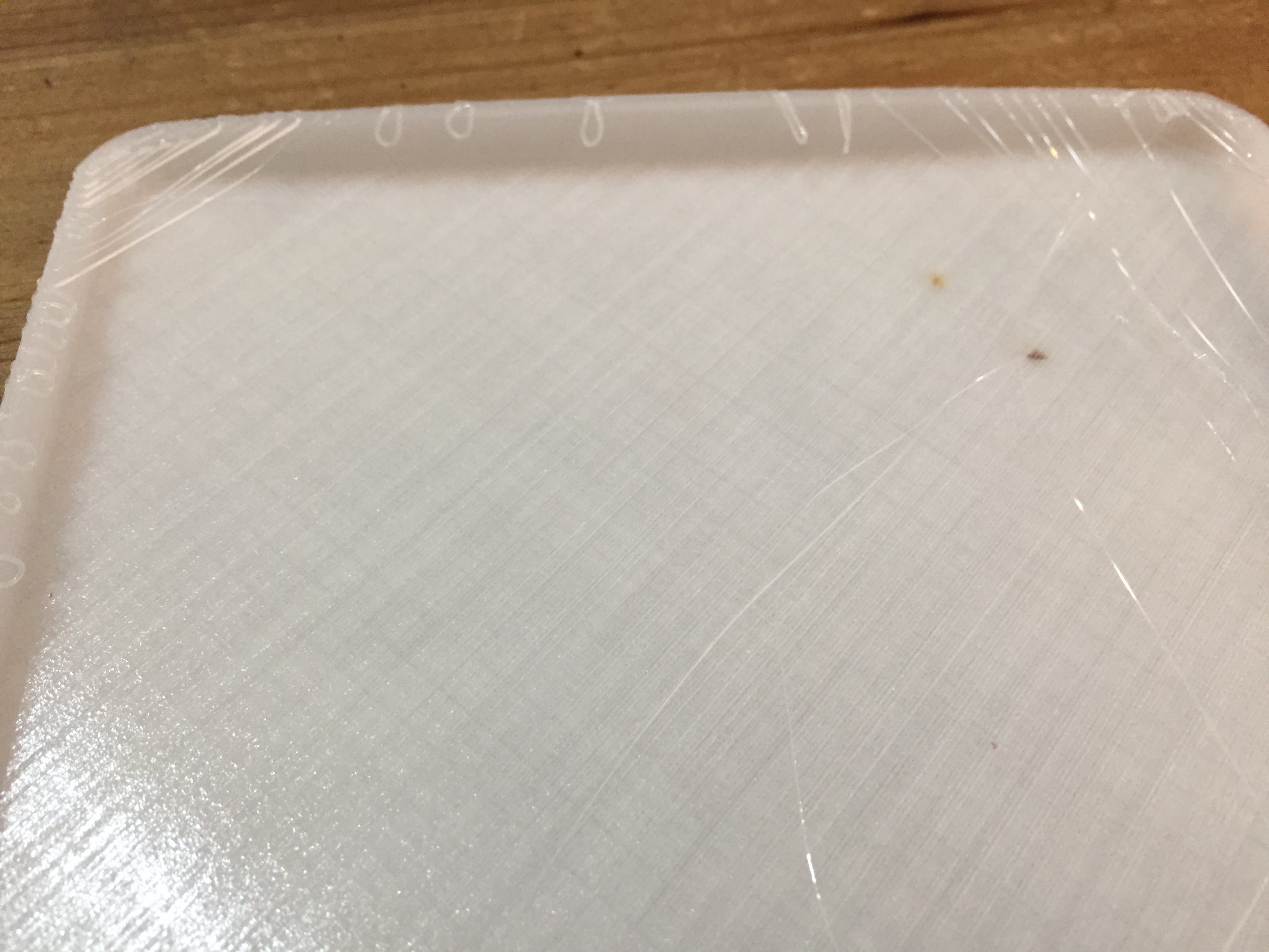

2nd print.
Well I expected a little bit of stringing. I guess I'll have to do a bit of trial and error.

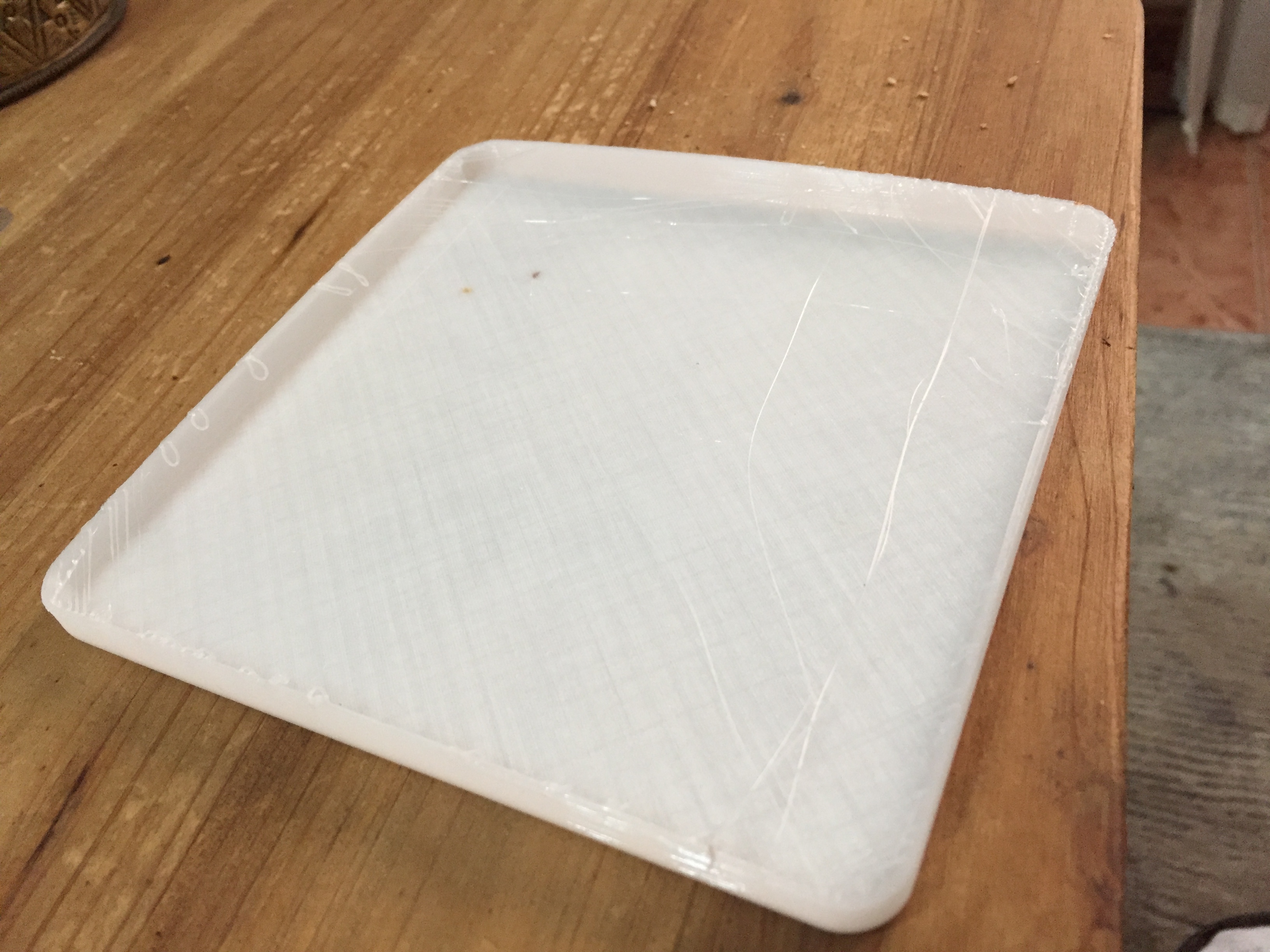

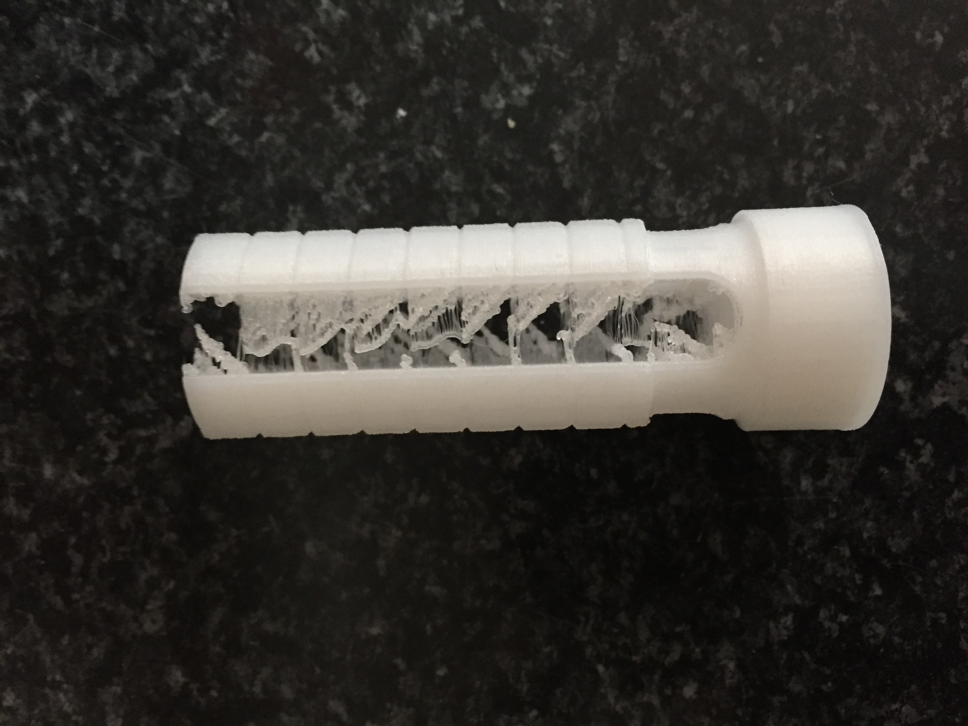

I did another print enabling retraction. and retraction at layer change.
Retraction distance 2.0
Retraction speed 15.0
Combing Mode, All.
As you can see the prints are a lot better.
I don't think I can get rid of the stringing but there isn't a lot.
Lez
