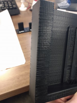

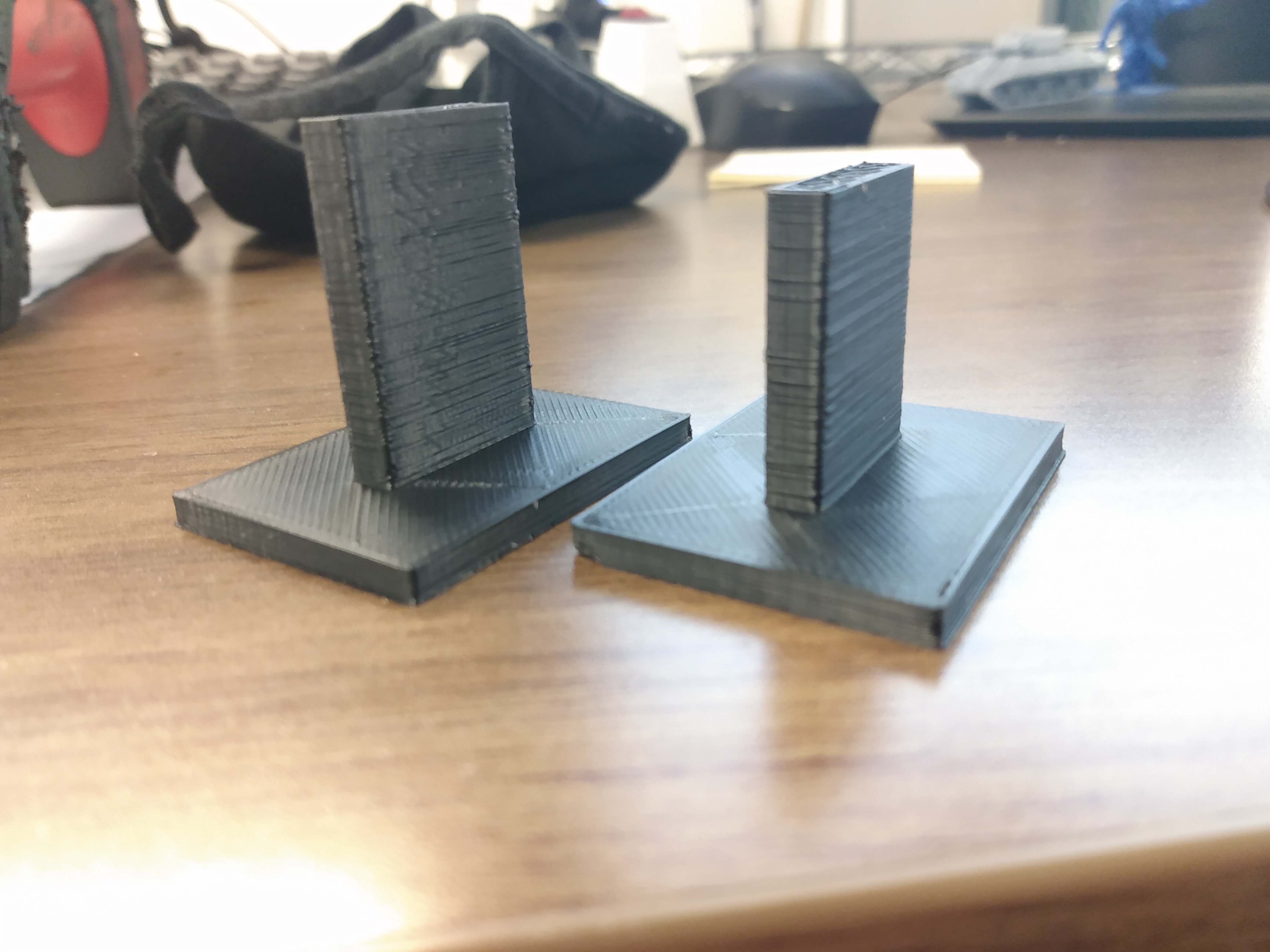

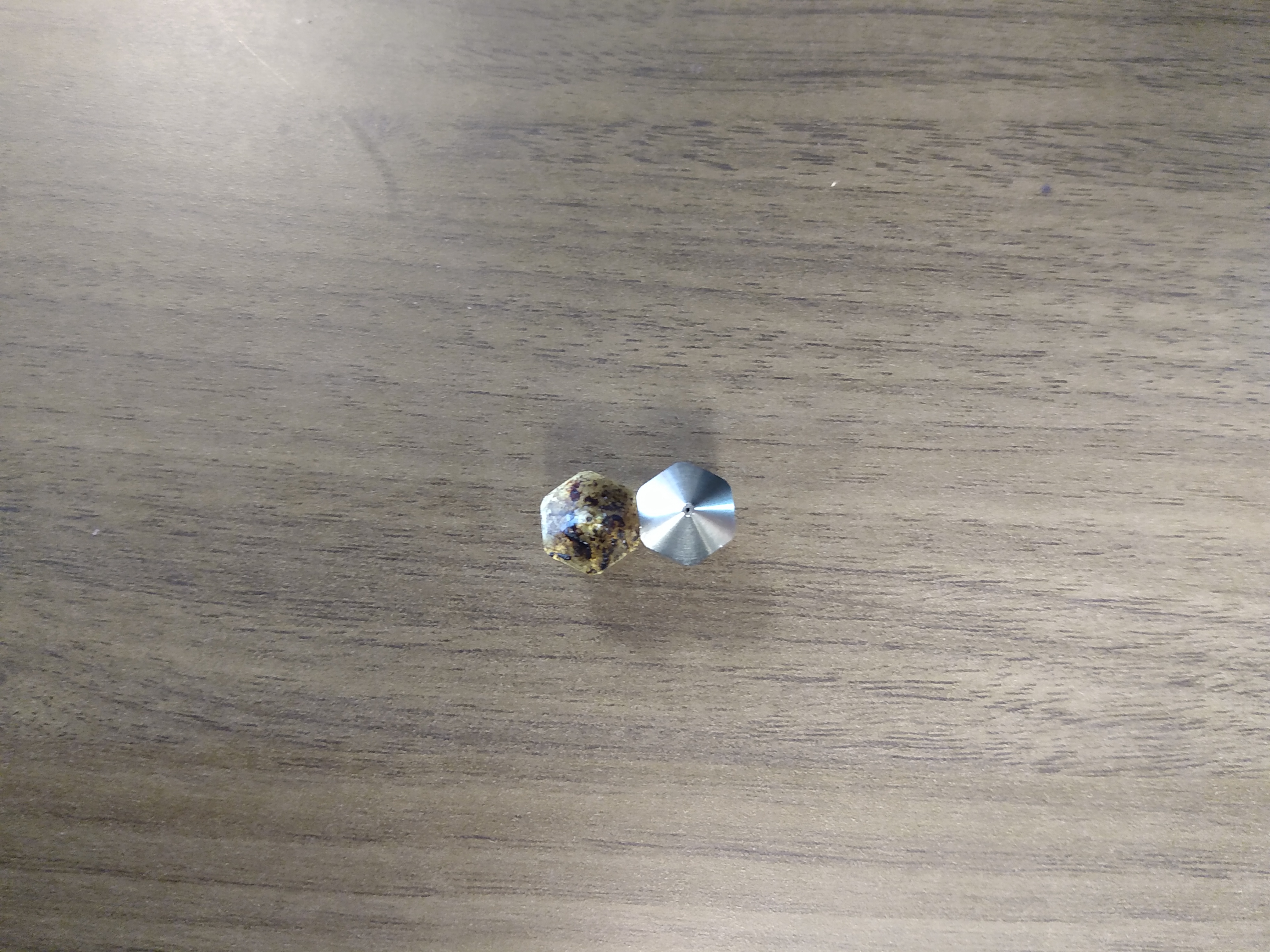

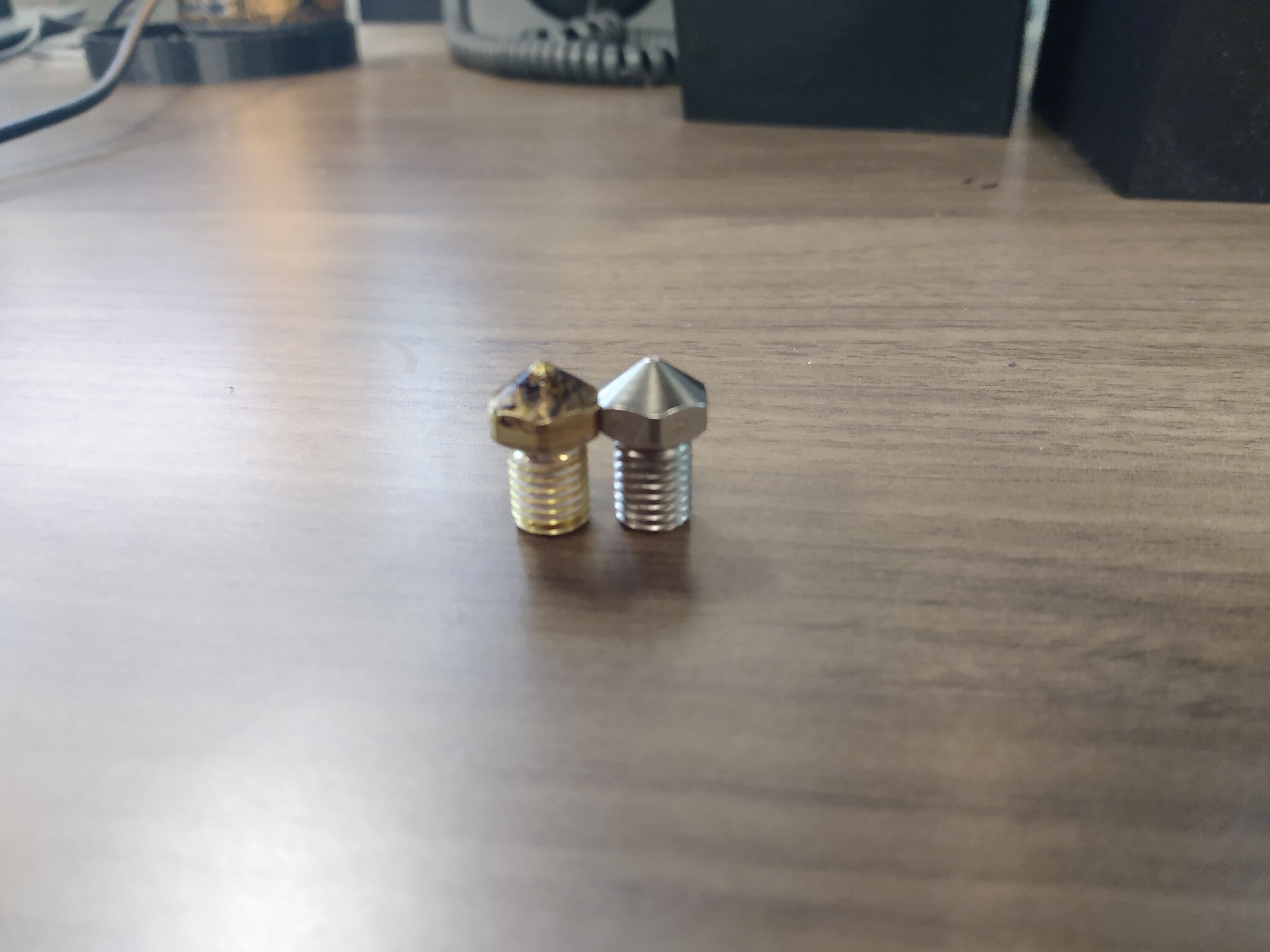

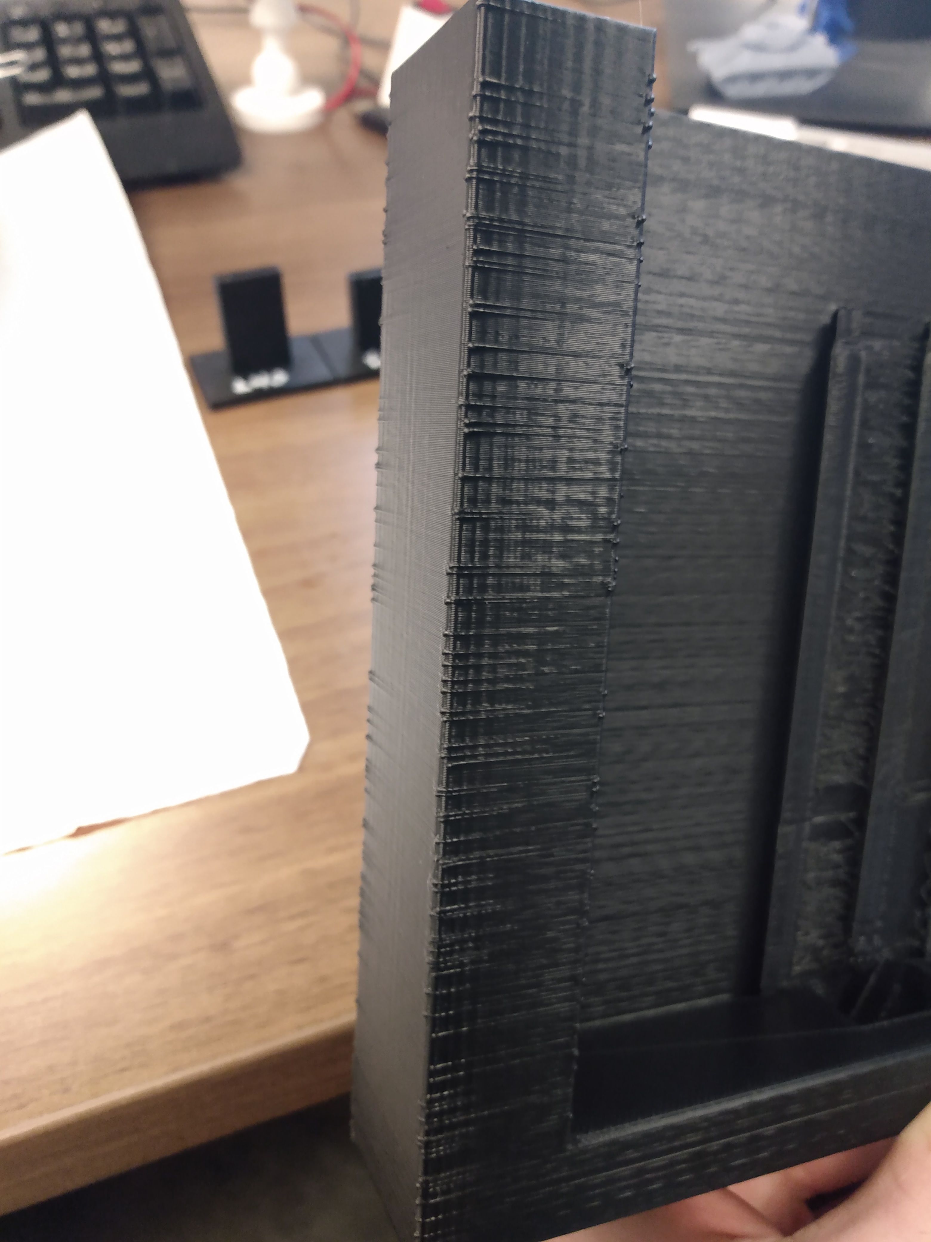

I have been working with a Dremel Digilab 3D45 printer from brand new for the past 8 months, and it has been handling just about anything I have thrown at it. It had gotten up to around 900 hours when I noticed the print quality had kinda started dropping, I had a lot more stringing than before, and there were some inconsistencies that were messing with the prints, to the point I had to throw out a couple prints. I figured it was due for a nozzle change, as I had heard that you should change the nozzle every 500 hours or so. My workplace went and ordered some 0.4mm A2 Hardened Tool Steel Nozzles to replace the stock brass 0.4mm nozzle in the hopes that the steel nozzles would last longer and produce higher quality prints. However, after installing the new Nozzle, every single print has had a severe drop in quality. Each print shows some bad ripples, most notably at the corners. I have tried to resolve this issue, I have lubricated the guide rails, Ensured the drive belts for x and y axis are properly tight, and made certain that the nozzle is properly and fully screwed in. I have come to find out through online research that Steel nozzles have worse heat conductivity than the brass, and I have tried modifying the temperature settings and fan settings to try and resolve this. The recommended temperature for the ECO-ABS is 230C. Still cant seem to make it print smooth like it used to. The Steel Nozzle is slightly longer than the stock nozzle, so I did have to adjust the nozzle gap on the printer to ensure the first layer adhered to the bed properly. My question is, does anyone have an idea as to what I can do to resolve this quality issue? I would like to avoid having to get another Purchase Req for brass nozzles after just getting $125 spent on these steel ones. What can I do to make these a viable replacement? As it currently sits, since I am unable to figure out the solution for the steel nozzles, I have switched back to the old brass nozzle in order to finish the projects that should have been finished 2 days ago.

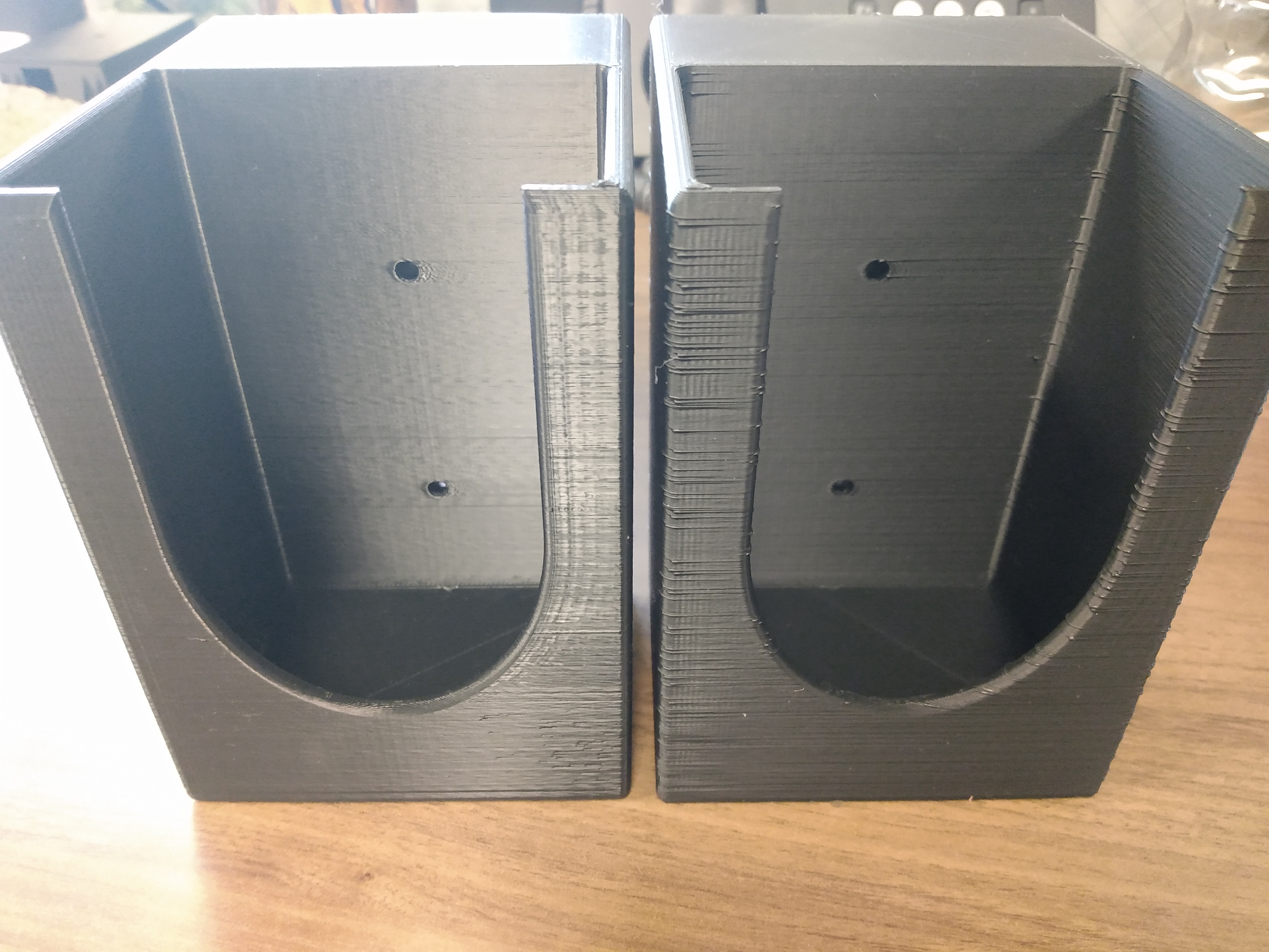

I ran another print with the same Temp settings and the fan at 50% speed. Still seem to be having the same issue, so it doesn't look like it'll be the fan that will fix this...
I also ran another one using the printer over-ride default settings just to see what it does. It printed at 230C and the bed was heated to 55C instead of the 60C default in the slicer. No visible improvements at all...- draracos

After switching it back to the old nozzle and running another print, it turns out it is NOT the nozzle that was the issue, despite it starting to happen when I switched the nozzle in the first place, this print on the old nozzle turned out exactly the same.
I am at a loss here. It almost looks like its slipping on the x and y axis, or maybe theres some sort of wobble on the hotend itself? Not really sure... Any advice would be helpful.- Roberts_Clif

Update, it turns out the entire print head assembly needs to be replaced. The device lost control of it's temperature, and thinks that it is sitting at 1025°C, on top of the other issues, I decided to call Customer support, and they instantly resorted to replacing the entire assembly. I look at this as one of the downsides of the Dremel Digilab 3D45, in that while it is easy to get started printing right out of the box, and it usually delivers high quality prints, if something goes bad with the printhead, there isn't much you can do to troubleshoot it. Dremel really likes their proprietary products, and try their best to lock you down and prevent you from having much control. If I were looking for a new printer for personal use, I would think twice before going with this one.

Re: Ripples on corners after changing Nozzle
