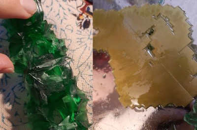

I recently bought a Creality LD-002H Printer, really enjoying the material, but having some issues,
1- from my first Print I have a Line, seems like the model is cut on Y axis, in some prints, it's really noticeable and seperated,
2- in my last experiments, the right half of the model was dispart platform during the print, just wanted to know any way to avoid it and keep the model keep connected to the top platform? and as I hear, when the platform wants to go a step up, it sounds like the model is stick hardly to the glass and making a sound to separate,
