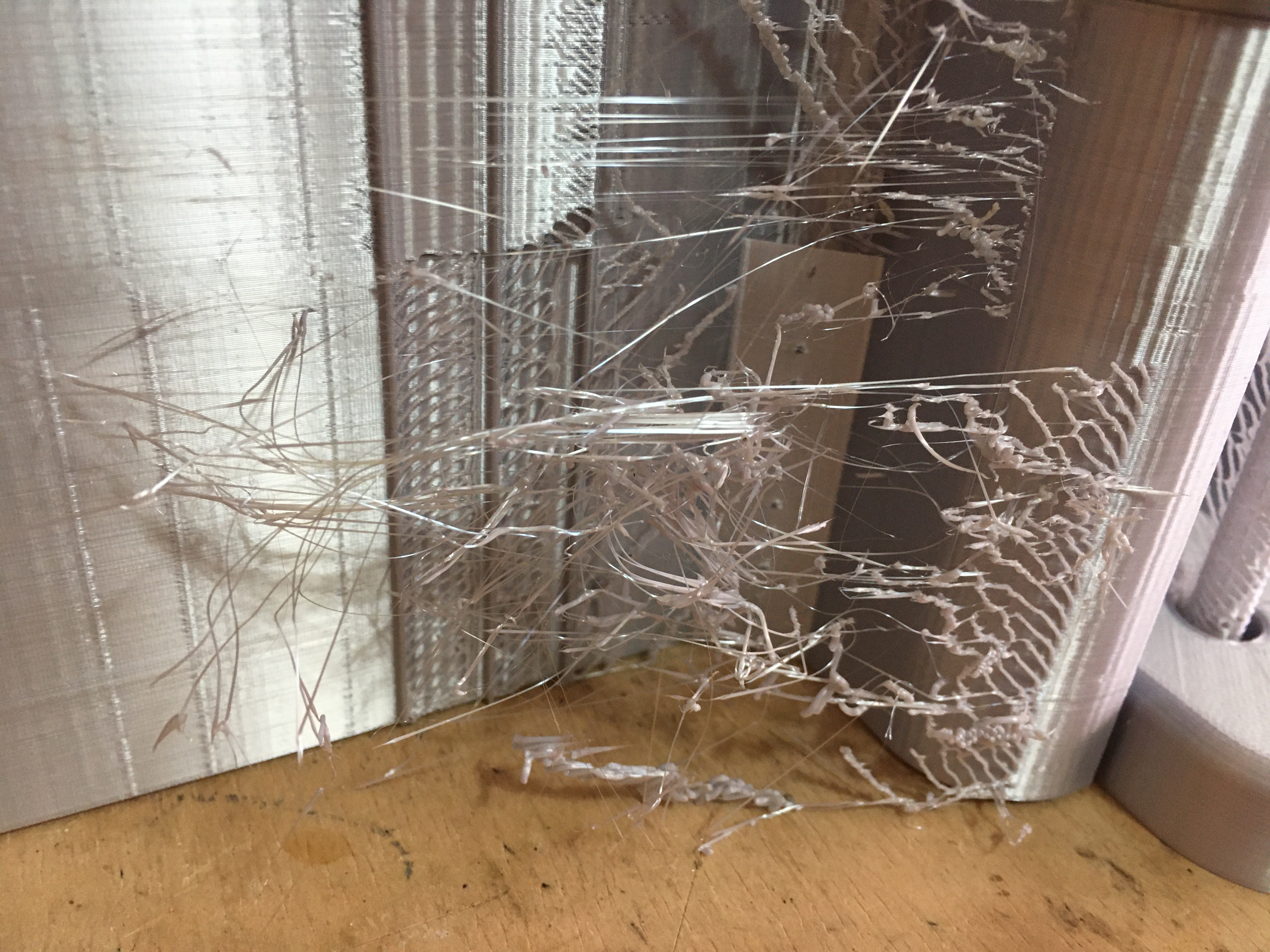

I get bad stinging on my models from time to time. The last print was very bad.
I am using Cura 4.11 but I don't think it's a version issue.
I have retraction on and set to 8.0 distance and 45.0 speed. Also supports don't get printed properly Any ideas on what I can do?

When I look over your photos, it appears that they do not have square bottoms.
This tells me that the bottom layer is not sticking in in all areas and causes the the upper layers not to have any material to adhere too.
Could you post a time lapsed video so we could watch where print looses adhesion and the stringing begins.

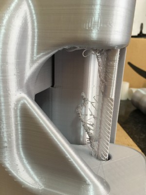

Yes I can see there is an area where there are no supports. This is just a functional print and that area is not important, I knew is would be a bit rough. It's the other areas where the stringing is bad, there should be not reason for it in the top photo. Also the round support above, bottom photo, has ended up being printed like a spiral, I am surprised it didn't colapse during printing. The same support on the other side printed OK.
The print was well stuck to the table, It took a lot of effort to free it.
The print is more or less a good strong print after I have cleaned it up.
I don't have a video of the print, sorry.

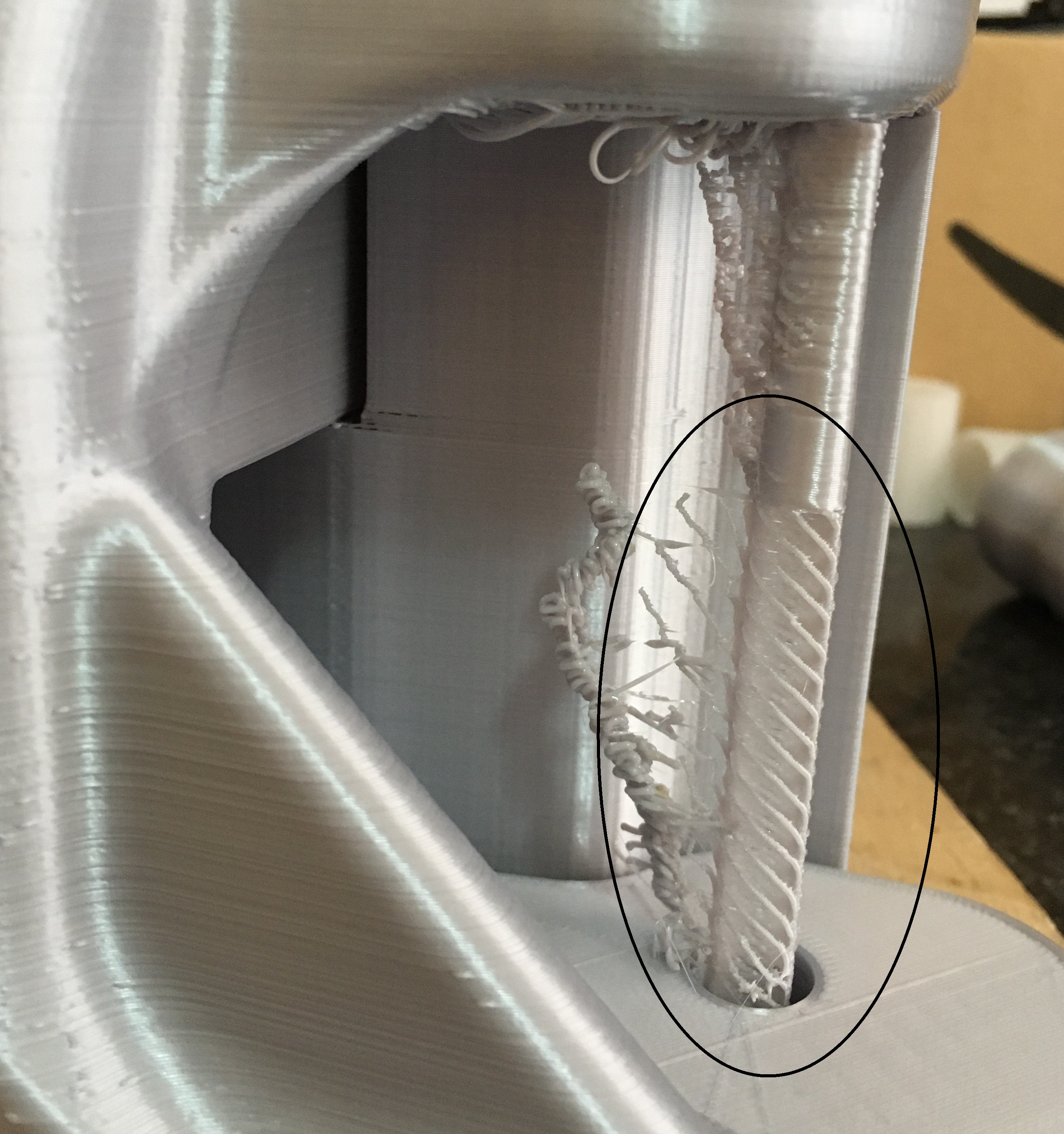

Look at this support, the bottom half has ended up as a spiral, but only on one side.
Any ideas?

Your overhang is looking a bit rough too
- Posts: 401
Re: Bad stringing
Yes the overhang is not an important feature, I know it would be a bit rough, it actuality wasn't too bad after I cleaned the print up. I am just surprised the round support managed to survive as it printed really badly.
