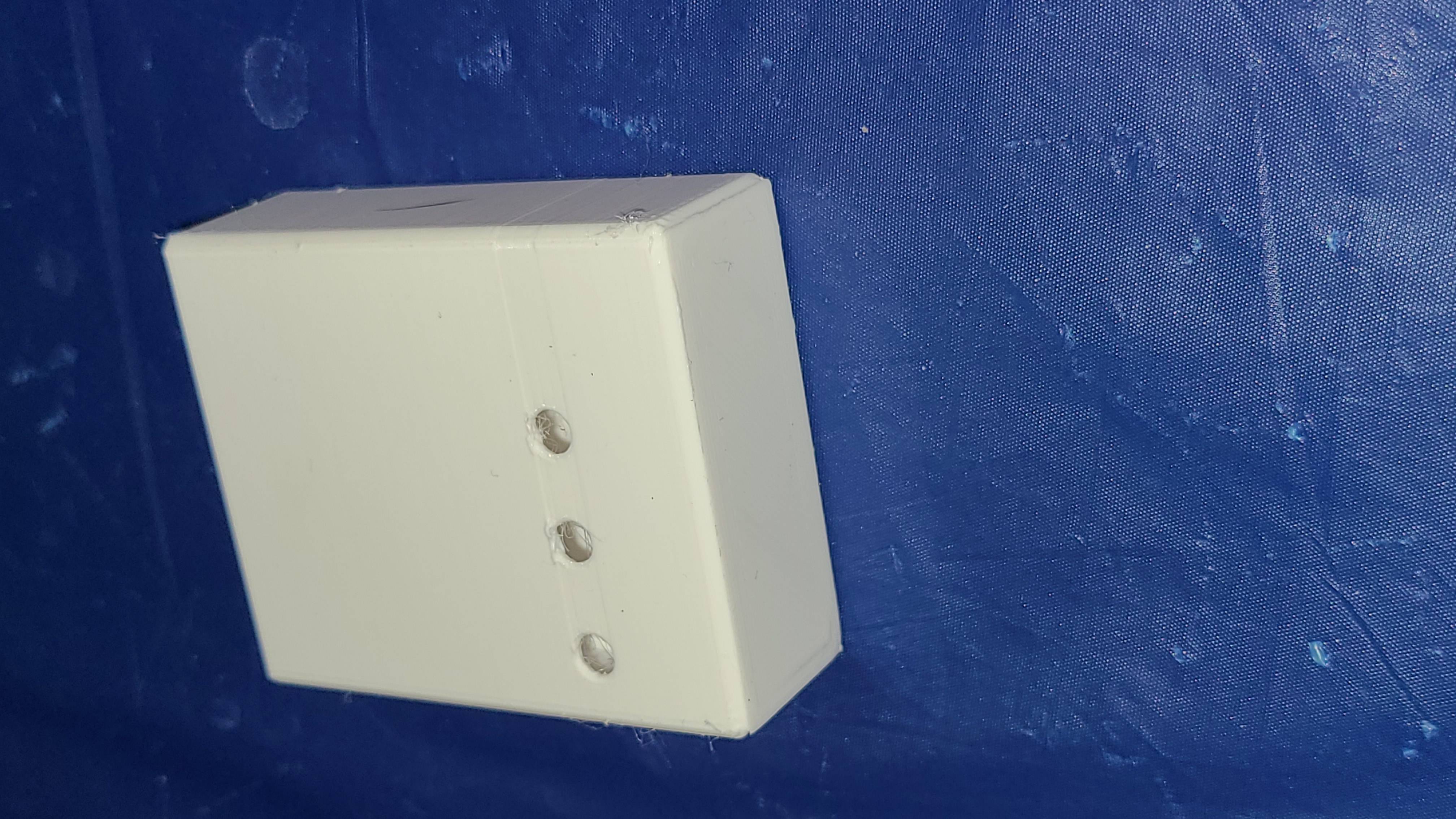

Having issues printing this model sliced with Cura. At the level the three holes, there is thinning between the holes.
Can't figure it our after trying different retraction, combing, and Z Hop settings.
Issue with printing, sliced with Cura

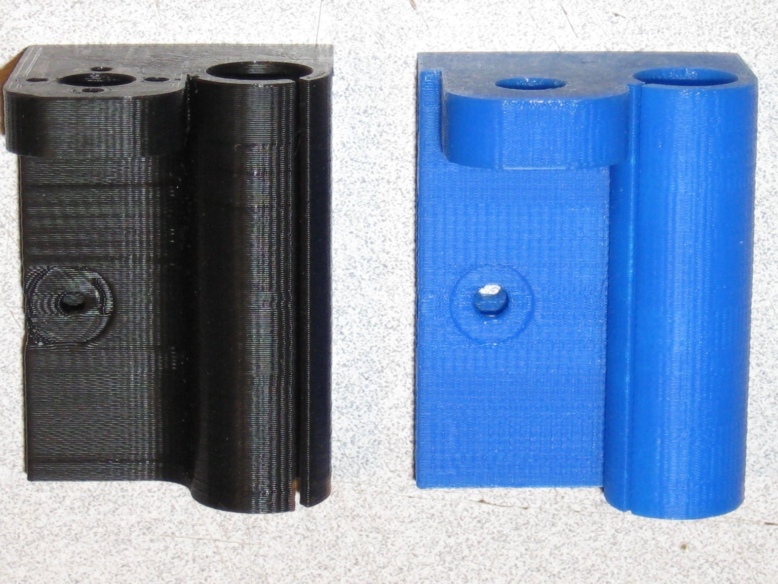

This is quite a frequent problem with Cura and happens quite often.
when any change happens on Z-Axis, could be many changes to the shape of the model, the outcome is always the same style texture surface change.
Look at this example

So, is there a resolution for this type of issue? I've been trying for months to resolve it, and nothing seems to work.
