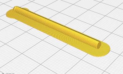

Hello Forum,
I have a small shaft I want to try printing on its side on a raft over printing vertically. When I load the STL and try to set
the parameters in Cura the top portion of the shaft is being left flat? Like it was cut off. I am using a fine layer height
and have played with the infill and layers but cannot get the top portion to print?
Please see picture attached. I can attach a file if that would help? Thanks, CismontGuy
top section of shaft is being cut off when file is sliced

Hello Forum, My line width was too large for the part. I changed it to a smaller value and the part is now complete. No idea yet whether it will print OK. Starting the print right now. To answer the question, I want the print lines to run vertically, not circumference wise for the model CismontGuy
Top portion of the round shaft now appears in Cura
