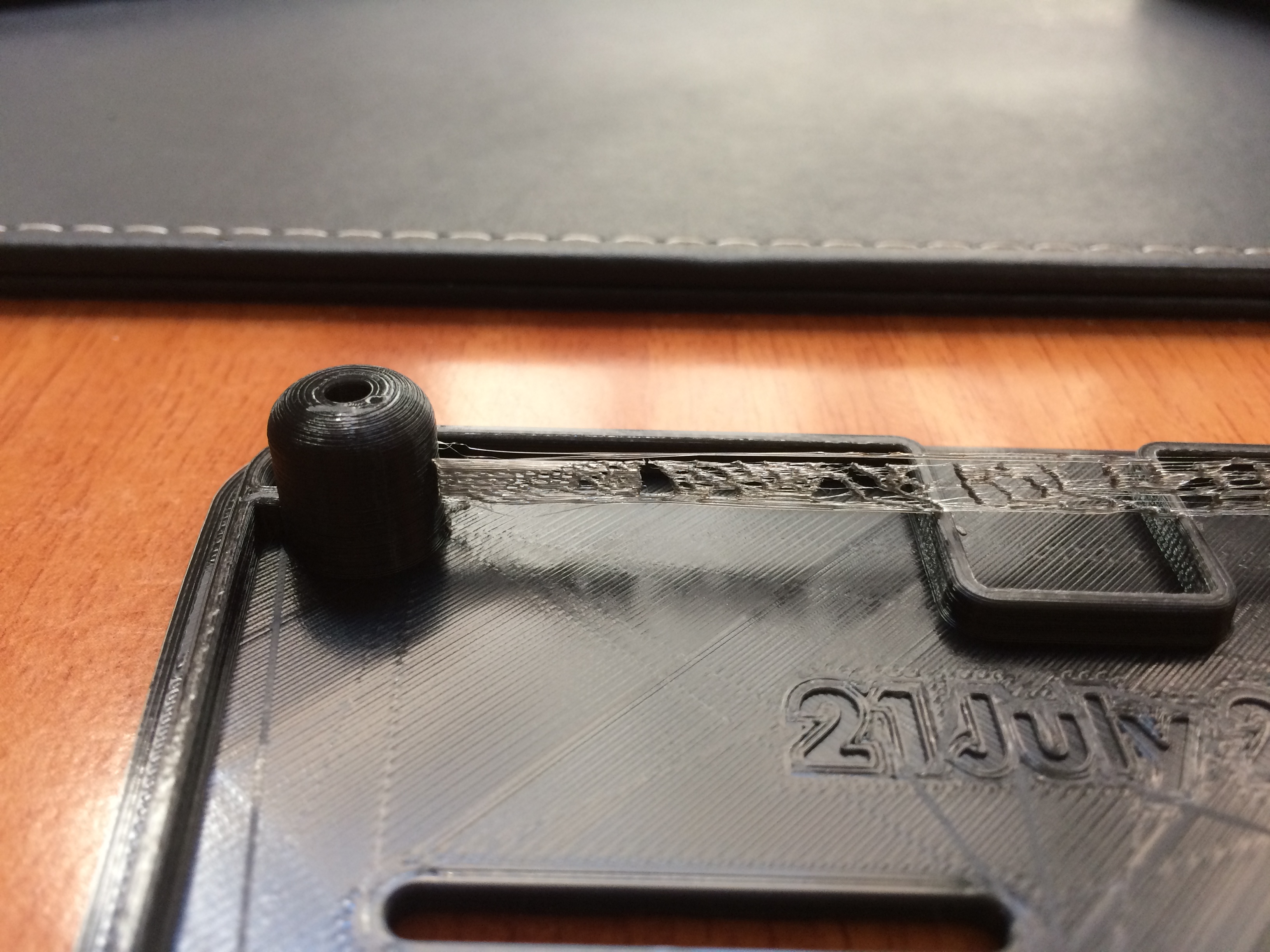

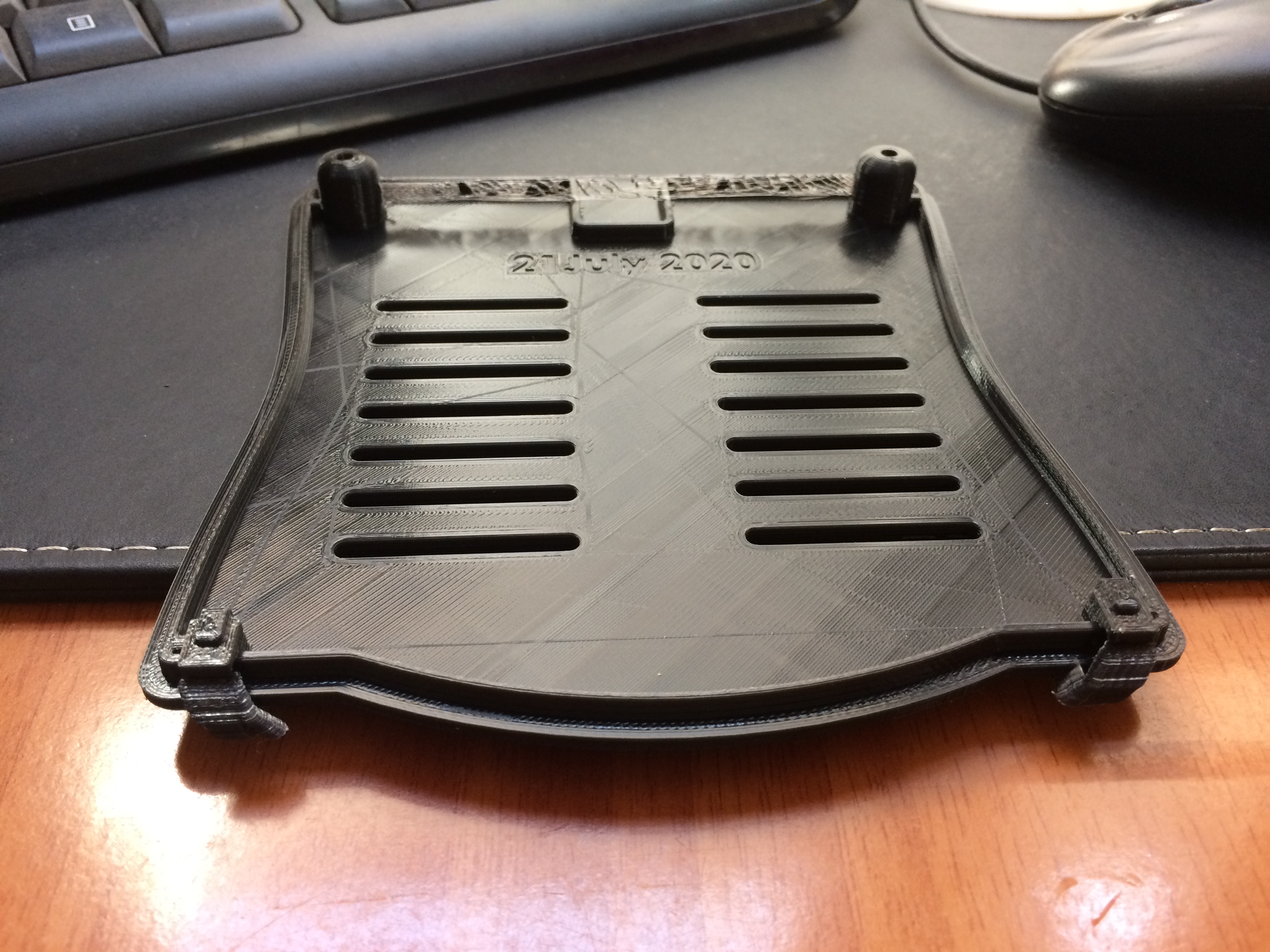

Here is a strange thing with my prints. I need to print a few copies of a part. They print OK except for what I can only describe as a spiders web, see photos. It's not a problem to cut them off, I just wondered why they are there, everything else is OK.
Very weird.
Anybody else had this?

Retraction can cause the stringing, though stringing can be caused by filament that has absorbed moisture.
Even it you set your retraction correctly a pressure caused by moisture boiling can cause a fine stringing effect.
