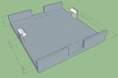

I use an Ultimate 2+ printer at a library so do my software setup offline at home. I loaded Cura but am having a hard time getting anywhere. I loaded my model (STL file) and it's very small (100mm x 100mm x 20mm) and barely shows in the display. Isn't it possible to zoom in ? (I can at the library using thier copy of Cura). And secondly, the drop down menus don't work. I did register with cura online.

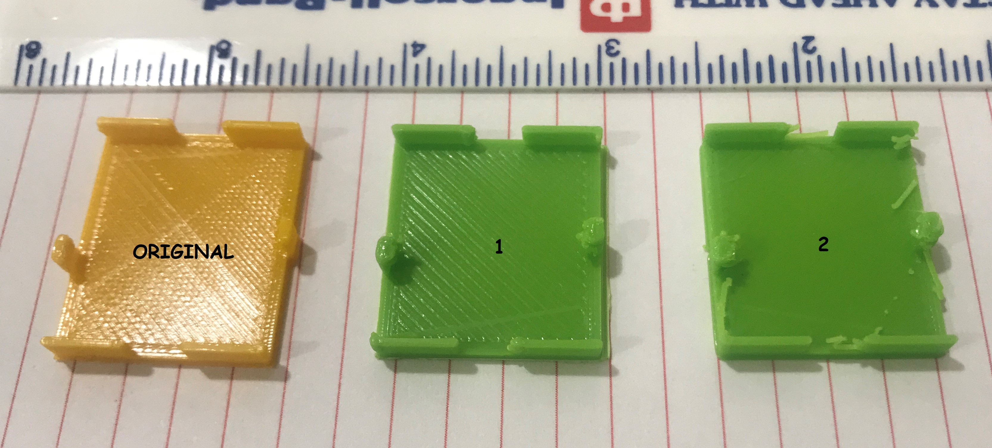

Cura 4.3.0, I believe the library is still using a prior version.
My scaling is fine, actual model size is 100x100x20mm.
Attached Photo and JPG (inch dimensions) are of item I'm attempting to print

When I print a model similar to the one you are trying to Print I enable a Parts fan at 50% speed.
In some instances printing with supports is required, I do not believe your model requires supports.
Though I have been mistaken before and will be again, as it is difficult to see the overhangs.
When you are printing less and less on the upper layers a "Minimum Layer time(sec) is needed.
