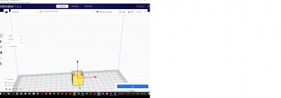

Good Day I have attached the ZIP file and I have also included a picture in CuraRoberts_Clif wrote: ↑April 21st, 2020, 4:40 pm7-Zip is a free program you can select the files to zip then attach them.

What does it look like in Cura if you select preview from the menu above the part.

I tried it looks like a solid.
Tried to convert it but seems to get Distorted in every program used...
One Slicer I used had 4 separate parts to create model and was massively oversized.
Slicer auto sized to fit then by Reducing 4 separate parts to 2% original to view and see what I had.
Outer shell of the Cube and Inter Shell of the Cube
Outer shell of the Cylinder and inter Shell of the Cylinder

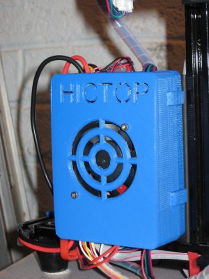

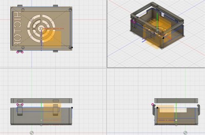

I started learning using an online Modeler called TinkerCad.
Then jumped in learning the Free for Hobbyist/Personal use Fusion 360.
Fusion 360 a great Program thou not knowing CAD, I was jumping from Fusion 360 to You-Tube Videos learning,
As I went and my first Project turned out fairly nice See Below.
So Keep plugging away you will learn to model using Sketchup

I loaded this in Cura 4.5 and messed around a bit. Initially when sliced, it had infill throughout, including the cylinder, so yes it is printing as a solid. When I dropped infill to 0%, the layers look ok until 101 where it starts covering the top.
Definitely a Sketchup issue. I had similar issues the first time I created something in OpenSCAD (which uses a scripting language to define objects).
