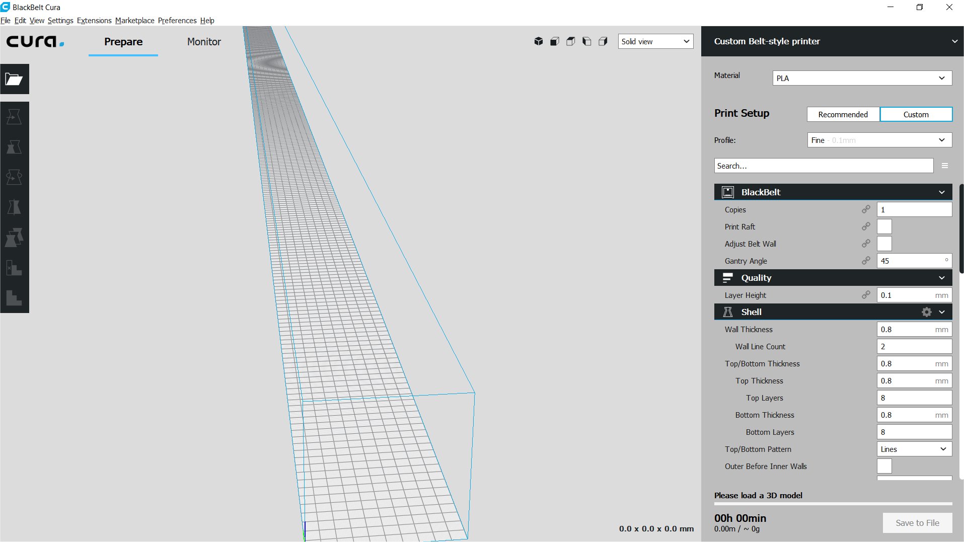

I have already watched Cura Black Belt Edition but there is the max angle of slicing together with the movement of x and z axis.

Another option it this Download Blackbelt Cura 3.6

I had see the first link, but they have also no XYZ 90°/90°/90°, more a xy 90°/90° and Z=45°
I have looked at the black belt frome cura, but I fear it is only possible for the black belt you really need a machine where the Z is 45 ° or more tilted.
It is just not possible on my cr10

Blackbelt Cura Source code is available
Though I see you can change the Gantry degree angle.
Re: slicing under a angle for normal printers
Yes, but the angle is together with xz, so you have to rebuild your machine, no 90dr
