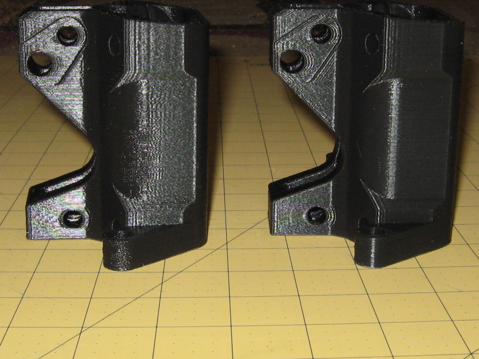

I basically had the same problems, although when I printed using Octopi I was using Octolapse.
Other than that I always print using the SD Card.
Maybe if I tried a better Power supply I could get better print results.
Octolapse vs SD card print
Material ABS - Octolapse Left vs SD Card Right.
Supply I used was for a Raspberry Pi 5volt 2.5 amp
So do you believe a better supply would make a better print.

Re: OctoPi produces weak prints
When starting a Print with 32-50% to get good bed adhesion. Then increase the speed too.
Normal print speeds from 70-100 percent in Cura = 8.0mm^3 per second to 11.0mm^3 per second.
When printing from the SD card have no problems maintaining these speeds, making great models.
When using Octolapse start getting the fuzzier finishes, still good models they just have a fuzzy finish.
