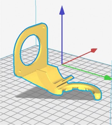

This is my Design,
You can see I added a 2 fin heat sink over the Throat, after this was done needed to vent air to the heat sink.
Re-designing and Reprinting the Duct allowing for the button head screw, now allows it to float horizontal.
Also you can see in the image my Proximity sensor hanging off the White spring loaded slide mount.

Looks a good design is the stl file avaliable?
Re: Model Fan Duct
Yes.
I have again re-designed the Hictop Extruder Duct making it better.
New Hictop extruder duct.stl
(372.05 KiB) Downloaded 1123 times
In order to best print support are requested but not required, as the sloping back gets a little rough.
I believe I left the Throat duct too long, simply sanding of cutting to fit was the last update I did.
The duct should be perfectly horizontal when installed.
More on this subject below
viewtopic.php?f=53&t=747&p=10502&hilit= ... uct#p10502
