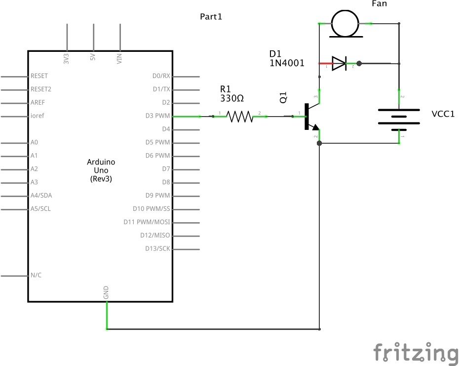

If you can give me the reference of what you have and also the Amp rating of your fan, I can check if it will work and which resistor we need...
You probably need a flyback diode as well (1N400x or whatever) unless the transistor has one builtin.

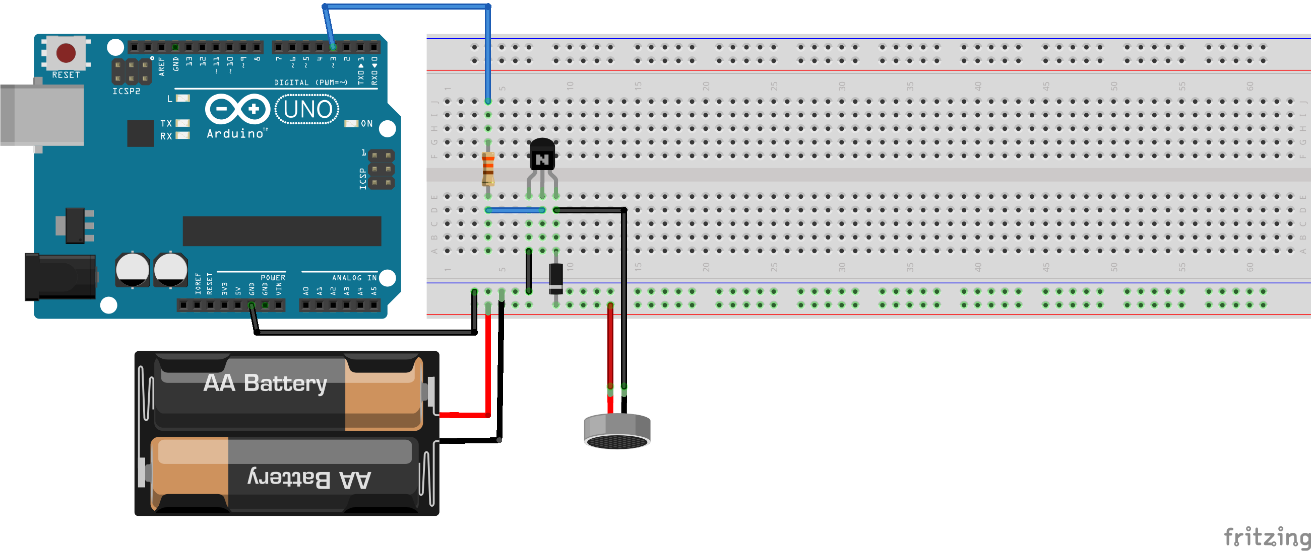

You are all set
So you need something like this: For the transistor & diode, use what you have.
For the resistor, to be safe use 2 330 Ohms in series.
That gives us on the breadboard Now, be careful with the transistor, you need the minus on the emitter and the fan/diode on the collector side (I find the drawing confusing)
Batteries are your 12V battery

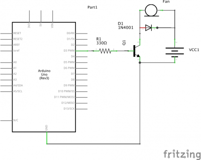

Sketch in next episode
