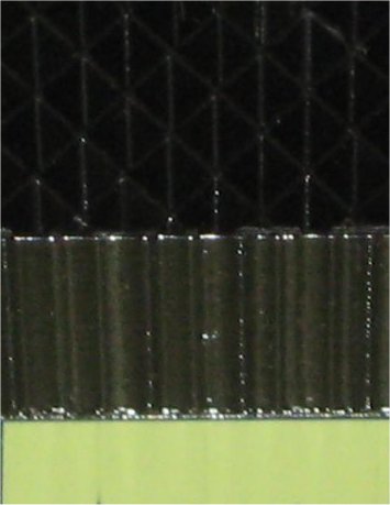

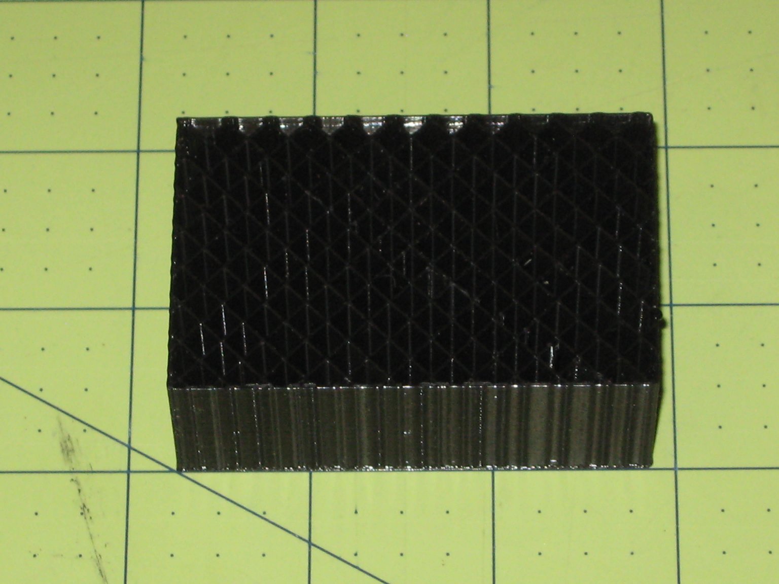

I believe My percentage of infill is causing the wavy edges. As you can see the edge bulges where the Infill intersects with the External walls.

I am thinking that the infill extends beyond the exterior walls.
What is a good number for Infill Overlap, currently Infill Overlap (%) 15
Should I select "Infill prints after Perimeters" check box.

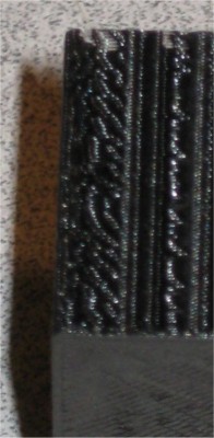

2nd Note:
The Starting Corner is under-extruding filament up to the second Infill line. This has only happened on this model

I have printed many models with a higher infill and never seen the wavy lines.
I read a article here.
This basically say an Infill Overlap of less than 15% can solve the problem. or that I should increase the Shell thickness from .8 to 1.2mm
Have not tried this as I only needed the one print model at this time.
I will most likely change the numbers on the next model.
Then can see if the lower Infill Overlap of 10% and a 1.2mm Shell thickness help smooth the outer walls with other models

Well I printed for Christmas S Hooks using the new settings, and there was a notable difference.
Would not have believed that the outer walls could be so smooth.
I will have to update all my layer heights profiles with the these new settings and re-post the curaprofile's and the ini files for older Cura versions.
Noting that there is a viewable difference in the outer wall smoothness.
