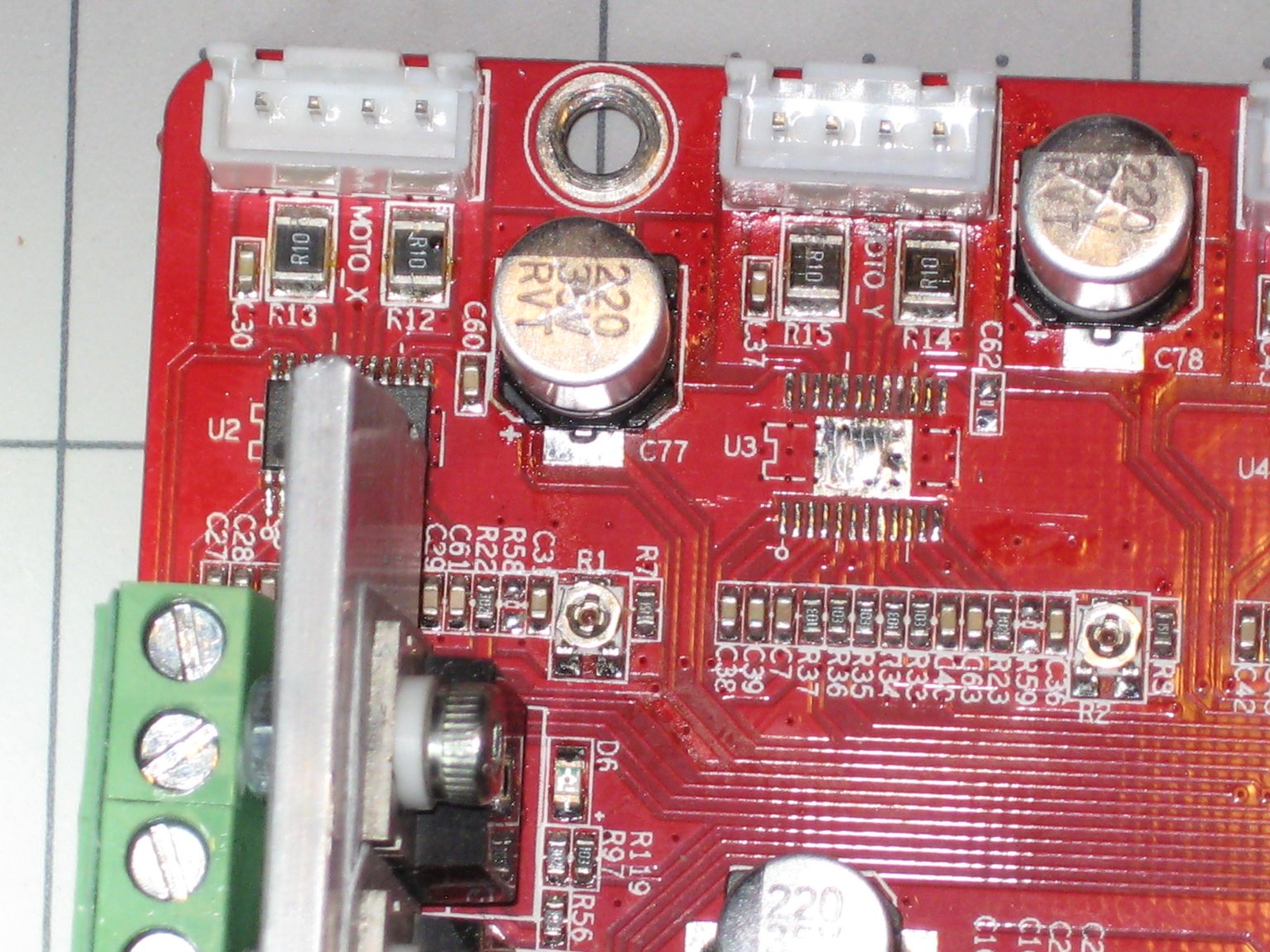

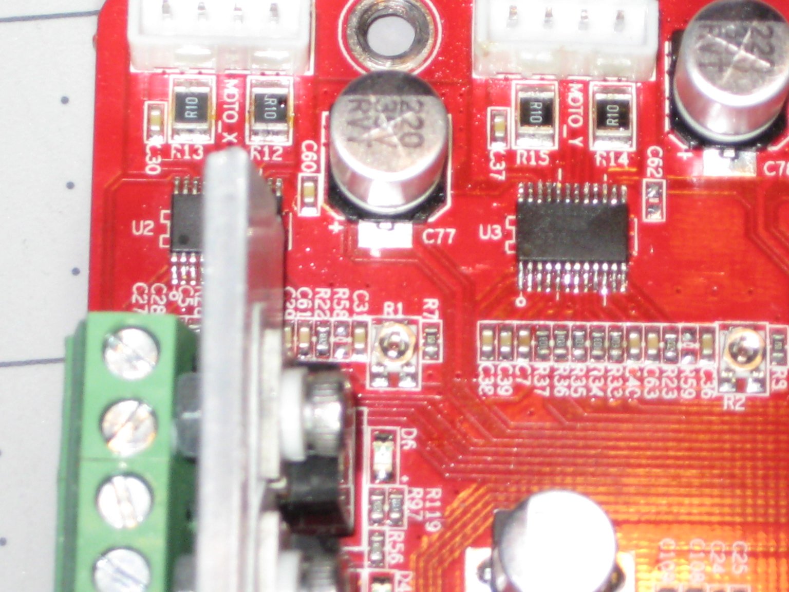

- Posts: 1381
Re: A4982SLPT compatable A4988 Driver
I removed the A4982SLPT driver Chip and replaced with a new A4982SLPT chip.
Images attached.
The stepper motor moves 1 step and then locks up on first controller the other no movement.
The chip went in without any complications showing I can still solder small components.
Will have to dig deeper into the circuit to see what else has been damaged.
Rs1 and Rs2 showing .1 ohm looking through the magnifying lens I see that there is heat damage to the X-Axis chip even though it still works.
The Mega2560 outputs could have sustained damage from the Power supply when it blew.
This project is going to be looked at when I get a chance to drag out the Oscilloscope.
My new 1 meg portable digital scope Kit can see the signals from the Steppers. Now just need time
Images attached.
