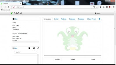

If I open OctoPrint using fire fox it work perfectly when I close and try to re-Open OctoPrint I get the following Screen:
You may also note that the Connection tab on the left is also missing
This look perfectly normal though no matter what you do OctoPrint just is not responding.

Narrowing it down Clearing "Cashed Web content" allows for Reloading OctoPrint.
Problem is caused by improperly shutting down OctoPrint using X In Windows corner...

This is correct! The login screen never appears. Not even login on the Right menu tab works.
Believe that the cached content holds a corrupted connection link that was left in memory from using Window X to close Octoprint.
Nothing I do will allow the connection except clearing the cached content, Then reloading the web IP address brings up OctoPrint correctly.
And do not believe it is an OctoPrint but a FireFox Error.
