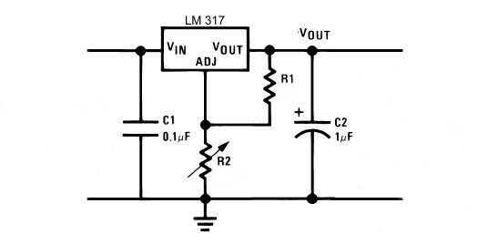

Now before turning on power to the 3D Printer a few tests, disconnecting the controller power lead I will test the Led's dimming controller circuit.
This is simply a LM317 variable 12v power supply circuit I designed for the 24 Volt supply to dim the 3D Printer frames led.
This is working as designed. Now unplug and reconnect the Controller supply power wire.

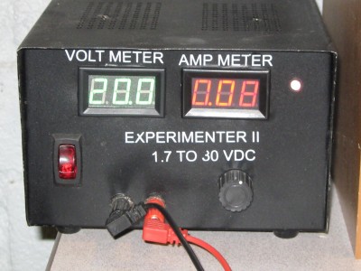

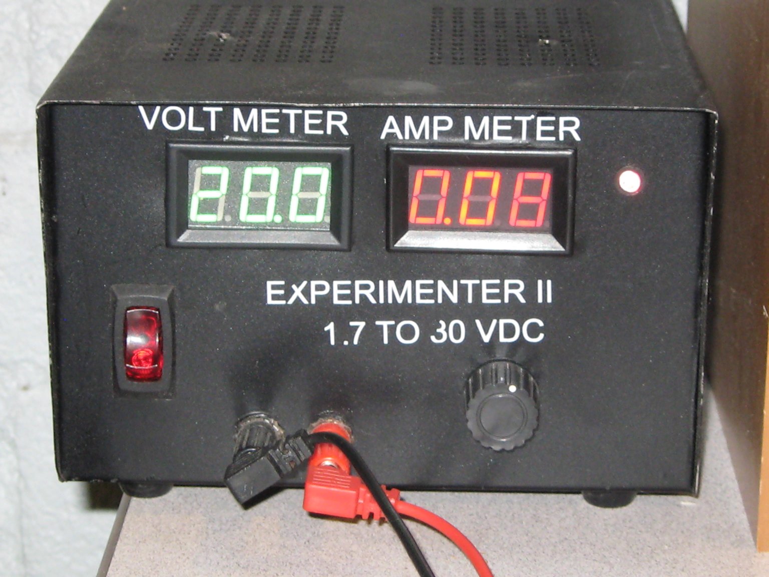

Connecting the controller to my home made 0~30 volt 10 amp supply will adjust the voltage up slowly to see if the current spikes.
20.0 volts .08 amps this is good an means no shorts. All test to the controller says it was ready to be powered on.
So with all hand ready for the worst power switch to the on postilion and the printer is back to life.
