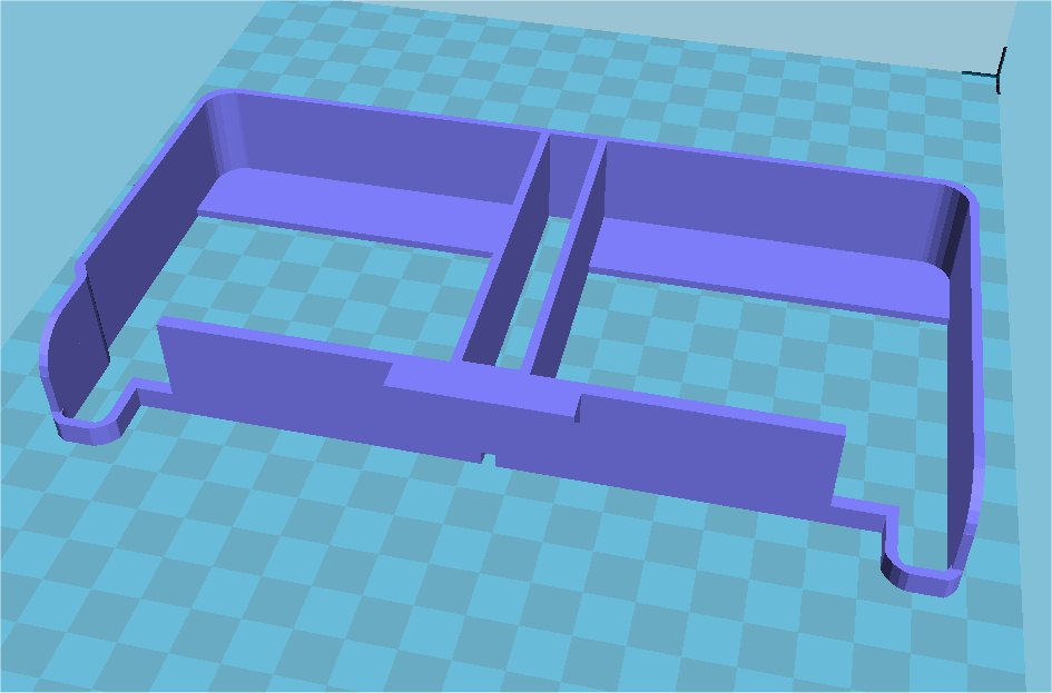

Not sure how many are still using VHS Tape Players, since I repair, clean and do transfers of Video from VHS to Digital data.
Making CD, DVD and Blu-Ray backups of the older Media I have a need for a VHS Tape Frame.
So I have Made this frame and putting it up for anyone who whats to download.
This Skeleton frame of a VHS tape that will allow you to make adjustments to your VHS player/Recorder without the VHS tape getting in the way.
It is designed so it can only be inserted into the Player/Recorder only one direction.
Front is As Shown in the Image below, the notch in the center bottom is a key to allow this side in only.
This should be printed in clear to make it as translucent as possible.

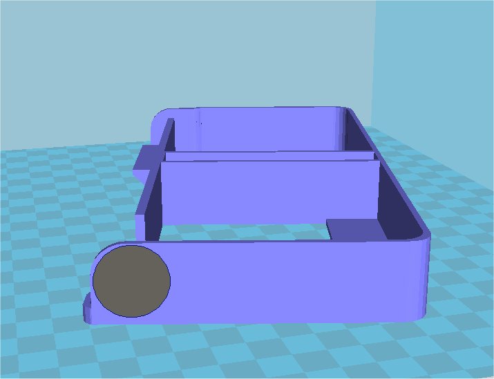

Being translucent the inferred emitters will shine thru so a Dark Black Dot is taped to front of both sides as shown in the following image.
This will defeat the Broke Tape Sensors. .
