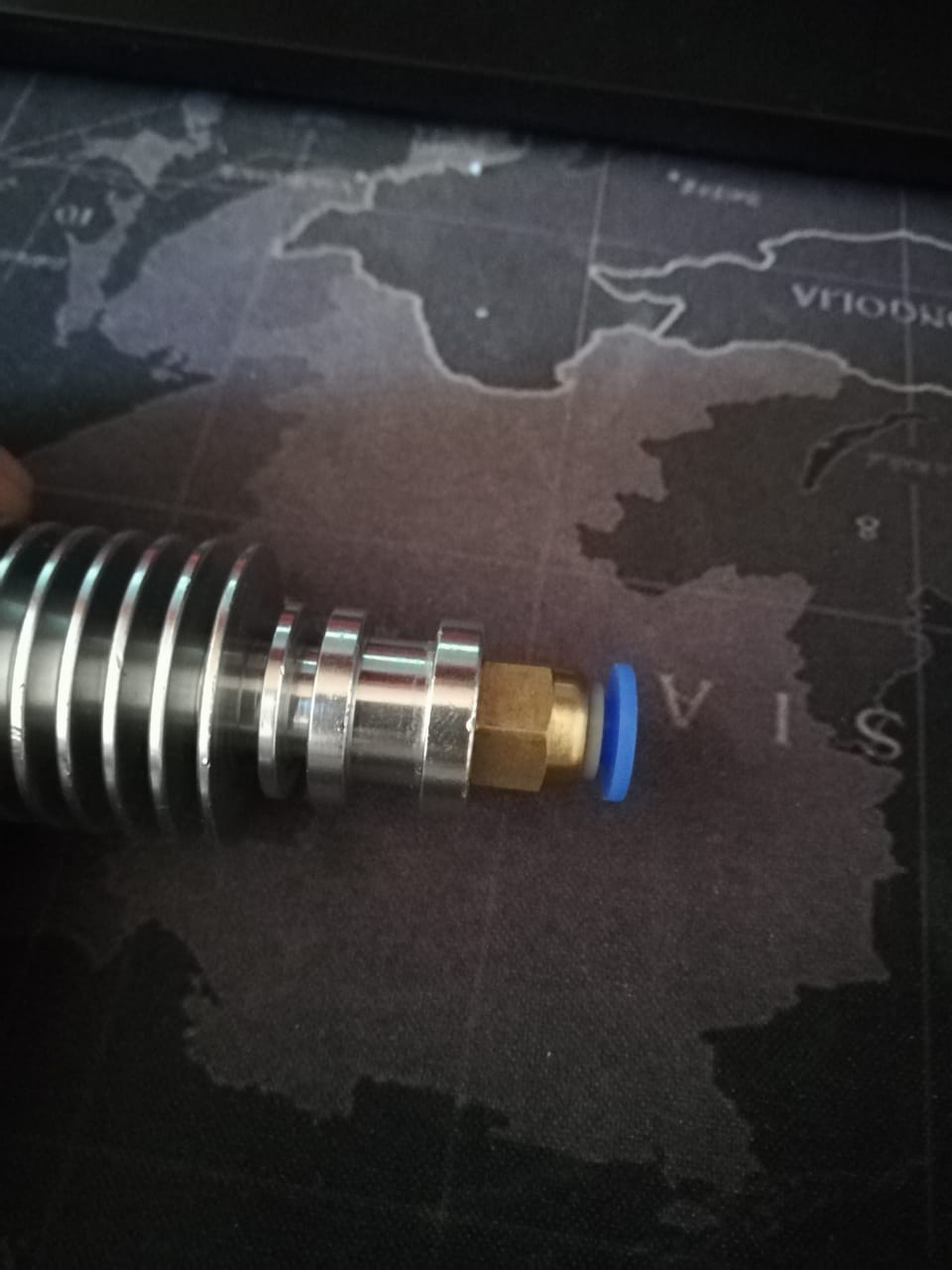

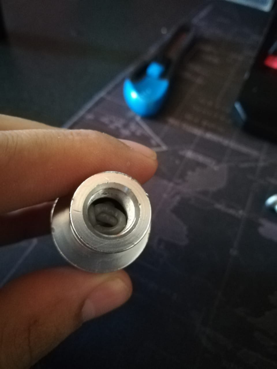

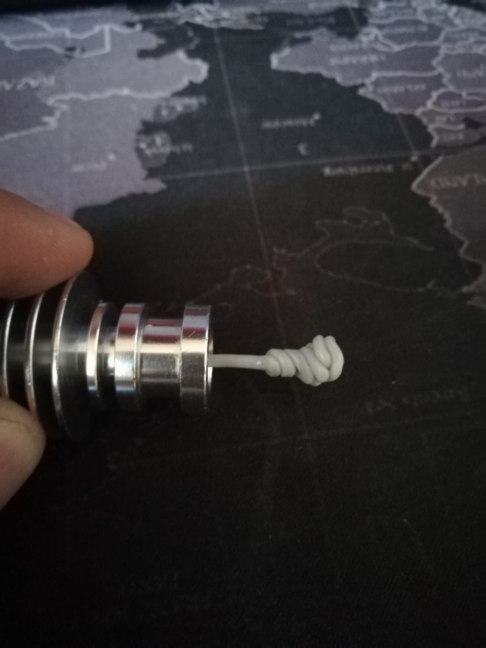

so i bought a new heat sink but i don't know how it has a gap and the filament just get jam, did i bought the wrong tipe or am I making something wrong? you can see the heatsink and the clogged.

What hot end/heat sink package is that....or is this stock with your printer (which is?)
Re: help me new extruder heat sink gap

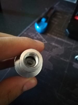

i'm not really sure what you mean, but i bought the printer and it have a heat sink like that so i bought exactly the sameone but it has that wierd gap tbh i don't know what is going on haha, i put a photo of the default extruder and heatsink
- Posts: 401
I think they should be a plastic tube in there.
- Posts: 3970
Yeah, like a PTFE liner or something
