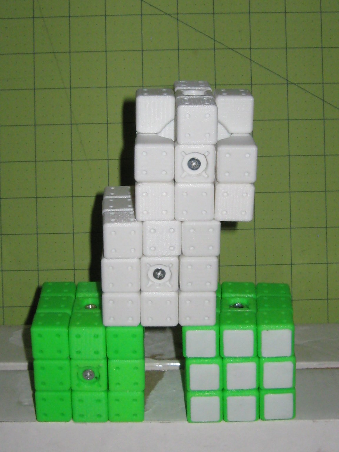

Just having fun right now. Today Printing for the local Hospice Cancer Center, finishing up on a group of Rubix Cubes and Fidgets they can have to occupy there time with while recovering from Chemotherapy.

Re: Controller Freezes
Cool! How smoothly do they turn? Can you share the stl's?
- Posts: 1381
They actually work better that any cheap Clone Rubix but not a good as the real Rubix.
Only takes 12 hours to print all the pieces.(6 because I have two Printers)
