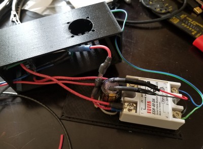

Everything wired up, before I screwed the enclosure shut. I put some hot glue around the top of the capacitor to make sure the leads are insulated.
All closed up and working Firmware update
