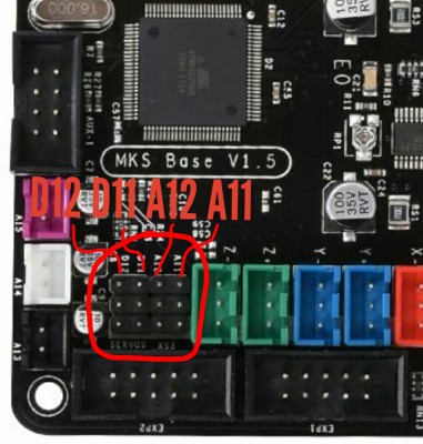

Have any of you had success getting an automatic shutdown mod working? I mean with either adding an M81 to your end print script or adding a relay like this one I purchased that gets triggered using another pin on the board.
I want to do this to my 3DP-03 but it lacks a PS_ON pin. I was wondering if anyone knows if this can be done using one of the pins illustrated below in conjunction with M42. I'm pretty sure the D pins are outputs, but I think I read somewhere that the A pins are inputs.
This isn't my board but the pins I'm referring to are the same. I have a BLTouch on D11.
Any help/input is appreciated.

I enabled PINS_DEBUGGING in the firmware and changed POWER_SUPPLY to 1 and M43 (Debug Pins) says that pin 12 (D12 in picture) is PS_ON, so it looks like it can be done!
The top pin should be signal, below it 5v, bottom GND. Like so:
Code: Select all
Digital output    Analog input
│ D12 │ D11 │ A12 │ A11 │
│ GND │ GND │ GND │ GND │
│ 5V  │ 5V  │ 5V  │ 5V  │
When I get home I'll hook up my scope to verify that M80/M81 cause D12 to send a HIGH or LOW signal, then I can start wiring it up! 8-)
Does anyone else with a different model number Hictop have the same set of pins on their board?

Right now I just have my BLTouch hooked up to D11 and the -Z endstop, like this
My hope is that I can use D12 for triggering a relay.

It works! If I send M81 D12 reads 5v, if I send M80 it reads 0v.

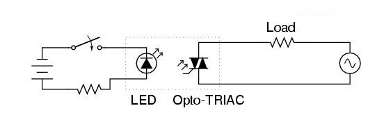

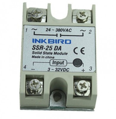

Solid State AC Relays Using Triacs instead of a mechanical relay would be my first choice.
A photo-traic gives you optical Isolation from the 120vac source uses low current and will last almost forever.
G3MB-202P Solid State Relay Module Input 5V DC Output 240V AC 2A SSR USA
Solid State Relay Heat Sink SSR-25DA 25A "$5.00 on E-Bay"

That's the one I got (different brand from Amazon, same design), linked in the first post 8-)
