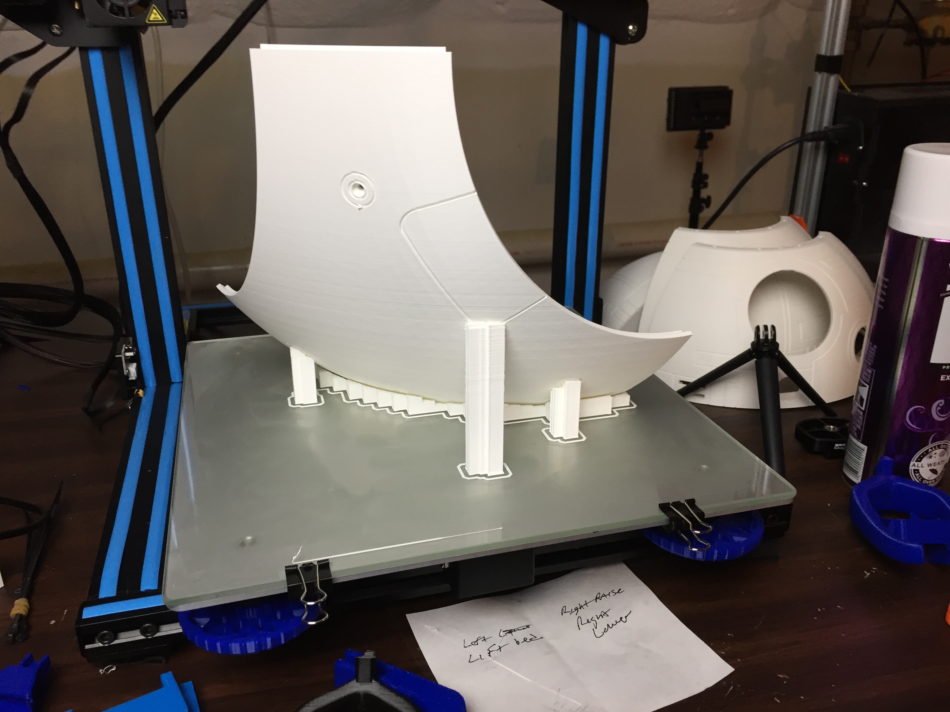

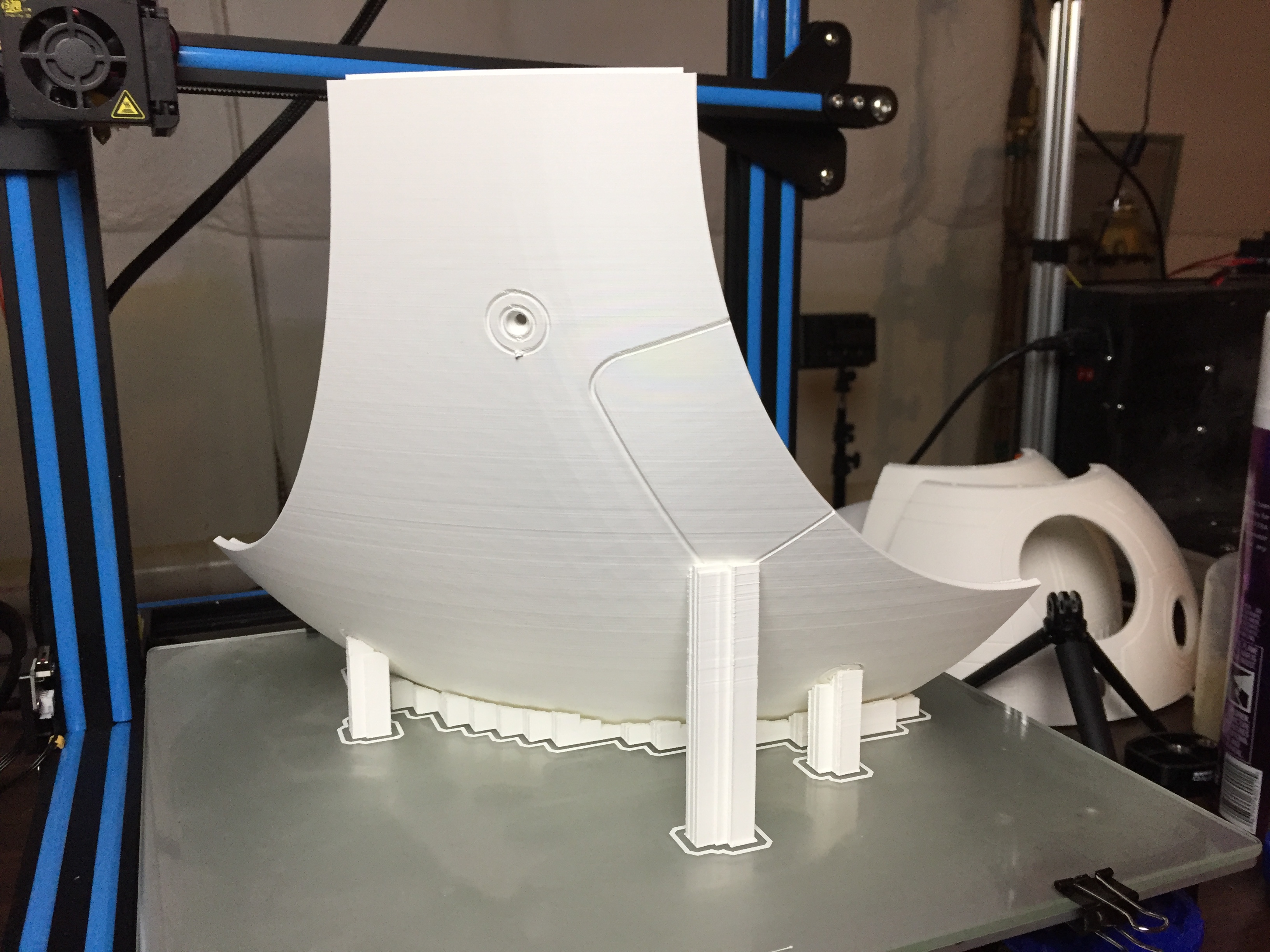

The body "triangle" pieces of BB-8's body are now being printed.... here's the first of 8 I have to do for the first droid.
These came out superb, no issues! 0.2 mm layer height, 40% infill for strength and using PLA.
(I've been back and forth on using different materials for the body shell, concerned about heat causing things to deform. Since the PLA transition temp is 65C, and I do not see this droid ever left sitting in a hot vehicle, I am fine with PLA. Other materials have shrinkage/warping issues that concern me. I also know the stock hot end on the CR-10 may/may not work with them very well.)
Here's the results...
Success! Very large print!

Re: Success! Very large print!
Very nice! How long did this one take?
- Posts: 3982
30 hours
