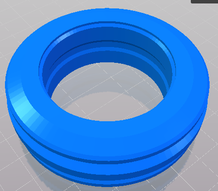

It starts to curve up after a while like greentec...but even more aggressively...at most I think I got into layer 8 or so before it started to come off. Some tests it started already on layer 2-3.
And yes, i'm pretty sure I enabled Bed PID when I built the FW. Its a custom build...but I used Amedee's builder on my local server to do it.
This is the object i'm trying to print...it's roughly 8cm in diameter...so minimum layer time should not be an issue. I'm using as little fan as possible, or no fan, to get good layer adhesion and that part seems to be ok. It's just that I can't get it to reliably stick to the bed. And Colorfabb insists that BuildTak should be used.

Gave up experimenting and bought a Buildtak sheet following Colorfabb's recommendation. Zero issues with bed adhesion...I had to take the plate off and put it in the oven for a while and gently use a thin kitchen knife to pry the tires off the bed
