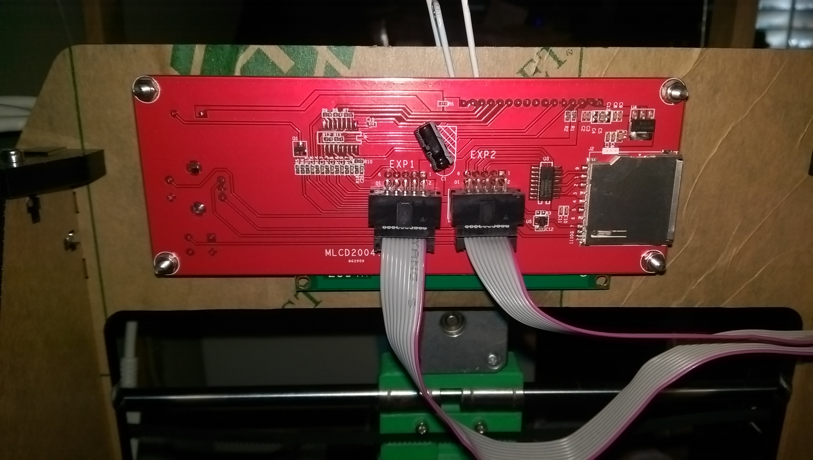

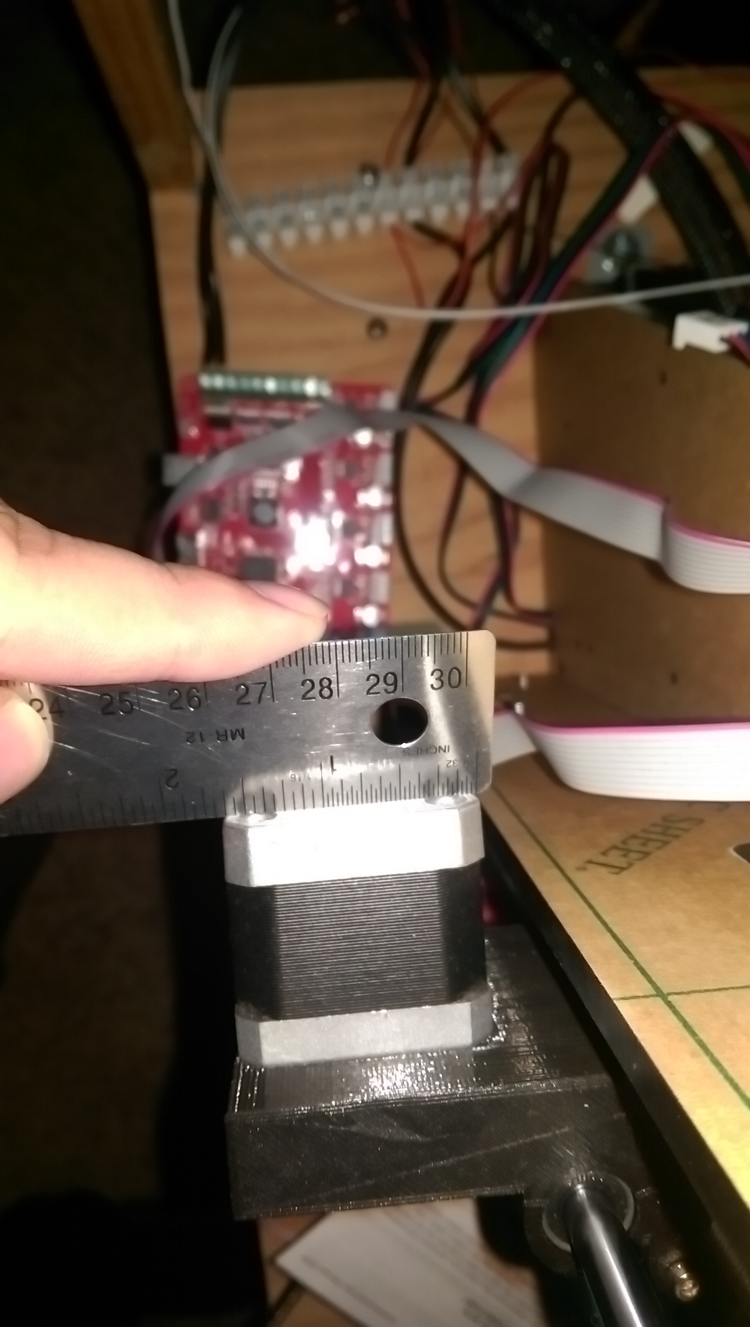

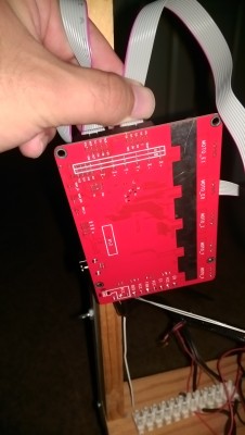

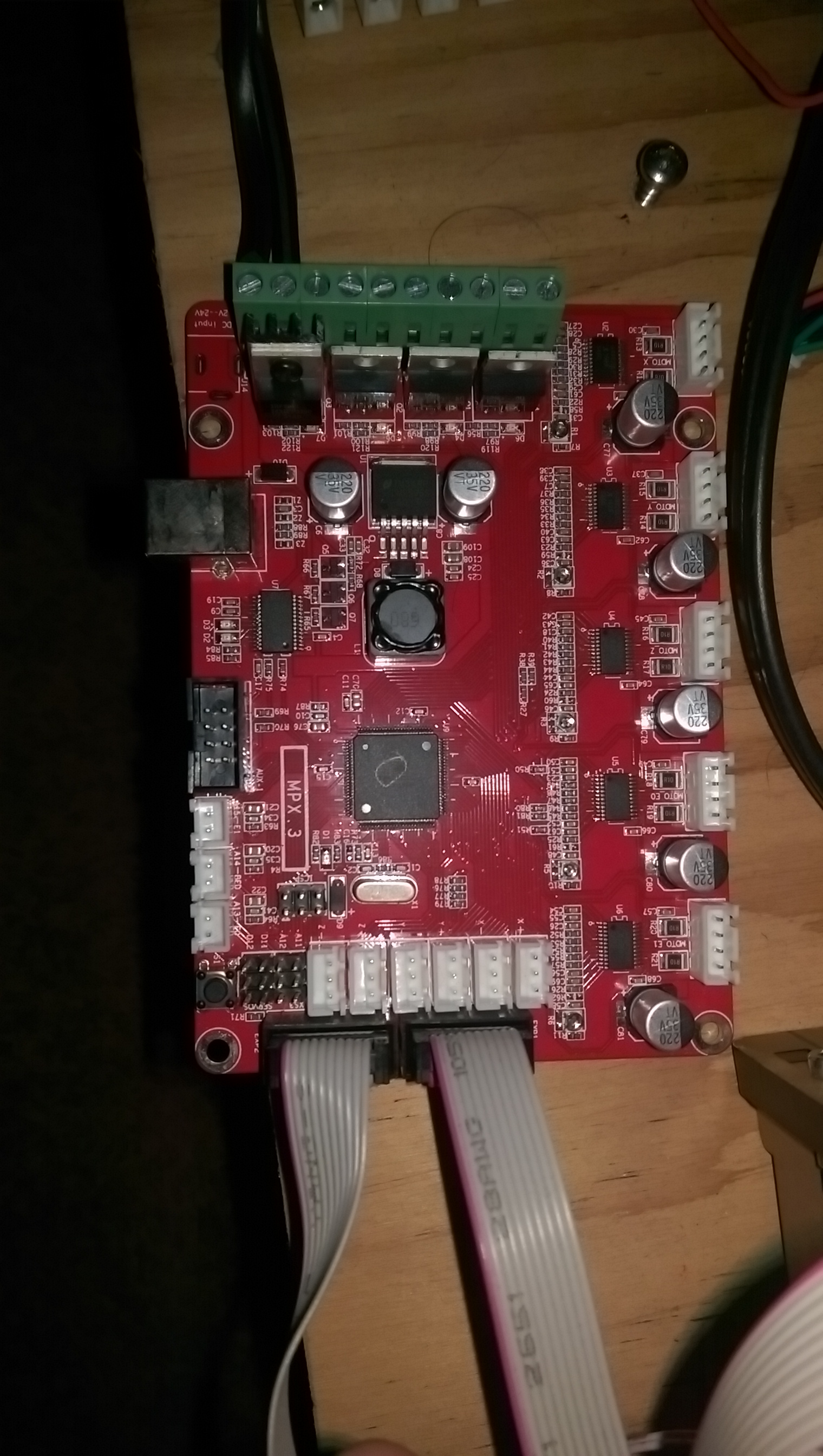

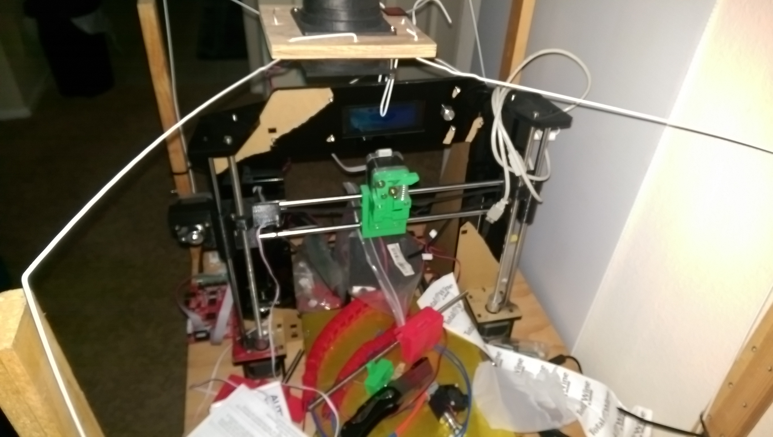

Hello everyone,
My current problem is finding the original firmware for my board after attempting a botched upgrade to my Z-axis screws and hot end upgrade (mainly the screws).
Background on how I got here: for around 6-8 months in 2016 I ran my printer without any major hardware modifications; mostly it was smaller hardware that were changed here and there. After researching more into hot ends and printing accuracy - along with aging hardware on the printer itself - I wanted to expand my material range with a E3D v6 upgrade and the smoother threaded guide rods for the Z-axis. In the time I was trying to test the screw upgrade, the code I uploaded for the modified screw travel ended up not working and the LCD stopped showing any sign of life - aka no characters showing. I've tried to upload a normal Marlin code, but that still did not work.
Jumping forward to today,I have assembled the old Z screws back into place. I have looked again to see if the CD that came with the printer had the original coding (which did not....) and then tried several other codes for the Hictop from this forum, but alas this printer is still stuck in a coma. During this attempt, the LCD screen would turn on the backlight, but no characters would show. After a few more seconds, the LCD would flash on and off several times before completely going dark; no rotary sound either when I try to use the display navigation. I also swapped the cables but didn't fix it. Only recently did I shoot a request to the HIC email for the original code but so far have not received a response.
Below is a small clip of the LCD screen turning on and off:
https://youtu.be/rA9kzQUa99w
Below are the links I have tried several codes to get mines to work but ended up not doing anything better:
At this point I am at the end of my best abilities to get my 3DP-08 working. Are there any suggestions that I might be able to go by to get this thing up and running again?
Below are some pictures of the Motors, new hot end, LCD, and controller board:

1. Make sure you have the LCD hooked up properly.
2. The LCD isn't critical for the function. Plug into a PC to see if you can connect and use slicing software to see if you still have motor controls (jogging, homing, etc.)
3. Your LCD and/or controller may be bad. Replace them.

Re: Hictop 3DP-08: Firmware not working properly
GrueMaster wrote: ↑June 22nd, 2017, 9:46 am Try this link: https://www.hic3dprinter.com/pages/firmware. It shows the firmware for the 3DP08-3DP11. Not sure if it works with the Z screws your kit came with though (at one point, they switched everything to leadscrews apparently).
Thank GrueMaster, that code worked, though it was just to test the screen. I will attempt to see how fast it moves, hopefully it's preset with the new lead screw code since that was my intentions from the beginning.
