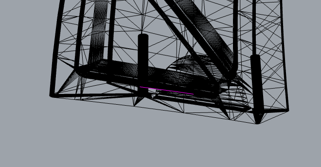

Re: Ultimaker 2+ feeder re-assembly!
Your Model is not watertight. (purple edge)
This »should« be corrected by the slicer, but you never know. The strangest issues arise from minor file defects like this
