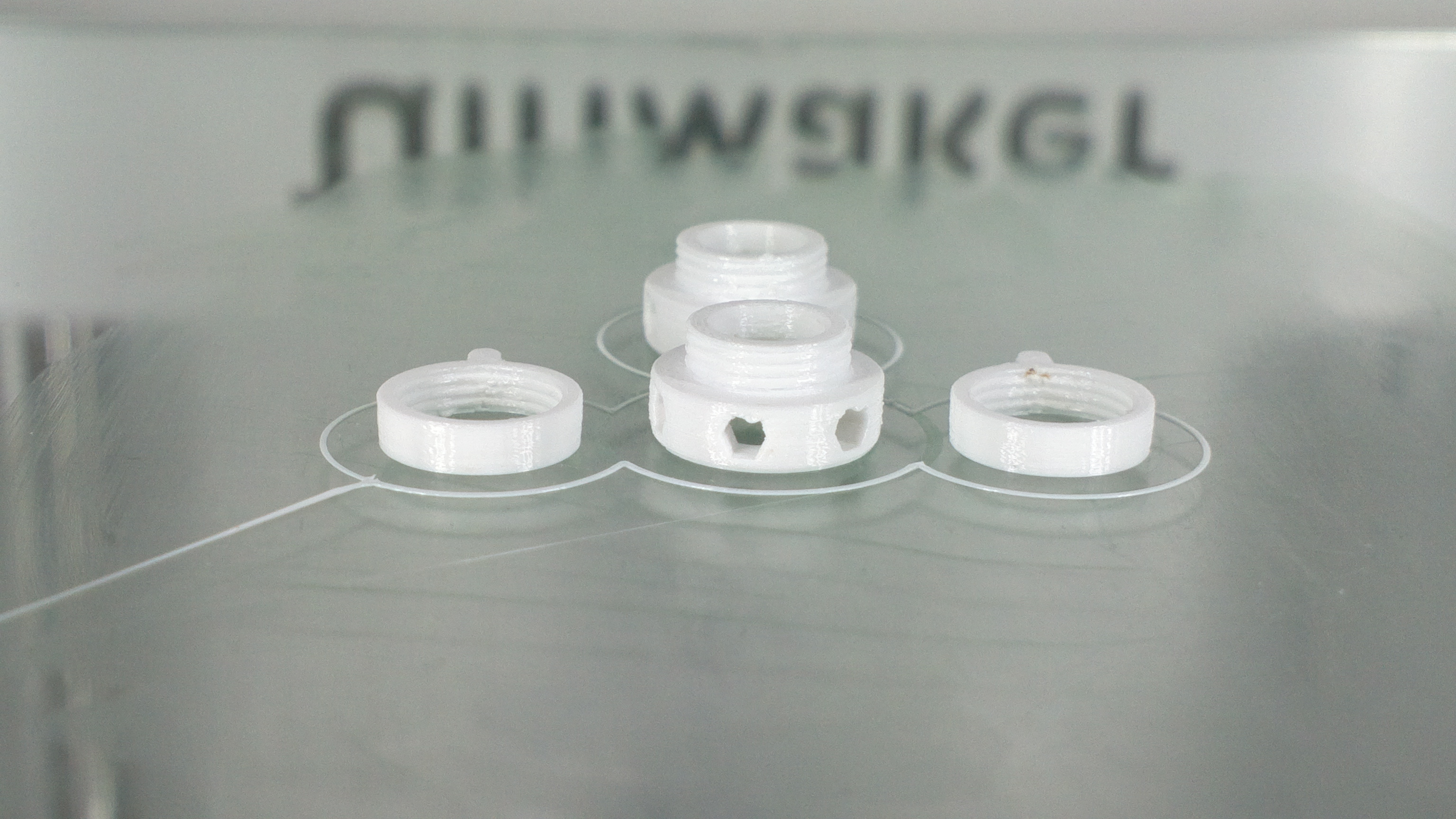

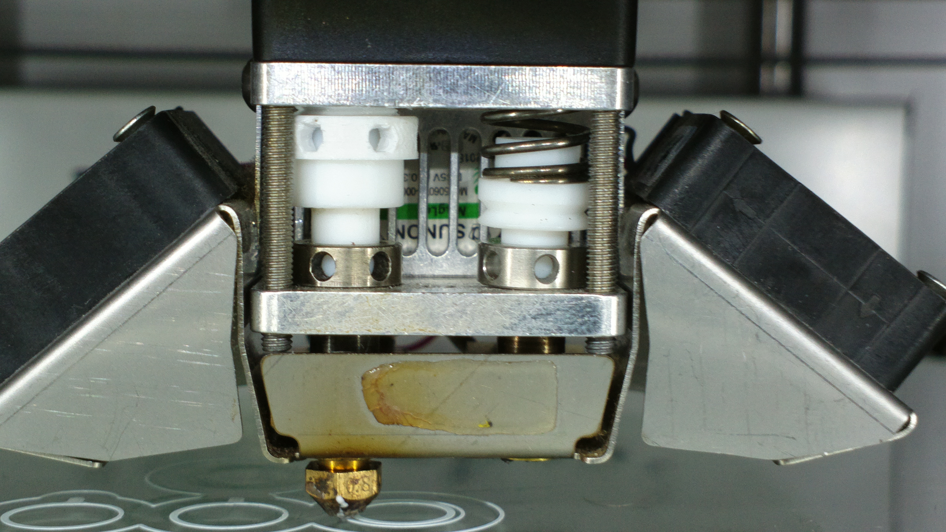

When reading about the solid spacers in this thread yesterday I just could not resist attempting to design a printable, adjustable spacer
It just felt like it should be possible and it would allow me to play with dual printing without the springs.
Mentioned it to Neotko in a PM and said I would post a picture here: It is certainly still a beta version, this one particularly designed for the I2K, but it appears to have survived at least a few hours of printing
Re: PTFE coupler - Theory and practical details
That's quite brilliant anders, also allows the player to test the preassure without having to dissasemble. I'll wait for a printabe beta since my um2 chinaclone it's about to arrive.

Yes. but a fixed spacer does not compensate for thermal expansion like a spring do
