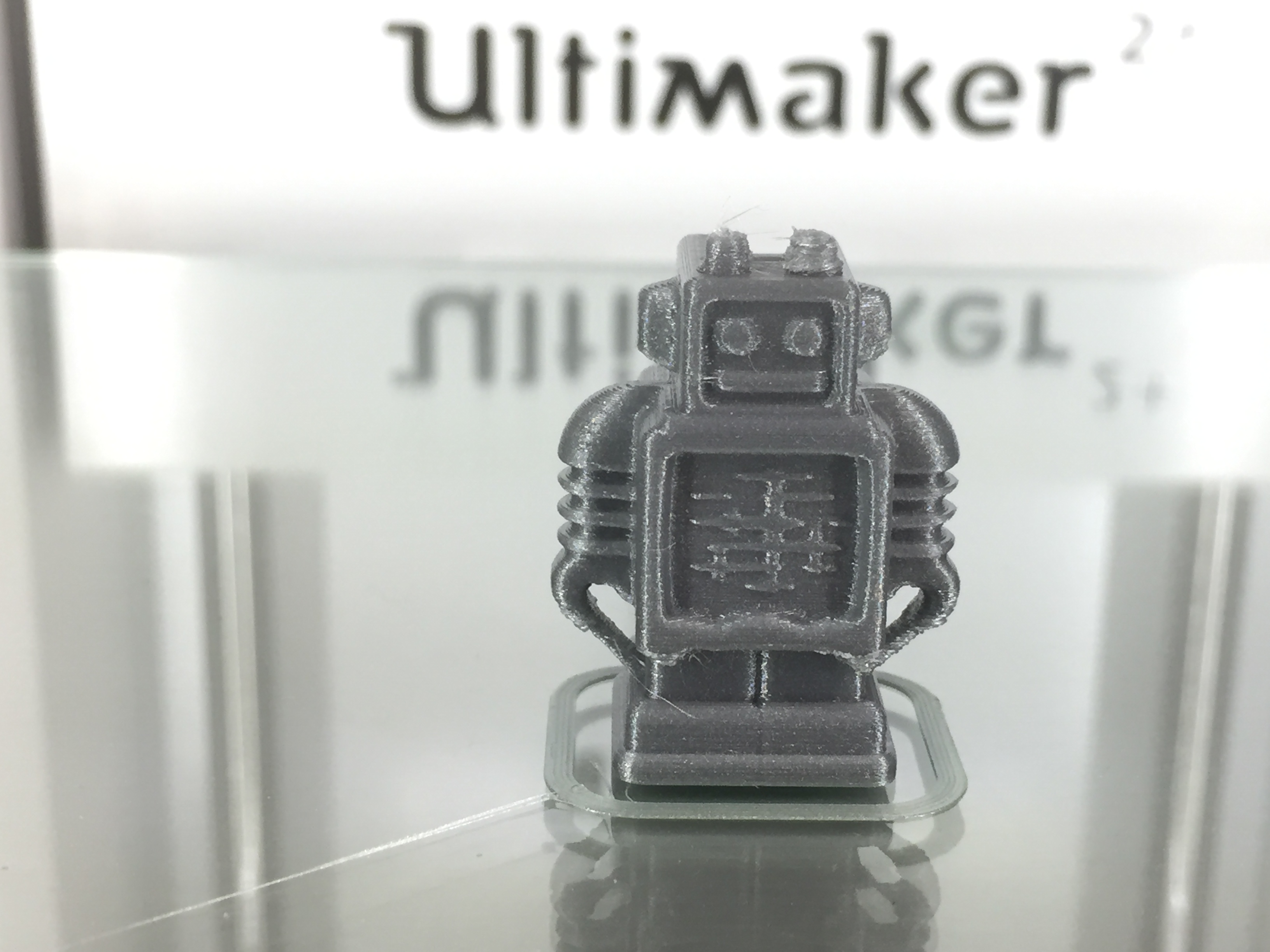

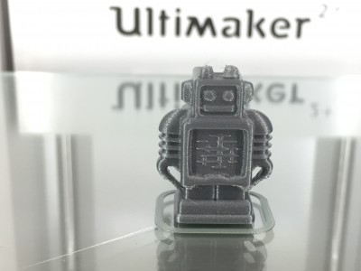

Edited the MATERIAL.TXT file and used 230C for nozzle, 80C for bed and 50% fan. I also used their 45 mm/sex retract speed and 4.5 mm distance
Trying a robot print with nGen. You can see it looks good so far. And you can hear the retractions at work
Posts: 3055
Post by LePaul » November 5th, 2016, 9:26 pm
I think I like nGen after all

Nice Paul! It's such a shame you keep running into troubles. But that is a sweet looking ultibot. Just the cooling of the right antenna seems to be off, but overhangs are sweet!
