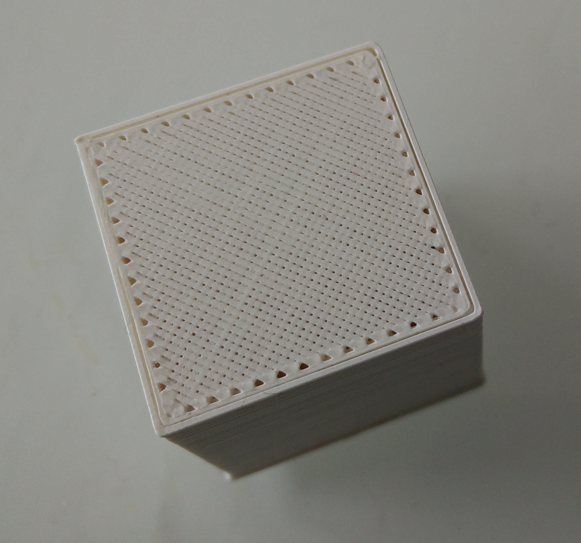

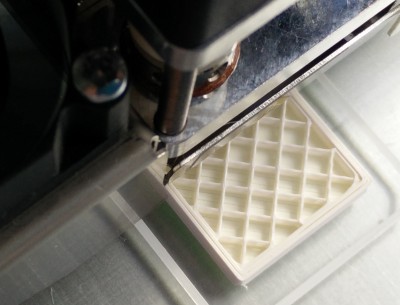

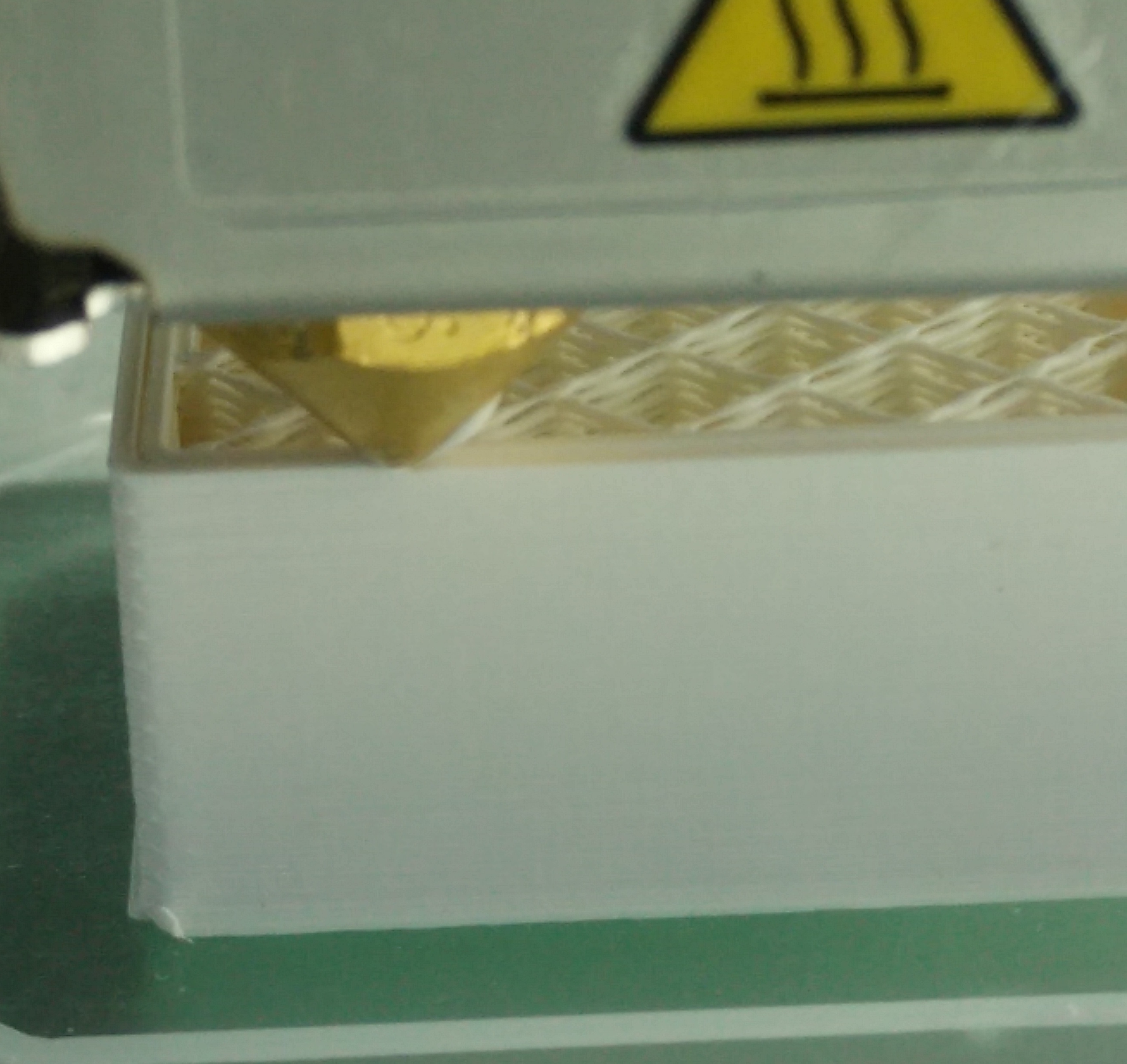

So just upgraded the printer... Took longer than expected due to the incompatibility with UltiArjans' rail system that I had installed. Had to complete remove that as well. The fans definitely make less noise, especially the "hot end always on"-one.
I do seem to have an underextrusion problem now.
The walls are no longer touching and if you look at the infil... very nice bridging but that is not the intention... The e-steps got reset to 282 when I upgraded the firmware, but if memory serves that is also the original UM2 value, shouldn't it be different?

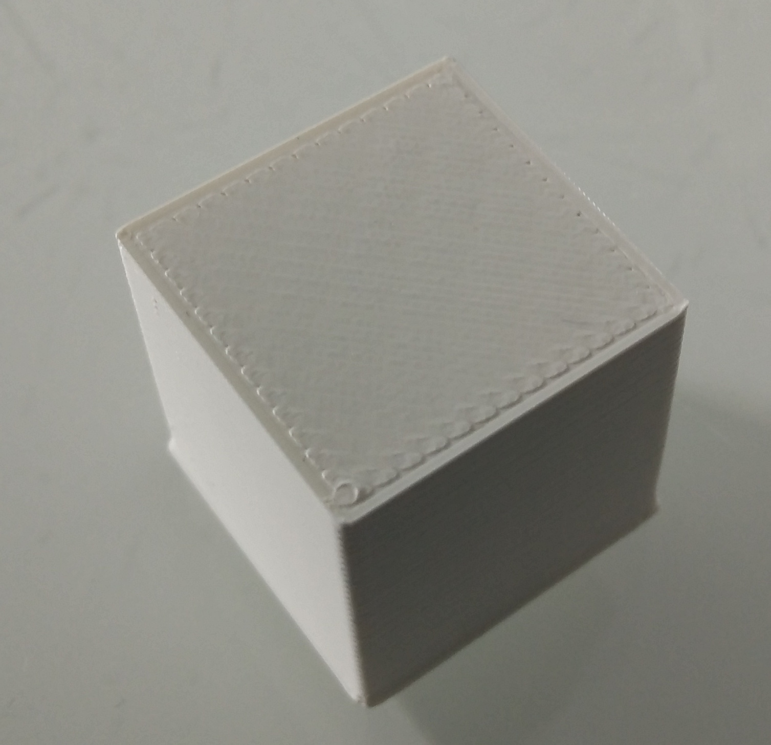

FYI, The end result:

It looks a lot better now:
That appeared to be the issue indeed. So 369 is the value to use. I guess it defaults to what is mentioned in the `Configure.h` if you don't have a value stored for it in the eeprom (or however the firmware saves its settings).

And yes, that looks a lot better than your earlier picture
