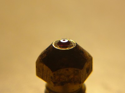

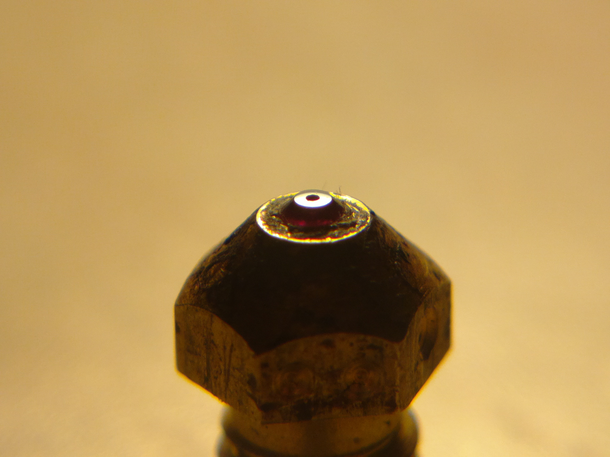

Blizz wrote:So what was the hole diameter on those? A regular 0.4mm or is it 0.5?
These (red) ones are 0.4 mm.

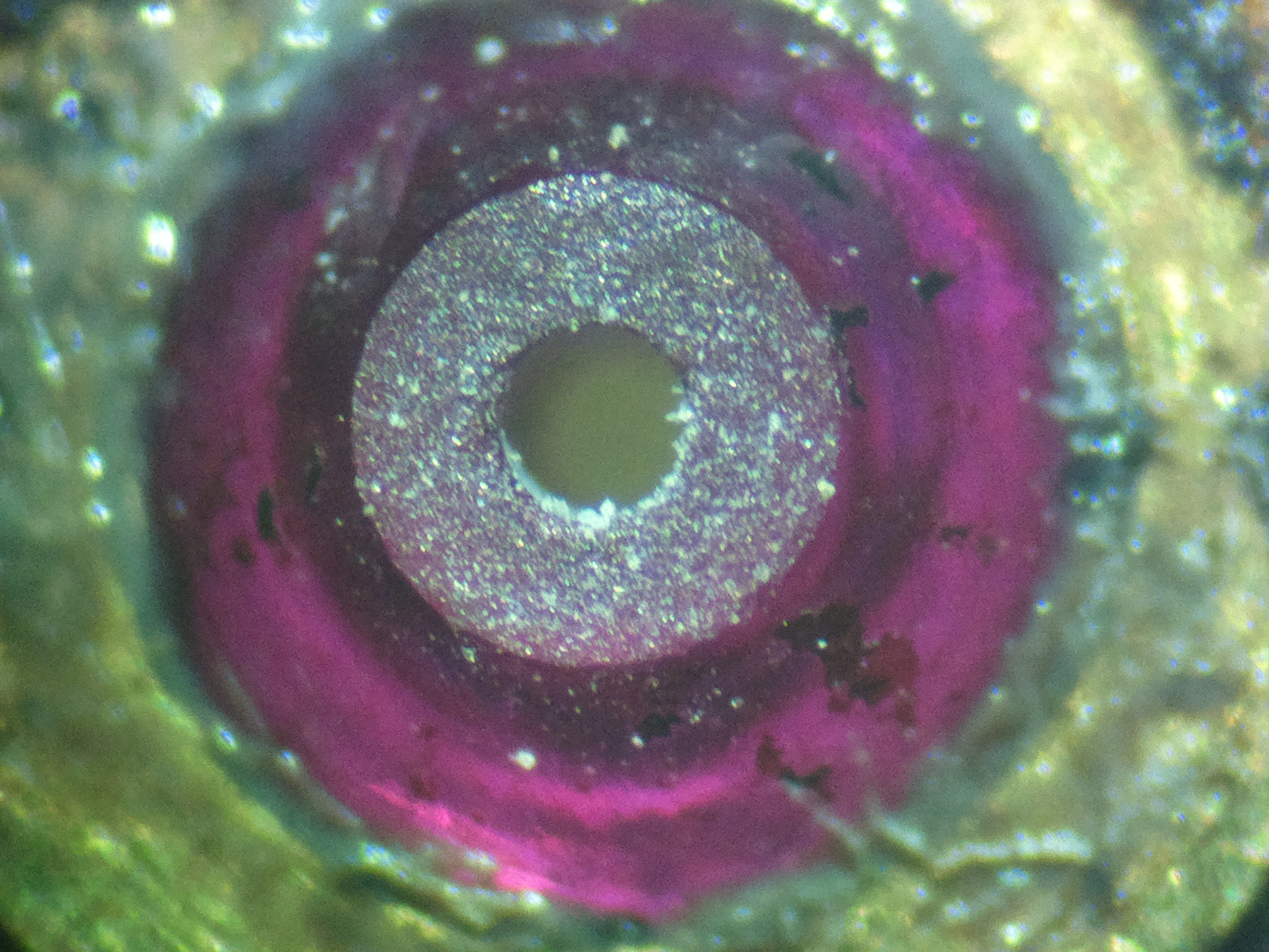

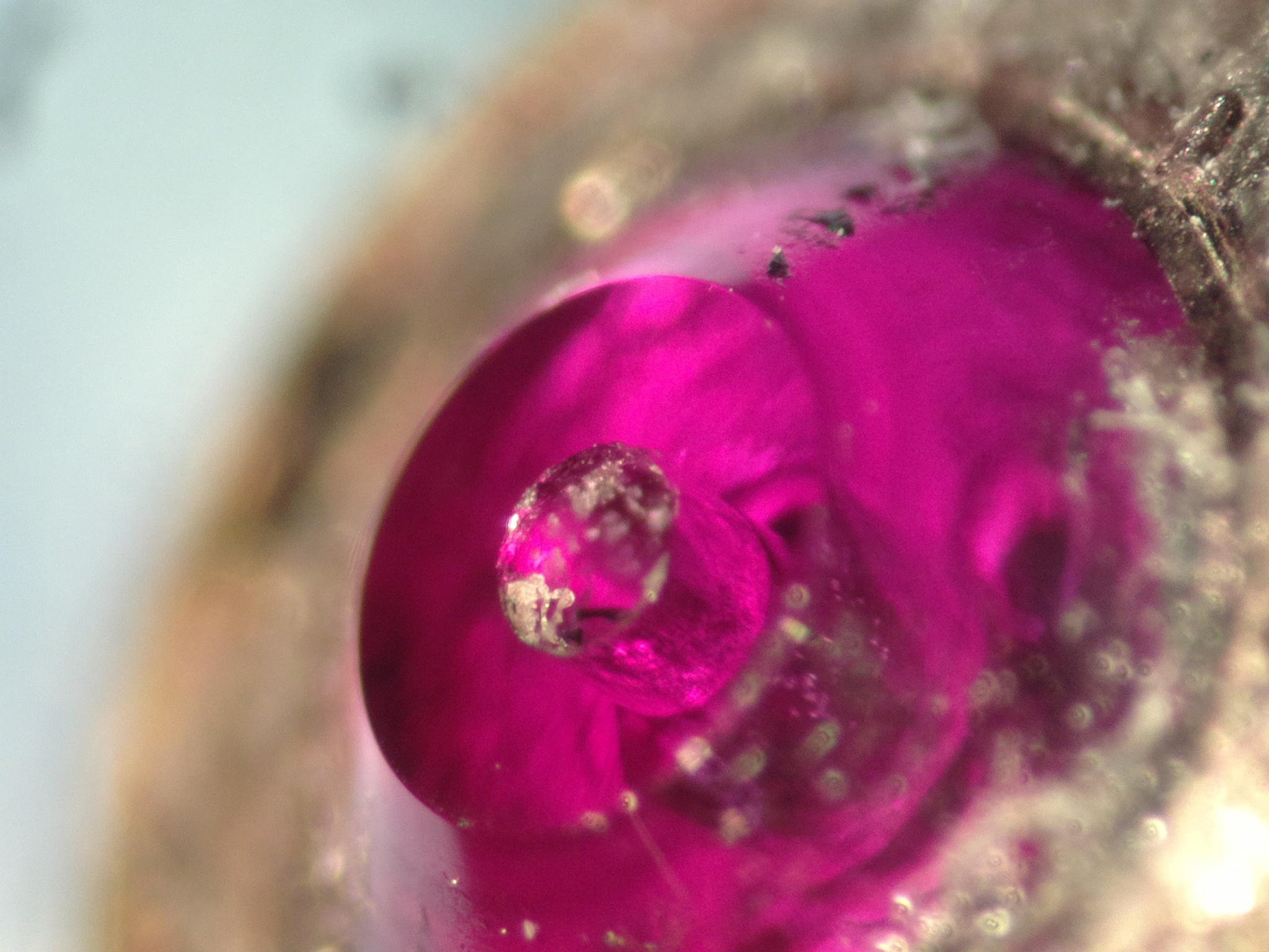

Here is another update by the way.
I came across some diamond lapping film and now I know how to polish ruby :)
After grinding, before polishing:
After polish:
Maybe one should have become a jeweler :lol:
This process is quite difficult and rather time consuming by the way, so it probably only suitable for making prototypes, but I was still surprised how well it worked.

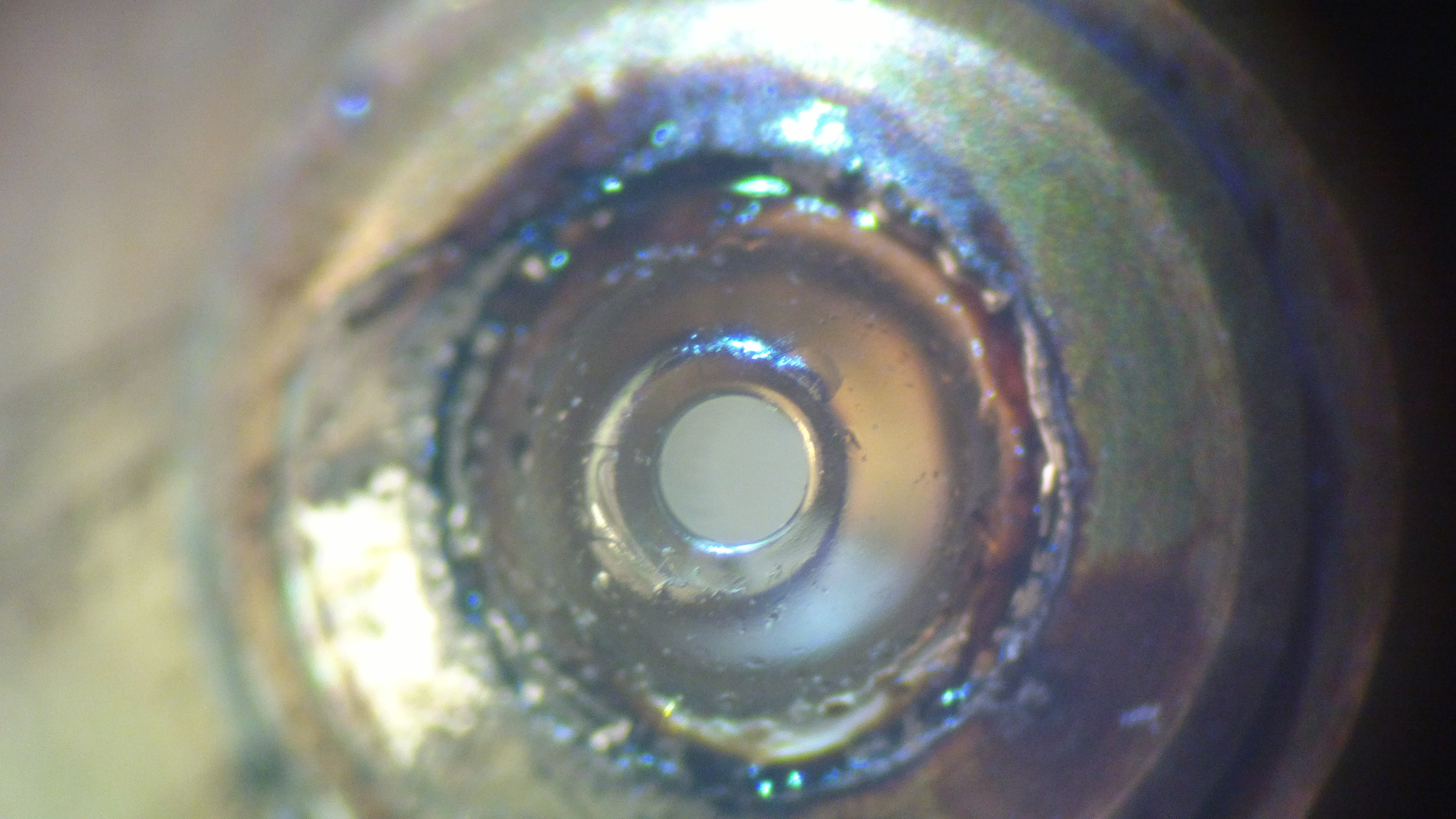

Well, the 0.5 sapphires had way too uneven quality and precision compared to the 0.4 ruby, so it might just be that you got a bad sample.
I did not inspect them that carefully before we had sent out a few samples, but when you see a closeup and compare it to the ruby you get an idea:
As Neotko wrote though, the ruby is a bit more demanding on the feeder to get even top layers though, but I recall that you had side wall quality issues?
